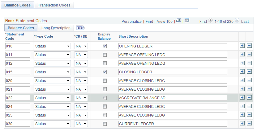

Use the Balance Codes page (BSP_BAL_CODES) to define bank statement code information.
Also select three favorite statement codes for display in online inquiry pages.
Navigation:
This example illustrates the fields and controls on the Bank Statement Codes - Balance Codes page. You can find definitions for the fields and controls later on this page.
Assign balance codes to each balance line and determine how the reconciliation process manages them. Assign a balance code to each balance entry that is received electronically or entered manually.
Field or Control |
Description |
Statement Code |
Enter a three-digit statement code that is to be defined. |
Type Code |
Indicate whether the code is a Status or Summary code. |
CR/DB (credit/debit) |
Indicate whether the code is a CR (credit) or DB (debit), or select NA (not applicable) if this categorization does not apply. |
Display Balance |
Select to indicate that the balance is a favorite balance. The system automatically displays the favorite balances on certain pages, such as the Bank Balance Inquiry page. You can select no more than three bank balances, however, you can change these selections at any time. |
