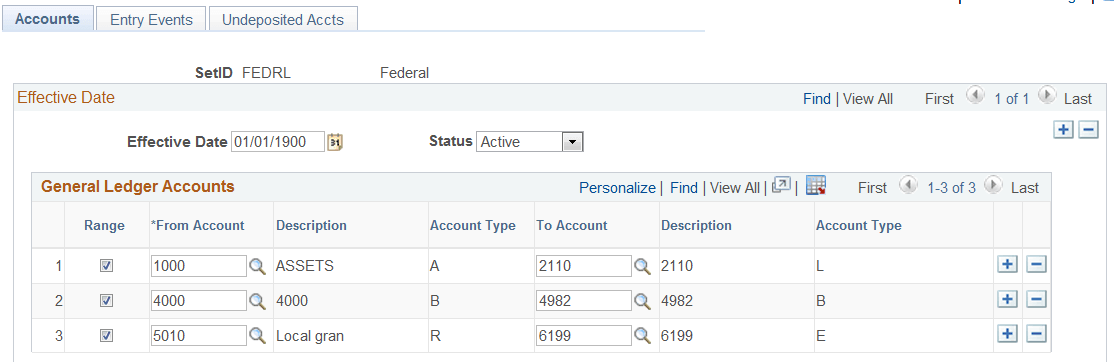

Use the CTA/1220 Report Definition - Accounts page (SF224_SF1220_DEFN1) to add the range of accounts to access and use for this report.
Navigation:
This example illustrates the fields and controls on the CTA/1220 Report Definition - Accounts page.
Field or Control |
Description |
Effective Date |
Displays the system date, which you can change. |
Status |
Select Active. |
Range |
Click to enter a range of values in the From Account and To Account fields to identify the range of accounts to use for this report. If Range is not selected, you can enter a From Account value as a single instance. The page also displays a description and indicates the type of account. For example, A is an asset and L is a liability account. |

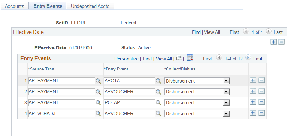

Use the CTA/1220 Report Definition - Entry Events page (SF224_SF1220_DEFN2) to add the source transactions and entry events, and indicate whether this transaction is a collection or disbursement for this report.
Navigation:
This example illustrates the fields and controls on the CTA/1220 Report Definition - Entry Events page.
Field or Control |
Description |
Source Tran (source transaction), Entry Event, and Collect/Disburs (collection/disbursement) |
Select the source transactions, their associated entry event, and whether each transaction is a collection or a disbursement for this report, and save the page. |

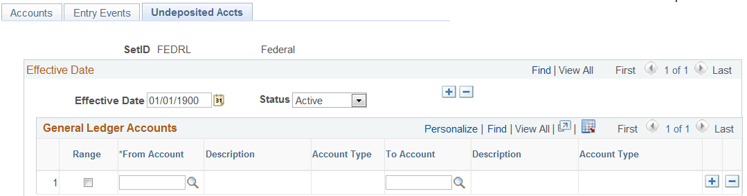

Use the CTA/SF1220 Reports Definition - Undeposited Accts (undeposited accounts) page (SF224_UNDEP_ACC) to identify a range of undeposited accounts to use for reports.
Navigation:
This example illustrates the fields and controls on the CTA/SF1220 Reports Definition - Undeposited Accts page.
Field or Control |
Description |
From Account and To Account |
Enter a range of undeposited accounts to use on the report. Add as many rows as necessary to set up the accounts. Undeposited collections are amounts received by an agency that have yet to be deposited with the U.S. Treasury. Agencies typically receive small amounts of money that they deposit once a week. The agencies book these amounts to an undeposited collections account until they are officially deposited with the U.S. Treasury. Because these amounts are typically entered in the general ledger by manual journal entry, the ALC field on the journal header can be used to identify undeposited amounts on the CTA report. |

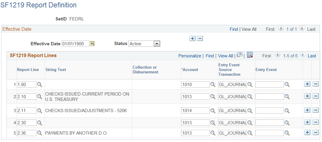

Use the SF1219 Report Definition page (SF1219_DEFN) to set up report lines for each account, its associated entry event source transaction, and associated entry event.
Navigation:
This example illustrates the fields and controls on the SF1219 Report Definition page.
Field or Control |
Description |
Report Line, Account, Entry Event Source Transaction, and Entry Event |
Select the values that you want to apply to this report based on each report line that you add and select. |

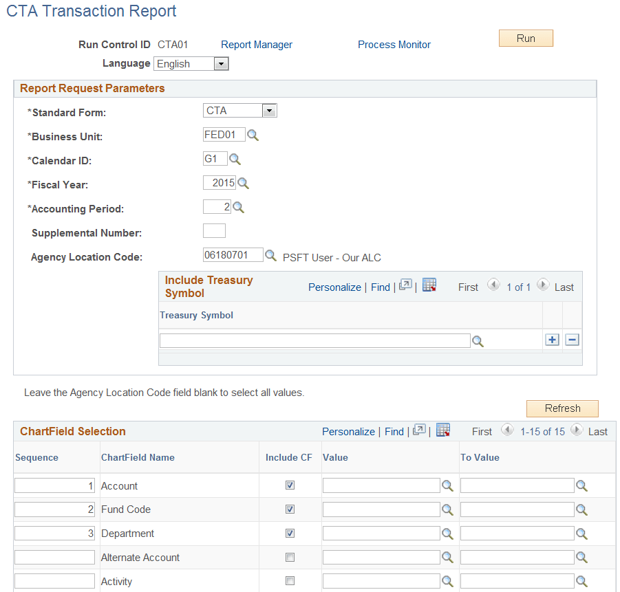

Use the CTA Transaction Report page (RUN_GLS8400) to Run GLS8400 SQR to print detail transactions for SF224 and the Partial SF224, and GLCTATRA SQR to print detail transactions for CTA.
Navigation:
This example illustrates the fields and controls on the CTA Transaction Report page.
This page requires the same information as the CTA/SF1220 Generate page. However, the disbursing officer name is not required and does not appear on the page.

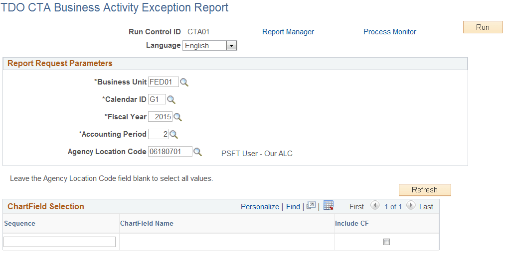

Use the TDO CTA Business Activity Exception Report page (RUN_GLS8410) to Run GLS8410 SQR to print transactions that should not be recorded for a particular ALC, and GLCTAEXP SQR to print transactions that should not be recorded for a TDO ALC for CTA.
Navigation:
This example illustrates the fields and controls on the TDO CTA Business Activity Exception Report page.
