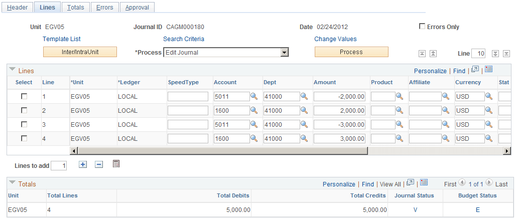

Use the Journal Entry - Lines page (JOURNAL_ENTRY2_IE) to view the Budget Status code field for a specific commitment control journal at the bottom of this page.
This field is available only when the business unit is enabled for commitment control.

To override budget journal errors, Access the Journal Entry - Lines page
This example illustrates the fields and controls on the Journal Entry - Lines page (Budget Status Error). You can find definitions for the fields and controls later on this page.
Click the Budget Status field value to open the GL Journal Exceptions page to override the budget transaction in error and view details about the source transaction.
