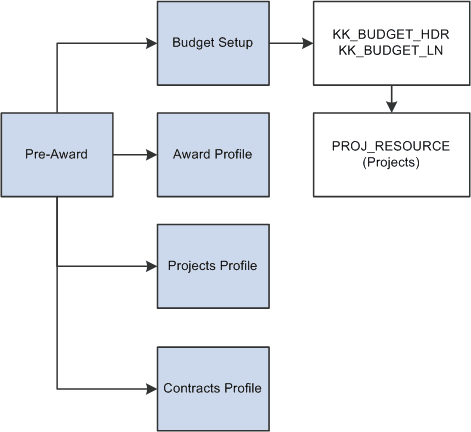

This diagram illustrates the flow of pre-award data to the budget setup, award profile, projects profile, and contracts profile components when the Award Generation process is run:
Through the Award Generation process, PeopleSoft Grants writes the required award information to PeopleSoft Contracts. This process creates a contract, adds a contract line to the contract, associates PeopleSoft Grants projects and activities with the contract line, and creates billing and revenue recognition plans. Due to this integration with PeopleSoft Contracts, you can generate bills and recognize revenue for all transactions that are associated with your sponsored awards.

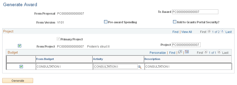

Use the Generate Award page (GM_AWD_SETUP) to generate awards by creating information in the award pages from the proposal pages in PeopleSoft Grants.
Navigation:
This example illustrates the fields and controls on the Generate Award page. You can find definitions for the fields and controls later on this page.
Note: You cannot run the Award Generation process for a proposal until that proposal has a status of Submitted on the Proposal Submission page.
See Submitting Proposals.
The parameters on this page initiate the award administration process by copying information from the proposal pages to the award pages. Employee IDs that are entered for proposal professionals in the pre-award pages are not brought forward in the Award Generation process.
Field or Control |
Description |
Pre-award Spending |
Select to create an award that has pre-award spending. If you are generating an award that was already created for pre-award spending, this field is unavailable. |
To Award |
Enter an award name the first time that you run the Award Generation process. The system creates certain key fields on the first run even though the award records do not yet exist. This field is display-only the second time that you access the page, preventing you from changing the award name. |
Primary Project |
Select if the currently displayed project is the primary project for a proposal. You must also select the From Project check box for the Award Generation process to run. |
From Project |
Select to specify which proposal projects or project budgets should map to the award. |
Included in Pre-award Spending |
The system displays this field only if pre-award spending has been run. It selects this check box automatically if the proposal project was included in the award when the Award Generation process was run with the Pre-award Spending check box selected. |
Generate |
Click to run the Award Generation process. This process creates information in the award pages from the proposal pages. At least one proposal project must be within the proposal that you are moving; if not, the system displays an error message. You must select at least one budget ID within a proposal for every selected project. If you don't, the system displays a warning indicating you must select a budget ID. |
Note: During the generate award process, if the Include in Award Header check box is selected on the Proposal - Resources page, then these resources are passed to the Award page. When the generate award process finishes, the resources appear in the Reporting Role link of the Award page.
