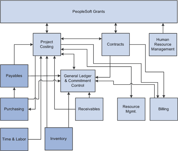

PeopleSoft Grants provides a full-featured grants-administration system that integrates with PeopleSoft Contracts, PeopleSoft Project Costing, PeopleSoft Human Resources, PeopleSoft Time and Labor, PeopleSoft Billing, PeopleSoft General Ledger, PeopleSoft Receivables, PeopleSoft Purchasing, PeopleSoft Inventory, and PeopleSoft Payables. Additionally, you can integrate PeopleSoft Grants with third-party applications.
This diagram illustrates the integration touch points between PeopleSoft Grants and PeopleSoft Human Resource Management, Project Costing, Contracts, Payables, General Ledger, Purchasing, Receivables, Resource Management, Billing, Time and Labor, and Inventory:
Through the award generation process, PeopleSoft Grants writes award information to PeopleSoft Contracts and PeopleSoft Project Costing. For awards that do not have a proposal (blue bird awards), you must enter information directly into PeopleSoft Contracts and PeopleSoft Project Costing.

PeopleSoft Project Costing integrates with both PeopleSoft Billing and PeopleSoft Contracts, so any adjustments, discounts, released retainages, or limits that are created for project-related bills are inherited from corresponding bills and contracts.
PeopleSoft Grants uses the fundamental structure of PeopleSoft Project Costing to write general project information, project activity information, and budget information directly to PeopleSoft Project Costing.

PeopleSoft Project Costing has a built-in integration with PeopleSoft General Ledger through the Journal Generator for both single-sided and double-sided transactions.

The integration of PeopleSoft Receivables with PeopleSoft Project Costing provides project managers with accounts receivable items and revenue-related adjustments. As a result, project managers have information about the progress of a project in terms of the outstanding revenue.
The Receivables Adjustments process (PC_AR_TO_PC) moves data from PeopleSoft Receivables to PeopleSoft Project Costing. The entry type and system functions for revenue-related adjustments in PeopleSoft Receivables are identified, and only those rows are moved to the Project Resource table.

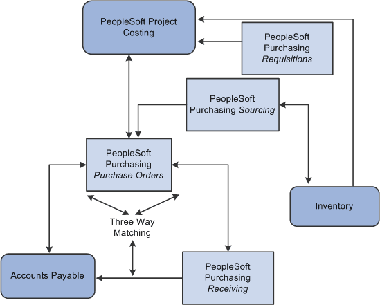

You can enter requisitions into PeopleSoft Purchasing, then pull them into PeopleSoft Project Costing for tracking purposes.
This diagram illustrates how PeopleSoft Project Costing manages the procurement process when it is integrated with PeopleSoft Purchasing, PeopleSoft Payables, and PeopleSoft Inventory.
Data flows both ways between PeopleSoft Project Costing and PeopleSoft Purchasing. You can enter requisition lines directly into PeopleSoft Project Costing and then retrieve them through the Purchasing Requisition Loader and process them into requisitions in PeopleSoft Purchasing. Requisitions that are entered through another means in PeopleSoft Purchasing can be brought into PeopleSoft Project Costing as requisition lines. You can also pull transactions representing materials for which purchase orders have been created into PeopleSoft Project Costing as committed costs.
Use the Purchasing to Project Costing process (PC_PO_TO_PC) to pull requisitions or purchase orders into PeopleSoft Project Costing.
After the sourcing routine in PeopleSoft Purchasing identifies an item on a requisition as an inventory item, you can check purchasing availability directly from PeopleSoft Purchasing or create and place a demand on the Inventory Demand Interface table (IN_DEMAND), where PeopleSoft Inventory picks it up. PeopleSoft Inventory then determines whether the demand can be fulfilled.
If it cannot be fulfilled, the demand is sent back to PeopleSoft Purchasing, and a purchase order is generated or the demand is back-ordered. If the demand can be fulfilled, the requested items are assigned to the project ID that you identify on the demand. The fulfilled demand is then placed by means of inventory costing on the Invoice Accounting Distribution table (CM_ACCTG_LINE), where PeopleSoft Project Costing can pick it up and bring it in as a resource transaction with an analysis type of ACT (actual cost).
Use the Inventory Process Request page to pull fulfilled demands into PeopleSoft Project Costing from PeopleSoft Inventory.
After you create a purchase order in PeopleSoft Purchasing, you can send it to PeopleSoft Payables. When you enter vouchers in PeopleSoft Payables for bills received, they go through a matching process. After the system matches a voucher, it is approved and posted to the AP Accounting Entries table (VCHR_ACCTG_LINE). Vouchers in this table that carry a PC distribution status of N can then be pulled into PeopleSoft Project Costing with a default analysis type of ACT.
Use the Process Request page to run the AP to PC Interface process (PC_AP_TO_PC) and pull approved vouchers into PeopleSoft Project Costing from PeopleSoft Payables.
