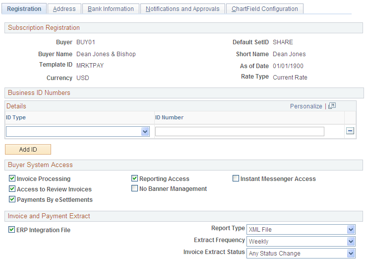

Use the Review Buyer Details - Registration page (EM_BUY_REG) to create or complete the buying entity and define processing preferences.
Navigation:
Select the Create a New Buyer option on the Create New Buyer page.
Click Continue.
Enter a buyer ID and click Add.
Select the Enable an AP Business Unit as an eSettlements Buyer option on the Create New Buyer page.
Click Continue.
Click a Business Unit column link.
This example illustrates the fields and controls on the Review Buyer Details - Registration page (1 of 2). You can find definitions for the fields and controls later on this page.
This example illustrates the fields and controls on the Review Buyer Details - Registration page (2 of 2). You can find definitions for the fields and controls later on this page.
Subscription Registration
Field or Control |
Description |
Default SetID |
Displays the default from the administrator's preferences. The SetID determines tableset processing for the buyer. During buyer creation, the system establishes the required tableset sharing parameters for each buyer, and you can refine these further. |
Buyer Name and Short Name |
Enter a name for the system to use on all pages where buyer ID appears, and enter a shorter name to use on pages where space is limited. Note: These fields populate automatically if you are enabling an existing PeopleSoft Payables business unit. |
Template ID |
Enter the ID for the buyer template associated with the buyer and from which default and control values for buyer registration and transactions originate. |
As of Date |
Enter the date that you register the buyer in the system. Note: This value appears by default from the as of date of the PeopleSoft General Ledger business unit if you are enabling an existing PeopleSoft Payables business unit. |
Currency |
Enter the primary currency for this buyer's transactions. Note: PeopleSoft eSettlements records transactions in both transaction currency and base currency, though each buying entity (buyer) can have only one base currency. |
Rate Type |
Enter a type to use for currency conversion between the transaction and base currencies, and to use as the default on all transactions for the buyer. |
Business ID Numbers
Information in this group box is optional.

Buyer System Access
Field or Control |
Description |
Invoice Processing |
For the Business Service Provider model, select to load invoices into PeopleSoft eSettlements. |
Reporting Access |
For the Business Service Provider model, select to subscribe to PeopleSoft eSettlements system report processing. |
Instant Messenger Access |
Select to enable users to participate in instant messenger chats, which are useful in dispute resolution. Note: Selecting this check box enables access to all the instant messaging suppliers; there is no security for a given provider at the buyer level. However, users with an instant messaging ID from a given provider only have access to that provider's network. For example, if a user only has an ID set up with Sametime Connect, that user cannot view users that have only a Yahoo! Messenger ID. See PeopleTools: PeopleSoft MultiChannel Framework. |
Access to Review Invoices |
For the Business Service Provider model, select to enable buyers to review invoices in various summarized formats. |
No Banner Management |
Select to prevent banners from appearing on each web page. Otherwise, the buyer is presented with advertising banners as defined by the administrator during banner management setup. Banners are available in both models. |
Payments By eSettlements |
For the Business Service Provider model, select to enable payments to be generated through PeopleSoft eSettlements. If not selected, it is implied that payments are made outside PeopleSoft eSettlements, and the External Payments Application Engine process (EM_PAY_XTRNL) thus processes related invoices. This process only closes undisputed invoices that are both Approved and Matched. If this check box is not selected, this buyer is not included in any pay cycles. The External Payments process must be run to indicate payments have been made. This process only closes undisputed invoices that are both Approved and Matched. |
Invoice and Payment Extract
Field or Control |
Description |
ERP Integration File (enterprise resource planning integration file) |
Select to enable invoice and payment information to be extracted for integration with an external financial management system. An invoice extract run control is automatically created and named for the extract frequency selected. |
Report Type |
Specify the file output format of the extract reports by selecting Fixed Format or XML File. |
Extract Frequency |
Select Bi weekly, Daily, Monthly, Weekly, or Yearly to define the interval at which invoices are extracted. |
Invoice Extract Status |
Select Any Status Change, Approved, Matched and Approved, Matched and Pending Approval, Paid, or Pending Approval to define the status of the invoices that the system extracts. |

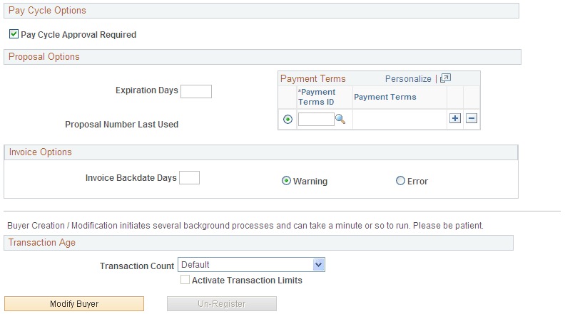

Pay Cycle Options
Field or Control |
Description |
Pay Cycle Approval Required |
Select to require approval by an authorized payment approver in order to approve payments. |
Self-Service Pay Cycle |
For the Business Service Provider model, select to enable the buyer to review vouchers for payment, and reject and approve vouchers for payment before payment creation. If this is selected but Pay Cycle Approval Required is deselected, the buyer is responsible for establishing, maintaining, and processing pay cycles. In such cases, the host administrator must enable access to the pay cycle pages. |
Automated Pay Cycle |
For the Business Service Provider model, select to process payments without buyer intervention such that payments are all, in effect, preapproved. If you select this option, you must also specify the pay cycle frequency to define how often the buyer has payments created. The host administrator references this information when creating pay cycles for the buying entity. |
Pay Cycle Frequency |
For the Business Service Provider model, select the interval at which pay cycles are run and payments created: Bi Weekly, Daily, Monthly, or Weekly. |
Modify Buyer |
Click this button to modify information for an existing buyer. |
Proposal Options
If you are using Dynamic Discounting, complete these fields.
Field or Control |
Description |
Expiration Days |
Enter the number of days beyond the creation date of the proposal or offer for the expiration date of the proposal or offer. For example: a proposal is created on August 13, 2009 and the Expiration Days parameter is set to 7 days, 7 days will be added to the creation date and the proposal expiration date will be set to August 20, 2009. These dates can later be overridden by the supplier or buyer if required. |
Proposal Number Last Used |
Displays the last proposal number used. |
Payment Terms ID |
Select the payment terms to default into a new proposal or offer. You can add as many payment terms as needed to the grid, but you can only select one to default to the proposal. |
Create a New Buyer |
Click this button to register the buyer once you complete the subscription, bank, and system access options. This button appears when a new buyer ID is added to the system. Clicking this button or the Modify Buyer button also creates and modifies a corresponding invoice extract run control record based on the data extract selections. |
Unregister Buyer |
Click this button to unregister this buyer. This button is unavailable if an invoice has already been created for the buyer. |
Invoice Options
Field or Control |
Description |
Invoice Backdate Days |
Enter the number of invoice backdate days. The buyer can establish the number of days an invoice date can be back dated. Note: In Review Invoice search page, if the datetime stamp the invoice is entered minus the invoice date of the invoice is greater than the Invoice Backdate Days, the invoice row in the search list will be shown with an icon to the right of the Invoice Date. The icon indicates that at the time the invoice was entered, the invoice date exceeds the Invoice Backdate Days field and hence the invoice date needs to be reviewed. Click on the icon to open a secondary page that displays the current Invoice Date, the Date the invoice was entered and the Backdate date. |
Warning |
Select this option to trigger a warning message at self service invoice entry to the Supplier. If the result of the (current system date minus entered invoice date) calculation exceeds the number of days entered in Invoice Backdate Days field, then a message will be displayed indicating that the invoice date entered exceeds the acceptable date range. The invoice can be still saved. |
Error |
Select this option to trigger an error message at self service invoice entry to the Supplier. If the result of the (current system date minus entered invoice date) calculation exceeds the number of days entered in Invoice Backdate Days field, an error message will be displayed and the user will be prevented from saving the self service invoice. The supplier will need to modify the invoice date entered. |
Transaction Age
Field or Control |
Description |
Transaction Count |
User can select the default count or specify a new transaction count. |
Activate Transaction Limits |
Select the check box to activate transaction limits. |
Transaction Age |
Enter the age of the transactions to be selected in Years, Months and Days. |

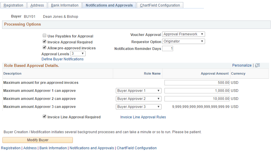

Use the Review Buyer Details - Notifications and Approvals page (EM_BUY_APPR_RULES) to specify matching and approval rules requirements.
Inbound transactions reference the agreement information to determine approval processing.
Navigation:
This example illustrates the fields and controls on the Review Buyer Details - Notifications and Approvals page. You can find definitions for the fields and controls later on this page.
Processing Options
Field or Control |
Description |
Use Payables for Approval |
Select to follow the Payables Approval process for header level approval. All the configuration options and parameters related to the eSettlements approval will be hidden. |
Invoice Approval Required |
Select to require approval for invoices. If selected, you must also define approval limits and approver roles at each level. |
Number of Approval Levels |
Select 1, 2, or 3 to define your approval hierarchy. Leave blank if no invoice approval is required. |
Allow pre-approved invoices |
Select to permit invoices less than a maximum monetary amount to bypass the approval step. If selected, add a value in the Maximum amount for pre-approved invoices field. |
Notification Reminder Days |
Enter the number of days to elapse before approval email notification reminders are sent. |
Define Buyer Notifications |
Click this link to establish or modify email notifications for the buyer. This link is enabled after a new buyer is created. |
Maximum amount for pre-approved invoices |
Enter the highest amount an invoice can be before it requires approval in the Approval Amount column field. |
Maximum amount Approver 1 can approve |
Select an accounting-oriented approver role, for header approvals in the Role Name column field. In the Approval Amount column field, enter the maximum amount that the first approver can approve. Additional levels appear corresponding to your Number of Approval Levels selection. Saving the page automatically sets the maximum approval amount at the last approval level. Note: Only roles assigned to the buyer accountant and buyer user role types are available for selection. |
Invoice Line Approval Required |
Select to require line-level approval for invoices. Note: The Invoice Approval Required check box must be selected to utilize invoice line approvals. |
Invoice Line Approval Rules |
Click this link to define fields and role names that govern invoice line approval and notifications. |
Matching Process

Use the Buyer Information - Invoice Line Approval Rules page (EM_BUY_LINE_APPR) to define invoice line approval rules by selecting fields to route invoice lines for approval and corresponding responsible operational roles.
Navigation:
Click the Invoice Line Approval Rules link on the Review Buyer Details - Notifications and Approvals page.

Field |
Select a field to define which invoices the system routes for line-level approval. The system routes invoices that have values in these fields to the appropriate line-level approvers. |
Role Name |
Select an operational role to receive invoices that contain values in the corresponding Field that you selected. |
