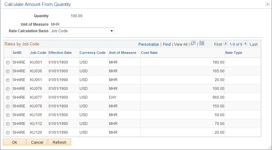

| Calculate Amount From Quantity Page | PC_BUD_CALC_RT_SEC | Select a rate by employee ID, project role, or job code to use to calculate a budget row amount. |

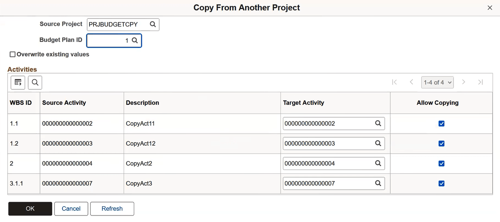

| PC_BUDGET_COPY_SEC | Copy budget items from another project to the current one. |

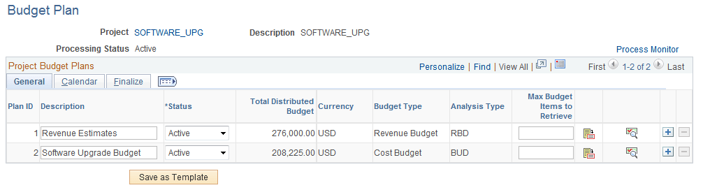

Use the Budget Plan page (PC_BUD_GENERAL) to create and view all budget plans associated with a project.
Navigation:
This example illustrates the fields and controls on the Budget Plan page. You can find definitions for the fields and controls later on this page.
You can create one or more budget plans for a project; however, you can finalize only two plans on this page—one cost budget and one revenue budget.
| Field or Control | Description |
| Project | Click the project ID link to access the Project Definitions - General Information page for the project in a new browser window. Close the new browser window to return to the Budget Detail page. |
General
Select the General tab.
| Plan ID | Enter the identifier for this budget plan for the project. You cannot edit this field after the plan is saved. |
| Status | Select a status of Active or Inactive for each budget plan. Only two budget plans can be active at any given time—one cost budget plan and one revenue budget plan. You can finalize only active plans. Note: Changing the status of a budget plan does not trigger a process to load the budget rows into the Project Transaction table. The Project Transaction table contains budget rows from the most recent finalized budget plan, regardless of the budget plan status. |
| Total Distributed Budget and Currency | Displays the sum of the budget items that is distributed down to the period level. |
| Currency | Select the budget plan currency. The default value is based on the currency code defined on the Project Costing Definition page. You can override the default value at the budget plan level. You can modify the currency only if no detail budget rows exist for the budget plan. |
| Budget Type | Select the type of budget to create. Available options are: Cost: Select to create a cost budget to track actual costs associated with the project. Revenue: Select to create a revenue budget for projected revenue. You can modify the budget type only if no detail budget rows exist for the budget plan. |
| Analysis Type | Enter the cost or revenue analysis type for the system to use to select transaction rows from the Project Transaction table to summarize and use on project analysis pages. Available analysis types are based on the analysis groups defined in the Cost Budget field (AN_GRP_ACTV_BUD) and Revenue Budget field (PC_REV_BUD_AN_GRP) in the Analysis Group Options group box on the Project Costing Definition page. You can change the analysis type only if no detail budget rows exist for the budget plan. Note: If Commitment Control is required, you cannot finalize another plan of the same budget type (cost or revenue) and analysis type. |
| Max Budget Items to Retrieve | Enter a value to control how many budget items are initially displayed on the Budget Detail Page. A value of 0 (zero) displays all budget items, which is recommended unless the you are experiencing performance issues. This field can be used to improve the time required to initially display the page for budget plans that may have many activities or budget items. A value can default into this field if it is defined on the Installation Options - Project Costing Page. |
     | Click the Budget Detail icon to access the Budget Detail page for the corresponding plan. |
     | Click the Budget versus Actual icon to access the Budget versus Actual page. |
| Get Plan | Click to use the Distribute Costs to Budgets process to create budget details based on the amounts on the Resources by Activity page in PeopleSoft Program Management. This button appears only if you use PeopleSoft Program Management |
| Refresh Analytics | Click to trigger the Refresh Budget Summary process to run in the background and update the Summary Budget Data table so that the latest budget information is available for reports and analytics before the budget is finalized. This button appears only if you use PeopleSoft Program Management. Note: The Refresh Budget Summary process runs automatically during the Project Costing budget finalization process. |

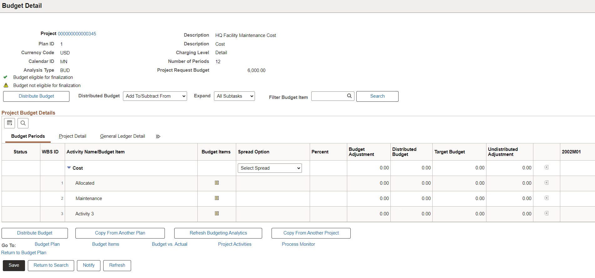

Use the Budget Detail page (PC_BUD_DETAIL) to enter a high-level budget adjustment for the project and then distribute the budget adjustment down the WBS to costing activities.
Navigation:
- Click the Budget Detail icon on the Budget Plan page.
If all budget adjustments are distributed across budget items, use this page to distribute the budget adjustments evenly across budget periods.
Note: If the project was created using the Fluid Project Request, then the approved budgeted amount is shown at the top of the page as Project Request Budget.
This example illustrates the fields and controls on the Budget Detail page (1 of 2). You can find definitions for the fields and controls later on this page.
            This example illustrates the fields and controls on the Budget Detail page (2 of 2). You can find definitions for the fields and controls later on this page.
| Distribute Budget | Click to perform the action in the Distributed Budget field (Add To/Subtract From or Replace) to calculate the Target Budget field. |
| Distributed Budget | Add To/Subtract From: Select to add (if you enter a positive budget adjustment) or subtract (if you enter a negative budget adjustment) the budget adjustment amount to the distributed budget to calculate the target budget. This value is the default when you enter the page. Add To/Subtract From is the only valid option if Commitment Control is enabled for the business unit and the selected budget plan is already finalized, because you cannot modify existing budget rows. With Commitment Control, you can only add additional adjustment rows by using the Budget Items page. Replace: Select for the budget adjustment amount to replace the entire target budget amount when you click the Distribute Budget button. The distributed budget amount, which is the amount that has already been distributed down to the period level, changes to zero for all affected rows. |
| Expand | Select a specific WBS level for activities in that level to appear in the Project Budget Details grid. When you first enter the page, the WBS is expanded to the activity costing level and all budget item rows that are associated with activities are collapsed. Available options are: All Subtasks: Select for all activities and budget items associated with those activities to appear in the grid. Level 1 through Level 9: Select for costing activities in a specific WBS level to appear in the grid. Click the Expand icon (the + symbol) or the Collapse icon (the − symbol) to collapse or expand individual rows. |
| Filter Budget Item | Select a budget item and click Search for only the selected budget item to appear in the grid. This field applies only when the WBS level is expanded to display budget items. The available budget items are based on the budget items that are associated with activities on the project. Note: If you use this option, activity totals can appear out of balance if they include budget items that do not appear in the grid. |
| Copy From Another Plan | Click to access the Copy From Another Plan page to copy budget items from a previous, saved version of a budget plan. You can copy from another plan only if this budget plan is not finalized. |
| Copy From Another Project | Click to access the Copy From Another Project page to copy budget items from the budget plan of another project. You can copy from another project only if this budget plan is not finalized. |
| Budget Plan | Click to access the Budget Plan page. |
| Budget Items | Click the Budget Items link at the bottom of the page to access the Budget Items component (PC_BUD_ITEMS) in a new browser window to create new budget items. |
| Budget vs. Actual | Click to access the Budget vs. Actual page for the project. |

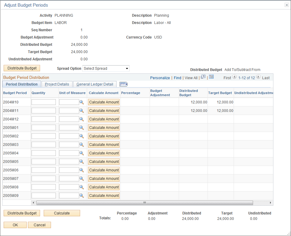

| Undistributed Adjustment | The amount of the budget that has not been distributed to periods. |
| Even Spread | Click to spread the amount in the Undistributed Adjustment column evenly across all budget periods and update the Undistributed Adjustment amount. |

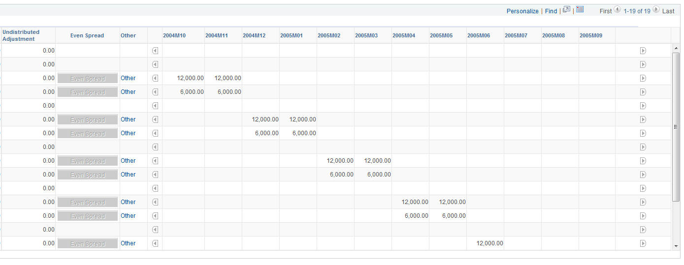

| Other | Click to access the Project Budget Periods - Adjust Budget Periods page and distribute budget adjustments to the period level. |
| <Budget Period> | View the budget distribution amount for each budget period. The budget period columns are based on the calendar ID, start date, and number of periods specified for the budget plan. The system determines the number of periods to display based on the calendar periods per year. If the number of periods per year is less than or equal to 26 then the system displays the number of periods in the calendar year. If the number of periods per year is 52, the system displays 26 periods. For any other number of periods per year, the system displays 15 periods. Use the horizontal scroll buttons to view additional budget periods. The horizontal scroll buttons appear only when the number of periods exceed the space on the page. |

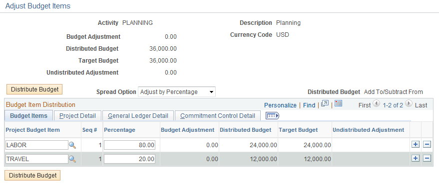

Use the Project Budget Items - Adjust Budget Items page (PC_BUD_ITM_DST_SEC) to distribute budget amounts to budget items for costing activities.
Navigation:
Click the Budget Items icon on the Budget Detail page.
This example illustrates the fields and controls on the Project Budget Items - Adjust Budget Items page. You can find definitions for the fields and controls later on this page.
If Commitment Control is enabled and the selected budget plan is already finalized, you can modify budget amounts only by inserting additional adjustment rows on this page.
The Clear Values spread option is the only method that you can use on this page to adjust budget amounts that have been distributed down to the period level.
| Spread Option | Select an option to spread the budget adjustment amount to budget items. The appearance of the columns on this page is based on your selection. Available values are: Adjust by Amount Adjust by Percentage Clear Values Even Spread Percentage Spread These options are discussed in more detail later in this section. |
| Distribute Budget | Click the Distribute Budget button to apply the selected spread option to calculate the budget adjustments. The system adds the budget adjustment and the distributed budget to arrive at the target budget. |
| OK | Click to return to the Budget Detail page and distribute the budget adjustments to periods. Important! When you return to the Budget Detail page, click Save to update the database with the changes that you made on the Budget Items page. |
| Cancel | Click to clear distributions from this page and return to the Budget Detail page. |
Budget Items
Select the Budget Items tab to enter budget adjustments and view the distributed, total, and undistributed budgets for each budget item on the activity.
| Project Budget Item | Enter project budget items to which you want to distribute budget amounts for this activity. |
| Seq # (sequence number) | Displays the sequence number that increments by one each time that you enter a specific budget item for this activity. |

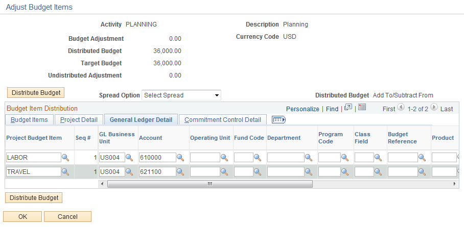

General Ledger Detail
Select the General Ledger Detail tab to modify the GL business unit and other GL-related ChartField values. You can budget to a finer level of detail by entering ChartField values on the budget rows. This example shows the PLANNING activity with two labor budget items—one for department 153000 and one for department 154000:
This example illustrates the fields and controls on the Example of setting up specific ChartField values on the Project Budget Items - Adjust Budget Items page. You can find definitions for the fields and controls later on this page.
To budget down to the ChartField level:
- On the Project Budget Items - Adjust Budget Items page, create as many budget item rows as needed for the activity.
- On the General Ledger Detail tab of the Project Budget Items - Adjust Budget Items page, enter the specific ChartField combinations for each budget item.
- Distribute each budget item separately.
Note: Multiple budget items do not roll up to a single budget item on the Budget Detail page.
Combination editing is not available through project budget creation in Project Costing.

Adjust by Percentage Spread Option
Select the Adjust by Percentage spread option on the Project Budget Items - Adjust Budget Items page to adjust particular budget items by percentage. The fields in the Percentage column become editable.
The system calculates the budget adjustment for each budget item as the (distributed budget) × (percentage).
A value in the Distributed Budget column for a budget item indicates that the amount is distributed down to the period level. If an activity has budget items with both distributed budget amounts and budget adjustment amounts, the system ignores the budget adjustments.
In this example, assume that the PLANNING activity has a 1,000 USD budget adjustment and a 36,000 USD distributed budget:
This example illustrates the fields and controls on the Example of adjusting by percentage on the Project Budget Items - Adjust Budget Items page. You can find definitions for the fields and controls later on this page.
The system disregards the existing budget adjustment amount when performing an adjustment by percentage on this page. In this example, the system calculates a new budget adjustment amount for the LABOR budget item of (10 percent) × (24,000 USD) = (2,400 USD), and a new TRAVEL budget adjustment of (15 percent) × (12,000 USD) = (1,800 USD).
Note: You cannot copy budget item distribution percentages from one activity to another, or from one budget item to another.

Use the Project Budget Periods - Adjust Budget Periods page (PC_BUD_PER_DST_SEC) to distribute budget amounts to budget periods for costing activities and budget items.
Navigation:
Click the Other link on the Budget Detail page.
This example illustrates the fields and controls on the Project Budget Periods - Adjust Budget Periods page. You can find definitions for the fields and controls later on this page.
This page contains additional spread methods that you can use to adjust budgets to the period level. Budget amounts that you distribute on this page roll up to the budget item, activity, and project level.
| Spread Option | Select an option to spread the budget adjustment amount to periods. You must select a spread option before you can take action on this page. If you change the spread option, the system clears any existing amounts in the Budget Adjustment field. |
| Budget Period | Lists the budget periods in the budget plan. |
| Quantity | Enter a quantity that the system uses to calculate budget adjustments by period for labor resources based on a quantity x rate calculation. |
| Unit of Measure | Enter the unit of measure that the system uses with the quantity to calculate budget adjustments by period for labor. The unit of measure must have conversion data defined from the unit of measure on the Budget Periods page to the unit of measure that appears on the Calculate Amount From Quantity page. |
| Calculate Amount | Click to access the Calculate Amount From Quantity page to select a rate calculation basis of Employee ID, Job Code, or Project Role. This button appears only if the budget item resource class is Labor or blank. |
Use the Calculate Amount From Quantity page (PC_BUD_CALC_RT_SEC) to select a rate by employee ID, project role, or job code to use to calculate a budget row amount.
Navigation:
Click the Calculate Amount button on the Project Budget Periods - Adjust Budget Periods page.
The Calculate Amount From Quantity page appears when you select the Adjust by Amount spread option on the Project Budget Periods - Adjust Budget Periods page, enter the quantity and unit of measure, and click the Calculate Amount button.
This example illustrates the fields and controls on the Calculate Amount From Quantity page. You can find definitions for the fields and controls later on this page.
| Rate Calculation Basis | Select one of these options: Employee ID: Select for a list of employee cost data to appear in the Rates by Employee ID grid. Job Code: Select for a list of job code cost data to appear in the Rates by Job Code grid. Project Role: Select for a list of project role cost data to appear in the Rates by Project Role grid. After you select the rate calculation basis, the list of detailed rate rows appears in the grid. Select the row that contains the desired rate for the system to use to calculate budget adjustments by period for labor. |
| Rate Type | This field appears only for rates that require multicurrency conversion. If the rate that you select on the Calculate Amount From Quantity page uses a different currency code than the budget plan currency code, enter the rate type that the system uses to convert the rate to the budget plan currency code. |
| OK | Click to return to the Project Budget Periods - Adjust Budget Periods page. Any amount that exists in the Distributed Budget field for the period will be overridden with the new calculated amount. |
Adjust by Amount Spread Option
Select Adjust by Amount in the Spread Option field on the Project Budget Periods - Adjust Budget Periods page to spread the budget adjustment for the budget item to periods manually by entering the desired amounts, or adjust a particular periods directly. Fields in the Budget Adjustment column become editable.
To use the Adjust by Amount option, the undistributed adjustment amount that appears in the Budget Periods grid on the Budget Detail page must equal zero. You can change the undistributed adjustment amount in the Budget Periods grid to zero and only distribute the budget adjustments by the amount that appears in the Period Distribution grid on the Project Budget Periods - Adjust Budget Periods page. Alternatively, you can evenly spread the undistributed adjustment amount across budget periods and also distribute the budget adjustments by the amount that appears in the Period Distribution grid.
The budget amount calculation is based on the selected distributed budget option:
- Add To/Subtract From: Direct entry of budget adjustment amounts against a specific budget period. Upon distributing these budget adjustments, this amount is added to or subtracted from any existing distributed budget adjustment for that specific period.
- Replace: Direct entry of budget adjustment amounts against a specific budget period. Upon distributing these budget adjustments, this amount replaces any existing distributed budget adjustment for that specific period.
Select the Adjust by Percentage option on the Project Budget Periods - Adjust Budget Periods page to adjust particular budget periods by percentage directly. The fields in the Percentage column become editable.
- Add To/Subtract From: (Budget adjustment of period) × (Percentage entered for budget period) = (Distributed budget at period level). - Note: Any existing distributed budget amounts are added to this calculation.
- Replace: (Budget adjustment of period) × (Percentage entered for budget period) = (Distributed budget at period level). - Note: Any existing distributed budget amounts are overridden with this calculation.
Even Spread Option
Select the Even Spread option on the Project Budget Periods - Adjust Budget Periods page to spread the budget adjustment evenly across the budget periods for the selected costing activity and budget item.
- Add To/Subtract From: (Budget adjustment at item level) ÷ (Number of periods) = (Distributed budget at period level). - Note: Any existing distributed budget amounts are added to this calculation.
- Replace: (Budget adjustment at item level) ÷ (Number of periods) = (Distributed budget at period level). - Note: Any existing distributed budget amounts are overridden with this calculation.
Select the Percentage Spread option on the Project Budget Periods - Adjust Budget Periods page to spread the budget adjustment amount for the activity to budget items based on the percentages that you enter. When you select this option the fields in the Percentage column become editable.
- Add To/Subtract From: (Budget adjustment at item level) × (Percentage entered for each budget period) = (Distributed budget at period level). - Note: Any existing distributed budget amounts are added to this calculation.
- Replace: (Budget adjustment at item level) × (Percentage entered for each budget period) = (Distributed budget at period level). - Note: Any existing distributed budget amounts are overridden with this calculation.

Use the Copy From Another Project page (PC_BUDGET_COPY_SEC) to copy budget items from the budget plan of another project to the current one.
Navigation:
Click Copy From Another Project on the Budget Detail page if the budget plan is not finalized.
This example illustrates the fields and controls on the Copy From Another Project page
            To copy budget items from the budget plan of another project:
- Save the existing plan before you copy budget items from the budget plan of another project.
- Select a source project to copy from. - Note: If the project was created using copy functionality in the Fluid Project Request, then the source project will default to the source project used to create the project request, and changes can be made.
- Select a budget plan from the source project.
- Select Overwrite existing values to delete existing budget rows in the current plan before copying new budget items into the plan. - Deselect this option to append new budget items to the existing budget items in the project.
- The activities grid is populated with source activities on selection of budget plan id for the source project. - If the target activity matches the source activity then it will be populated and the Allow Copying field is checked by default.
If Target Activity is not auto-populated then select an unused activity in the prompt. A target activity must be selected to perform the copy. De-select the Allow Copying Check-box to prevent the source activity's budget from being copied.
Access the Budget Plan page.
Click the Finalize button on the Finalize tab of the Budget Plan page to finalize a project budget plan. Only active budget plans can be finalized. All other plans of the same type (cost or revenue) for the same project must be inactive. Only one budget plan of each type can be finalized per project. You can adjust budget plans and refinalize the budget.
