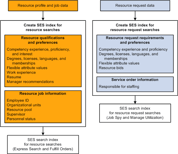

Resource Matching uses the Search Framework to quickly calculate qualification and preference scores for each resource. The Search Framework enables PeopleSoft applications to execute free-text data searches.
The Search Framework indexing application transforms those files into an index—a Search Framework collection—that is used for searching, as shown in this diagram:
See Setting Up and Maintaining the Search Framework and Resource Matching Cache Tables.

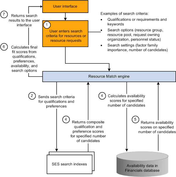

This diagram shows the high level process steps that occur when you search for resources or resource requests by using Resource Matching:
