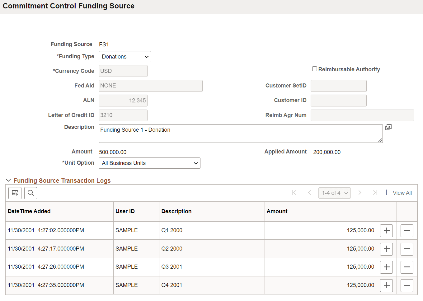

KK_FUND_SOURCE |
Identify funding sources and enter funding amounts. |

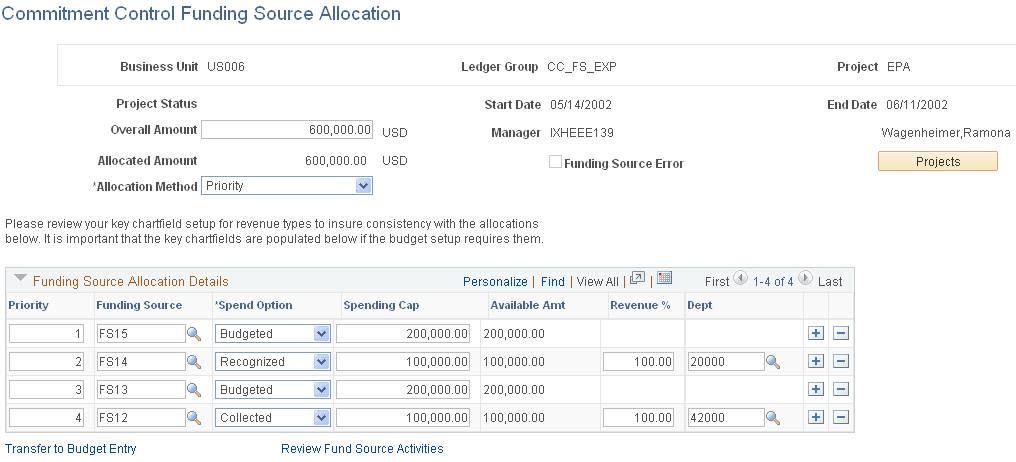

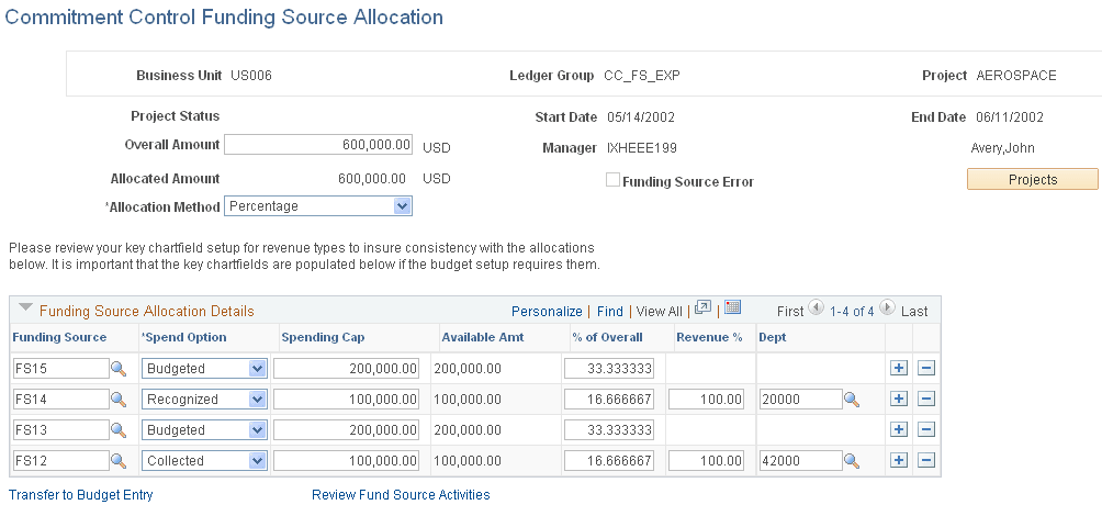

KK_FS_ALLOCATION |
Allocate funding source amounts to a budget and identify spending options. |

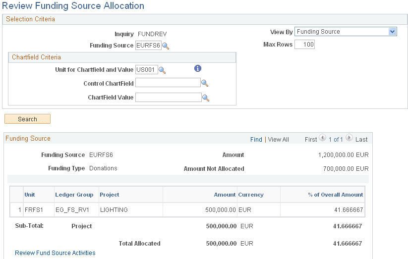

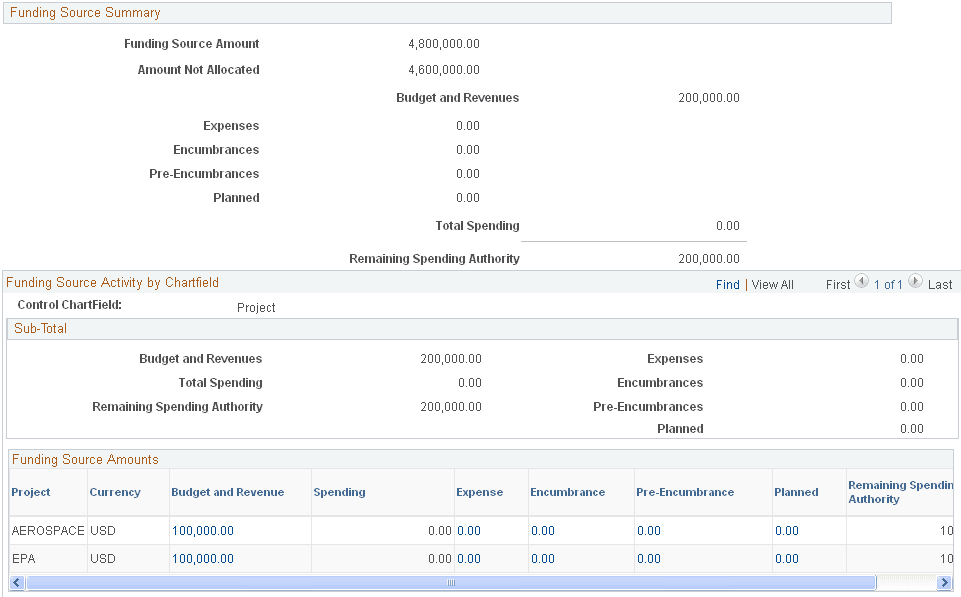

KK_FS_INQA |
View the allocation of funding sources for expenditure budgets (control ChartFields) and recognized and collected revenue by funding source or control ChartField. |

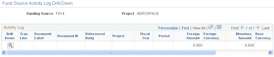

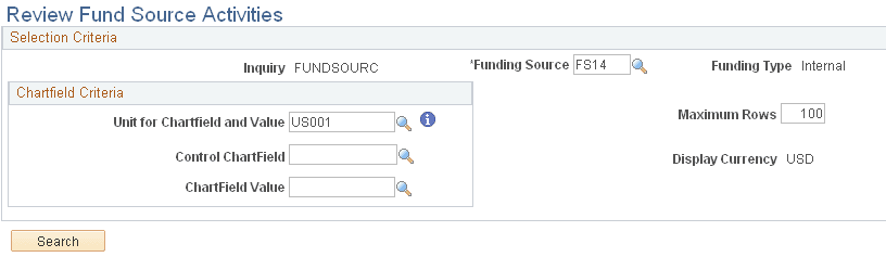

KK_FS_ALOG_INQ |
View spending activities at control ChartField and ChartField value for a specific funding source. |

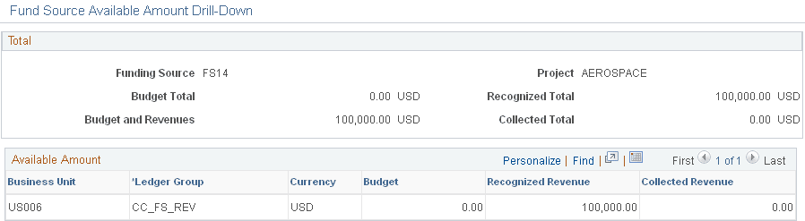

KK_FS_BUDREV_DRL |
Displays the available amount for a funding source by control ChartField, business unit, ledger group by currency for budgeted, recognized, and collected revenue. No further drill down is available from this page. |

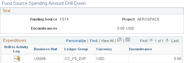

Fund Source Spending Amount Drill-Down Page |
KK_FS_LEDKK_DRL |
Provides progressively detailed information about expenditures and encumbrance by funding source, control ChartField, business unit, ledger group, and currency. |
KK_FS_ALOG_DRL |
Click the Drill Down button in the first column, which accesses the source transaction detail page. |

Funding source inquiry.

Define funding sources on the Commitment Control Funding Source page.
Enter funding source amounts and adjustments on the Funding Source Transaction Logs grid. The page calculates the total funding source amount by aggregating the amounts that you enter on the grid and also displays a running total of the amounts applied using the funding source allocation page.
Define fund sources by all business units or control access to fund source information by defining a funding source by a single or multiple business units that are accessible to selected users of your choosing.

On the Commitment Control Funding Source Allocation page, enter the overall spending amount approved for the budget and allocate funding sources and amounts for each Control ChartField for which you require the use of funding source tracking. Use one of the following methods to allocate funding sources:
Percentage: You can define funding source amounts as a percentage of the overall spending amount, and establish a spending cap amount for each funding source.
Priority: You can choose to allocate and expend against the overall spending amount by priority. Establish a spending cap amount for each funding source.
For example, you decide that you want to first spend against FS5 (fund source 5) and then by FS1 (funding source 1), and so on according to the spending priority that you define.
The page automatically sums up the spending caps and puts the sum in the Allocated Amount field. For both methods, the allocated amount has to be equal to the overall spending amount for the budget processor to be able to use the allocation. If the allocated amount is greater than the overall spending amount, you cannot save the page. But if the allocated amount is less than the overall spending amount, you can save the page, but the budget processor is not able to use this allocation because the Funding Source Error flag is activated in such cases.
Note: The percentage and priority methods are mutually exclusive and the two methods cannot be used in combination for the same funding source allocation.
You can save a funding source allocation for which you have not yet fully completed the allocation; however, the system will not process expenditures against the funding source allocation until you have reopened the Commitment Control Funding Source Allocation page and fully allocated the overall spending amount that you assigned to the funding source allocation. You cannot override a partial allocation or a zero priority number error generated by Budget Processor.

Use the Commitment Control Funding Source page (KK_FUND_SOURCE) to identify funding sources and enter funding amounts.
Navigation:
This example illustrates the fields and controls on the Commitment Control Funding Source page. You can find definitions for the fields and controls later on this page.
Field or Control |
Description |
Funding Type |
Select one of the following values: Bond, Donations, Federal, Internal, Local, or State. These values are descriptive only. |
FS Date, FS Char1, and FS Char2 |
Enter supplemental date and descriptive information. These informational fields are user-defined options and are available only if you activate and name the fields on the Installation Options - Commitment Control page. |
Reimbursable Authority |
Select the check box and enter values in the Customer SetID, Customer ID, and Reimbursable Agr Num (reimbursable agreement number) fields for the reimbursable authority. |
Fed Aid (federal aid) |
Displays the name of the federal aid agency, if appropriate. |
ALN (Assistance Listing Number) |
A number for an assistance program administered by departments and establishments of the Federal government. |
Amount |
Displays the sum of all row amounts that you enter in the Funding Source Transaction Logs grid of this page. |
Applied Amount |
Displays the total amounts allocated from this funding source and applied to various commitment control budgets by using the Commitment Control Funding Source Allocation page. The system displays the applied amount and uses this field to ensure that you do not over allocate the funding source Amount field. |
Unit Options |
The default value for this field is All Business Units, which enables access to this funding source by all business units when you are doing funding source allocation. Select Specific Business Unit to further control access to this funding source by one or more of the business units that you specify in the Business Unit grid that becomes available. You can allocate this funding source only to business units to which you have access. |
When you select Specify Business Unit, use the add or delete buttons to add or delete business units in the Business Unit grid to provide access to funding source when you are doing funding source allocation.
Each row in the Funding Source Transaction Logs grid is additive and not alterable. To adjust the total funding source Amount field, add or delete a row. Add rows as needed by selecting the add button; however, only five fields are displayed at a time. Use the scroll to see additional rows. The Date Time Added and the User ID fields are populated by the system when the row is added. Date Time Added is an informational field.
Enter a description and amount for each row that you add.
Note: Business units, which have prior funding source allocations, cannot be deleted from the funding source page.
Use the Commitment Control Funding Source Allocation page (KK_FS_ALLOCATION) to allocate funding source amounts to a budget and identify spending options.
Navigation:
This example illustrates the fields and controls on the Commitment Control Funding Source Allocation page for priority allocation (1 of 2). You can find definitions for the fields and controls later on this page.
This example illustrates the fields and controls on the Commitment Control Funding Source Allocation page for percentage allocation (2 of 2). You can find definitions for the fields and controls later on this page.
Note: Review your key ChartField setup for revenue types to ensure consistency with the funding source allocations. The key ChartFields must be populated if the budget setup requires them. Funding source allocation is not effective-dated, while the budget definition is. The budget definition can have a row with a secondary key such as department and another row with a secondary key such as program. In such cases, the Allocation page shows both department and program on the revenue rows. Confirm that you have the appropriate secondary key value entered, because the system does not make this determination for you.
To access this page for an existing funding source allocation or to create a new allocation, enter the business unit, the funding source-enabled expenditure ledger group, and the project, or control ChartField, to which you are allocating funding sources.
Field or Control |
Description |
Project Status |
This field is available only if the control ChartField is Project. If you have installed PeopleSoft Project Costing, statuses displayed are Budgeted, Closed, Hold, Open or Proposed. If you have not installed PeopleSoft Project Costing, statuses displayed are Approved, Completed, In Progress, or Proposed. Note: The Project Status field is informational only, as are the Start Date, End Date, and Manager fields. They are available only when the control ChartField is project. |
Overall Amount |
Enter the total amount of the spending cap approved for this allocation. The allocated amount cannot exceed the overall amount. |
Allocated Amount |
The system displays the total amount of funding that you designated in the Funding Source Allocation Details grid for spending by this allocation. Note: When you save the page, the system displays a warning if the allocated amount is less than the overall amounts and selects the Funding Source Error check box. You must fully allocate the funding source overall amount before transactions can be processed for the project, or control ChartField. If the allocated amount is greater than the overall amounts, you cannot save the page. |
Projects |
Click to access the Project General Information page in Project Costing, where you can further configure project attributes. (If the control ChartField is not Project or you do not have Project Costing installed, the link is not available.) |
Funding Source Error |
This is a display-only check box. When you save the page, the system compares the overall amount against the allocated amount. If the allocated amount is less than the overall amount, the system issues a warning and the Funding Source Error check box is selected by the system. The system also issues a warning and selects this error check box when the allocation method is Priority, but some or all rows have zero Priority number. If the Funding Source Error check box is selected by the system, budget checking fails. Note: The system allows you to save the allocation of funds on the Commitment Control Funding Source Allocation page even if the overall amount is not fully allocated. This enables you to close and later access the Commitment Control Funding Source Allocation page to complete the funding source allocation. However, the budget processor prevents spending against a control ChartField that is funding source-enabled but its funding sources are not fully allocated. |
Allocation Method |
You can choose to allocate by:
Priority |
This field becomes available if you choose to allocate and expend against the overall funding source amount by priority by selecting Priority. for the Allocation Method field For example, you decide that you want to first spend against a particular funding source until it is totally expended, and then by another, and so on according to a spending priority that you define. You indicate the funding source spending priority by entering 1 for the funding source with the first priority and then 2, 3, and so on to indicate in descending order the desired priority of funding source availability for spending. Note: Each funding source row must have an unique nonzero priority number, but they do not necessarily have to be in order. For example, you can assign orders of 2, 6, and 9 to three funding sources. You must fully complete the priority order before saving the page or the Funding Source Error check box is selected by the system and you cannot process transactions against this allocation. If you set a priority as zero, the Funding Source Error check box is selected by the system. |
Funding Source |
You define funding source codes and establish their amounts on the Commitment Control Funding Source page. List those here that are to be allocated to this combination of business unit, expenditure ledger group, and control ChartField or project. |
Spend Option |
Select how to make the funding source amount available for spending:
Note: You must enter a budget journal for any budgeted allocation rows. Until you enter and successfully post a budget journal for a budgeted row, the available amount for that row is zero. |
See Understanding Entering and Posting Commitment Control Budget Journals.
Field or Control |
Description |
Spending Cap |
You determine and enter the maximum amount of the funding source that can be spent for this allocation. When you are using the percentage method and enter this amount, the system calculates the % of Overall field amount. However, if you directly enter the % of Overall field amount, the system calculates the spending cap amount. |
Available Amt (available amount) |
The amount of this funding source that is available. The system calculates this value when you save the page.
Note: Until you enter and successfully post a budget journal for a budgeted row, the available amount for that row is zero. The available amount for Recognized and Collected funding sources depends on your having posted the amounts and also depends on the percentage of revenue allowed and the spending cap. |
Field or Control |
Description |
% of Overall |
Percentage of the overall funding source total amount that is funded by this funding source. This field is available when you are using the percentage method. |
Revenue % |
For collected and recognized spending options, you must enter the percentage of the funding source revenue amount that you can spend for this funding source on the project or control ChartField in this allocation, up to the spending cap. At save time, the system checks to ensure that you have not committed more than 100 percent of the funding source revenue amount. |
Department |
This could also be other ChartFields, such as Product, Program, or Fund. Whatever the ChartField, it becomes available when you define additional key ChartFields for the related revenue budget definition. Select values for the additional Key ChartFields to further refine your allocation of funding sources. Note: You must define and use a second Key ChartField in conjunction with the revenue Control ChartField to distinguish the allocation of revenue transactions when the revenue type is recognized or collected for more than one funding source in a funding source allocation. This is because the system disallows the same revenue amount going to different funding sources in an allocation. At save time, the system checks all allocated funding source amounts on the page against the total amount for each funding source to ensure that none of the funding sources are over allocated. |
Field or Control |
Description |
Transfer to Budget Entry |
This link is provided for convenience to enable you to readily create budget journal entries to budget amounts for budgeted funding sources. |
Review Fund Source Activities |
This link is provided for convenience in accessing the Review Fund Source Activities page to enable you to readily gather information about transactions and remaining spending for this funding source allocation. |
Use the Review Funding Source Allocation page (KK_FS_INQA) to view the allocation of funding sources for expenditure budgets (control ChartFields) and recognized and collected revenue by funding source or control ChartField.
Navigation:
This example illustrates the fields and controls on the Review Funding Source Allocation page. You can find definitions for the fields and controls later on this page.
Field or Control |
Description |
Max Rows (maximum rows) |
Limit the number of funding sources returned if the view by option is Funding Source. The value that you enter also limits the number of control ChartFields returned if the view by option selected is Control Chartfield. This feature improves performance if more rows exist than can be retrieved without causing a Timeout warning and the system stops retrieving. The field's default value is 100. |
Unit for Chartfield and Value |
To facilitate selecting values for both the Control Chartfield and Chartfield Value fields, the value of the Unit for Chartfield and Value field becomes by default the business unit that you previously set up as the default for user preferences. This makes available in the prompt lists for control ChartField and values the values that you set up for the default business unit. |
Use the View By field to choose the inquiry perspective that determines how you want to view inquiry results.
View by the Funding Source Inquiry Perspective
From the funding source perspective, you can:
View inquiry results by funding source for all Control ChartFields, and all ChartField values for all funding sources.
To do so, select Funding Source from the view by drop-down menu. If you leave funding source, control ChartField, and ChartField blank, the result includes all funding sources, all control ChartFields, and all ChartField values for which you have funding source allocations set up.
View inquiry results by funding source but limit the results to only a Control ChartField of interest, all its control ChartField values, and all funding sources.
To do so, select Funding Source from the view by drop-down menu. Select a business unit from the prompt for Unit for Chartfield and Value field, select a control ChartField from the prompt, and leave the ChartField Value field blank.
View inquiry results by funding source but limit the results to a specific fund source, control ChartField, and ChartField value.
To do so, select Funding Source from the drop-down menu. Select a business unit from the prompt for the Unit for Chartfield and Value field, select a Control ChartField from the prompt, and select a valid value from the Chartfield Value prompt.
View inquiry results by funding source but limit the results to Control ChartField values of interest and all applicable funding sources.
To do so, select the funding source from the drop-down menu, select a control ChartField, and specify a control ChartField Value while leaving the Funding Source field blank.
View by the Control ChartField Inquiry Perspective
From the control ChartField perspective you can:
View inquiry by Control ChartField for all Control ChartFields, all control ChartField values, and all funding sources.
To do so, select the Control ChartField from the view by drop-down menu and leave the Funding Source, Control Chartfield, and the Chartfield Values fields blank.
View inquiry by Control ChartField for a particular Control ChartField, all values for the Control ChartField, and all funding sources.
To do so, select Control Chartfield from the view by drop-down menu. Select a business unit from the prompt for the Unit for Chartfield and Value field, select a control Chartfield from the prompt, and leave the Chartfield Value field blank. Also, leave the Funding Source field blank.
View inquiry by Control ChartField for a Control ChartField, a particular control ChartField value, and all funding sources.
To do so, select Control Chartfield from the view by drop-down menu. Select a business unit from the prompt for the Unit for Chartfield and Value field, select a control Chartfield from the prompt, and select a valid value from the Chartfield Value field prompt. Leave the Funding Source field blank.
View inquiry by Control ChartField for a Control ChartField, a control ChartField value, and a funding source.
To do so, select Control Chartfield from the view by drop-down menu. Select a funding source. Select a business unit from the prompt for the Unit for Chartfield and Value field. Select a Control Chartfield from the prompt, and select a valid value from the Chartfield Value prompt.
Field or Control |
Description |
Click this link to access the Review Fund Source Activities page. |
Use the Review Fund Source Activities page (KK_FS_ALOG_INQ) to view spending activities at control ChartField and ChartField value for a specific funding source.
Navigation:
You can also click the Review Fund Source Activities link on the Commitment Control Funding Source Allocation page.
Or, you can also click the Review Fund Source Activities link on the Review Fund Source Allocations page.
This example illustrates the fields and controls on the Review Fund Source Activities page (1 of 2). You can find definitions for the fields and controls later on this page.
This example illustrates the fields and controls on the Review Fund Source Activities page (2 of 2). You can find definitions for the fields and controls later on this page.
Field or Control |
Description |
Funding Source Amount |
Displays the defined funding source amount at the time of the inquiry. |
Amount Not Allocated |
Displays the total defined funding source amount less the sum of the allocations across projects, departments, programs, and so on. This amount is displayed without regard to the row-level security access of the user for business unit and ledger group and commitment control security. |
Budget and Revenues |
Click an amount link under this heading for a control ChartField value row to access the Fund Source Available Amount Drill-Down page, which displays the available amount for a funding source by control ChartField, business unit, ledger group (budget) by currency for budgeted expenditures, and recognized and collected revenue. |
Spending |
The displayed amount is the total of all pre-encumbrances, encumbrances, expenses, and planned amounts against this control ChartField for the funding source. |
Expense, Encumbrance, Pre-Encumbrance, and Planned |
Click an amount link under one of these headings for a particular control ChartField value row to access the Fund Source Spending Amount Drill-Down page, which displays the amounts for funding sources by control ChartField, business unit, ledger group (budget), currency for expenditures, planned, pre-encumbrances, and encumbrances. From the Fund Source Spending Amount Drill-Down page you can click the Drill to Activity Log icon to drill down to the Fund Source Activity Log Drill-Down page. The Fund Source Activity Log Drill-Down page enables you to click the Drill Down icon for a particular row in the activity log for a funding source and control ChartField to view the underlying transaction. Note: If an expenditure ledger does not have the Affect Spending Authority option selected for the ledger group, the budget process does not record the spending on the funding source level (LEDGER_KK_FS). The process records spending at the ChartField level (LEDGER_KK) only. Therefore, you might see a zero amount for a spending type when actual transactions exist that already passed budget checking. |
Remaining Spending Authority |
Represents the amount available for future expenditures, encumbrances, pre-encumbrances, and planned. |
Budget and Revenue, Expense, Encumbrance, Pre-encumbrance, and Planned |
Click a linked amount in these columns in the Funding Source by Activity by ChartField section of the Review Fund Source Activities page to access the Fund Source Available Amount Drill-Down page. From this page you can further drill down to the Fund Source Activity Log Drill-Down page. |
To access the Fund Source Spending Amount Drill-Down page, click a linked amount in the expense, encumbrance, pre-encumbrance, or planned columns on the Review Fund Source Activities page. From this page, you can further drill down to the Fund Source Activity Log Drill-Down page.
Use the Fund Source Available Amount Drill-Down page (KK_FS_BUDREV_DRL) to displays the available amount for a funding source by control ChartField, business unit, ledger group by currency for budgeted, recognized, and collected revenue.
Navigation:
Access the Fund Source Available Amount Drill-Down page (click the Amount link under Budget and Revenue on the Review Fund Source Activities page).
This example illustrates the fields and controls on the Fund Source Available Amount Drill-Down page.
This page displays the budget and revenue amounts that are available to the funding source by business unit and ledger group.
Use the Fund Source Spending Amount Drill-Down page (KK_FS_LEDKK_DRL) to provides progressively detailed information about expenditures and encumbrance by funding source, control ChartField, business unit, ledger group, and currency.
Navigation:
Click a linked amount in the expense, encumbrance, pre-encumbrance, or planned columns on the Review Fund Source Activities page to access this page. From this page, you can further drill down to the Fund Source Activity Log Drill-Down page.
This example illustrates the fields and controls on the Fund Source Spending Amount Drill-Down page. You can find definitions for the fields and controls later on this page.
This page displays planned, pre-encumbrance, encumbrance, and expenditure posted against the specified funding source by business unit and ledger group. The page changes to display planned, pre-encumbrance, encumbrance, and expense activity depending on the amount link that you click.

Use the Fund Source Activity Log Drill-Down page (KK_FS_ALOG_DRL) to click the Drill Down button in the first column, which accesses the source transaction detail page.
Navigation:
Click the button in the Drill to Activity Log column.
This example illustrates the fields and controls on the Fund Source Activity Log Drill-Down page. You can find definitions for the fields and controls later on this page.
Use this page to view for the funding source the transaction lines, their amounts, and their associated documents that are referenced to the affected budget for the affected fiscal year and period.
Field or Control |
Description |
Click to access the document for the particular transaction line. |
