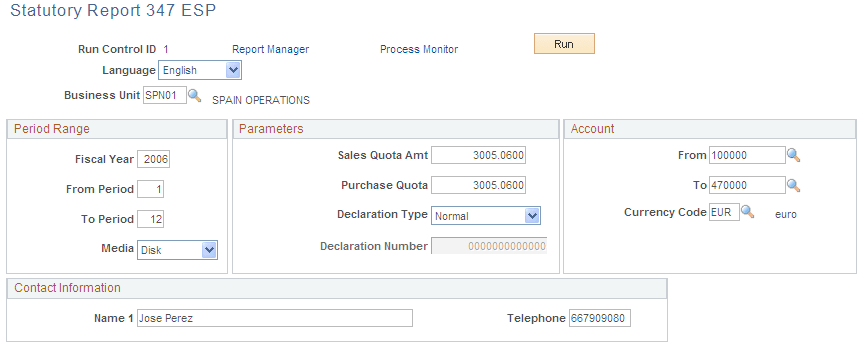

Creates a file consisting of a list of domestic vendors and customers with whom your company conducted transactions greater than a specified value for the Spanish authorities. A company has to declare transactions larger than 3.005,06 Euros. |
Use the Statutory Report 347 ESP page (RUN_LC_CNTL) to creates a file consisting of a list of domestic vendors and customers with whom your company conducted transactions greater than a specified value for the Spanish authorities.
Navigation:
This example illustrates the fields and controls on the Statutory Report 347 ESP page. You can find definitions for the fields and controls later on this page.
Field or Control |
Description |
Business Unit |
Select the appropriate business unit that contains the transactions required for this report. |
Fiscal Year |
Select the fiscal year that corresponds to the Declaration Fiscal Year of the report. |
From Period and To Period |
Select a beginning and ending period to apply to the transactions for this report. |
Media |
Select the type of media for delivering this report: Disk, Tape, or Electronic Transmission. |
Sales Quota Amt (sales quota amount) |
Specify a minimum amount. The file includes a list of customers with whom the selected business unit conducts transactions greater than this value. |
Purchase Quota |
Specify a minimum amount. The file includes a list of vendors with whom the selected business unit conducts transactions greater than this value. |
Declaration Type |
Select one of the following:
From and To |
Enter account numbers that apply to the report's transactions. |
Currency Code |
Enter the currency for the submitted amount. |
Contact Information |
Enter one or more names and telephone numbers for the individuals in your organization responsible for submitting the report. |

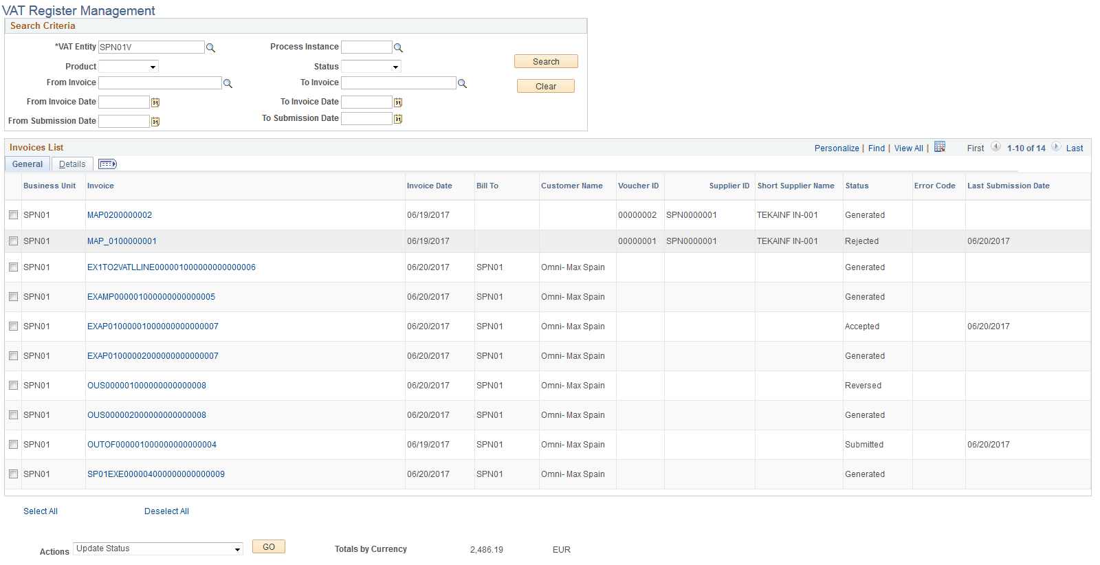

VAT Register Management Page
Use the VAT Register Management page (SII_VAT_REG_MGT) to manage and track VAT Register status.
Navigation:
This example illustrates the fields and controls on the VAT Register Management Page. You can find definitions for the fields and controls later on this page.
Field or Control |
Description |
VAT Entity |
Enter the VAT entity to manage and track. |
Status |
View the status displayed. |
Error Code |
View the error code displayed |
Action |
Select an invoice to update error code or status. |
Update Error Code |
Select an error code from the large list available. |
Change Status |
Select a status. The available options are:
Note: If you want to regenerate a file, as a modification (A1) change status to Ready or as an addition (A0) change status to Reversed. If you want to submit a rejected or erroneous transaction to the tax agency portal directly, change status to Manual in PeopleSoft.

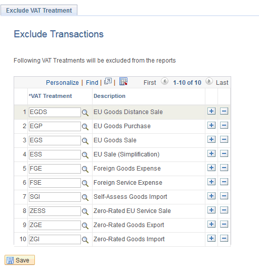

Use the Exclude Transactions page (ITA_VAT_TRTMNT_PG) to enter VAT Treatments to be excluded from reports.
Navigation:
This example illustrates the fields and controls on the Exclude Transactions Page. You can find definitions for the fields and controls later on this page.
Field or Control |
Description |
VAT Treatment |
Select a VAT treatment to exclude. |

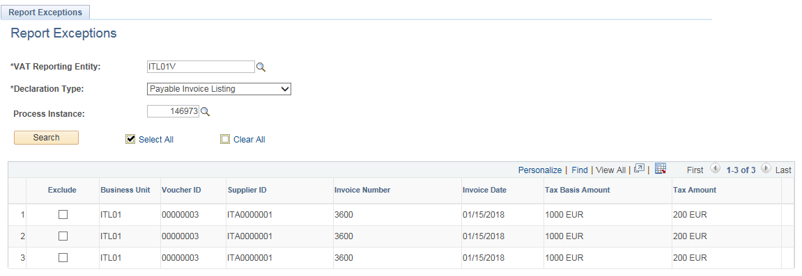

Use the Report Exceptions page (ITA_RPT_EXCEP_PG) to mark one or more transactions as exceptions and exclude from reporting.
Navigation:
This example illustrates the fields and controls on the Report Exceptions Page. You can find definitions for the fields and controls later on this page.
Field or Control |
Description |
VAT Reporting Entity |
Select the Italian VAT reporting entity. |
Declaration Type |
Select the declaration type. The available options are:
Process Instance |
Select a process instance for the given reporting entity. |
Exclude |
Select a transaction to exclude from reporting. |

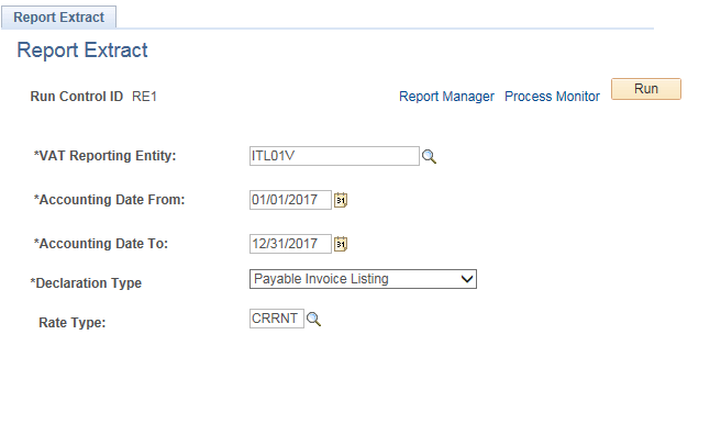

Use the Report Extract page (ITA_RPT_EXTRACT) to extract data into Reporting Tables.
Navigation:
This example illustrates the fields and controls on the Report Extract Page. You can find definitions for the fields and controls later on this page.
Field or Control |
Description |
Select the Italian VAT reporting entity for which data should be extracted. |
Accounting Date From |
Select the accounting start date from which the report needs to be extracted. |
Accounting Date To |
Select the accounting end date until which the process needs to retrieve the data. Note: According to Italian Legislative standards, Accounting From and To dates are on quarterly basis, but user can select dates based on the requirement. |
Declaration Type |
Rate Type |
Select the appropriate rate type. |

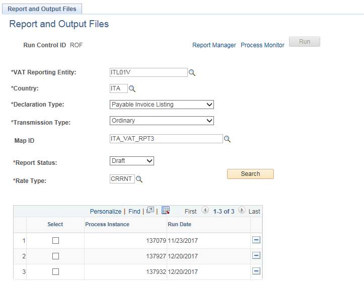

Use the Report and Output Files Page (ITA_RPT_RQST) to generate the Italian Trading Partner Declaration Report.
Navigation:
This example illustrates the fields and controls on the Report and Output Files Page. You can find definitions for the fields and controls later on this page.
Field or Control |
Description |
Country |
Select the country of taxation. |
Declaration Type |
Transmission Type |
Select the transmission type. The available options are:
MAP ID |
Select the associated MAP ID |
Report Status |
Select the report status. The available options are:
Rate Type |
Select the associated rate type |
Search |
Click to search for available process instances and select one to process. |
