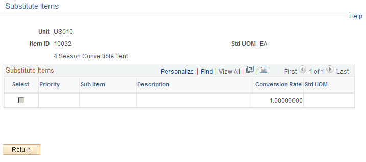

Use the Substitute Items (business unit level) page (INV_BU_SUB_ITM_SEC) to view an item's substitution definition at the business unit level, and if appropriate, select an alternate item.
Navigation:
Enter an item ID on the pages in the Material Stock Request component or the Express Issue page, and click the Transfer button next to the Item ID field. On the Transfer page, click the Substitute Items link.
This example illustrates the fields and controls on the Substitute Items page (business unit). You can find definitions for the fields and controls later on this page.
Click the Return button to close the page without selecting a substitution.
Select the check box on the row of a substitute item if you want to populate the Item ID field on the previous page with the substitute item's item ID.
Note: The Substitute Items link is not available for a supplier return-request type on the Express Issue page. Substitutions are not permitted for supplier returns.
For each substitution option, the system displays this information:
Field or Control |
Description |
Conversion Rate |
Specifies the factor to convert the transaction quantity to the item's standard UOM. |
Note: The conversion rate can be different at the SetID, business unit, and BOM levels.
