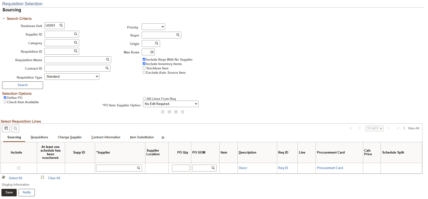

Use the Requisition Selection - Sourcing page (PO_REQ_SOURCE) to enter search criteria and source requisitions to purchase orders or inventory demand.
Navigation:
This example illustrates the fields and controls on the Requisition Selection - Sourcing page. You can find definitions for the fields and controls later on this page.
Search Criteria

Search |
Click to search for the requisitions that match the criteria you entered. The system populates the Select Requisition Lines grid with requisitions that match the criteria you enter. To perform another search, change the criteria and click the Search button again. |
Selection Options

Sourcing
Select the Sourcing tab.
Field or Control |
Description |
Include |
Select to include the requisition line for sourcing. After you select a requisition line, it becomes unavailable for entry. To make any further changes to the requisition line, clear the check box, make the change, then select it again. |

Use the Override Selected Requisition Supplier page (PO_REQ_SUPPLIER) to update the supplier ID for all selected requisition lines on the Requisition Selection page.
Navigation:
Click the Change Supplier link on the Requisition Selection - Sourcing page.
Select a supplier to use by selecting the Change Supplier check box for the selected requisition lines on the Change Supplier tab of the Requisition Selection - Sourcing page.
Field or Control |
Description |
Supplier, Supplier ID, and Location |
Select the supplier and location you want to override the current supplier with. |
OK |
When you click this button, the system updates the selected requisition lines with the supplier ID and location entered here and validates the item-supplier relationship. Once saved, the selected supplier is then staged into the purchase order staging tables. |
Use the Requisition Selection - Staging Information page (PO_REQ_CREATE) to view or modify a requisition before sourcing.
Navigation:
Click the Staging Information link on the Requisition Selection - Sourcing page.
