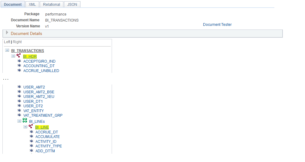

This example illustrates the fields and controls on the Document Builder - Document page.
In this example, BI_HDR is the anchor node and BUS_UNIT_TBL_FS is a sibling node that contains fields in the records for billing transactions.

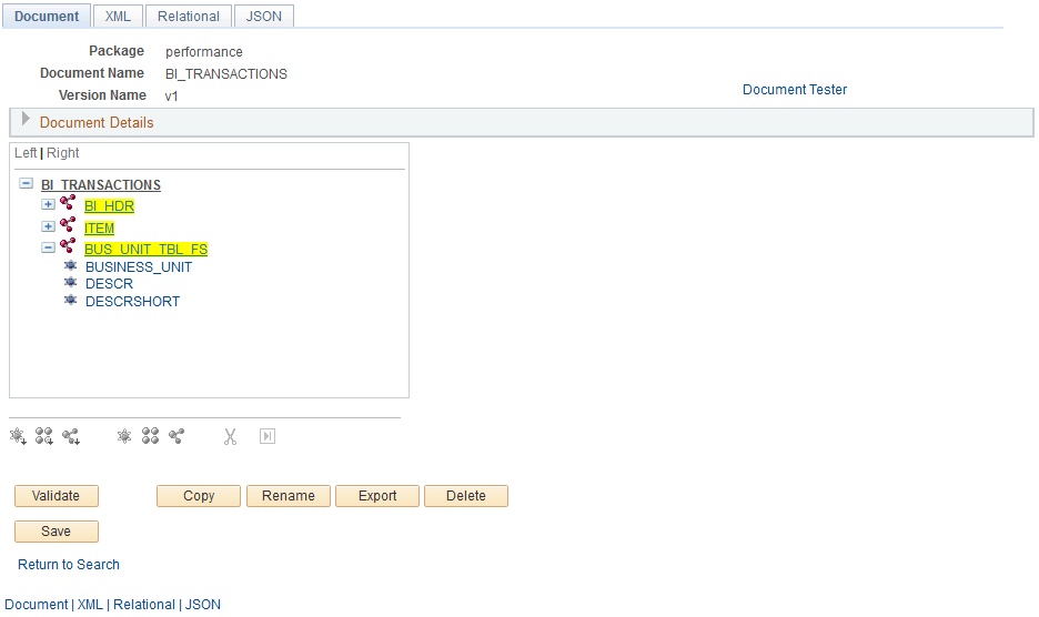

This example illustrates the fields and controls on the Document Builder - Documents page.

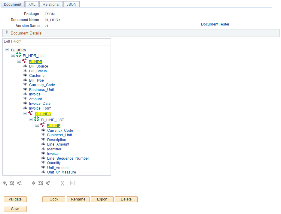

This example, which illustrates the fields and controls on the Document Builder - Document page, shows an XML-formatted PeopleSoft document.

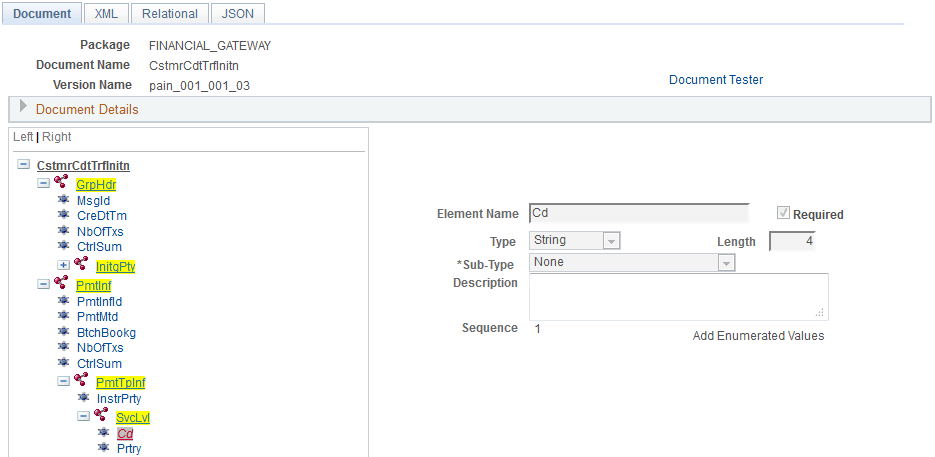

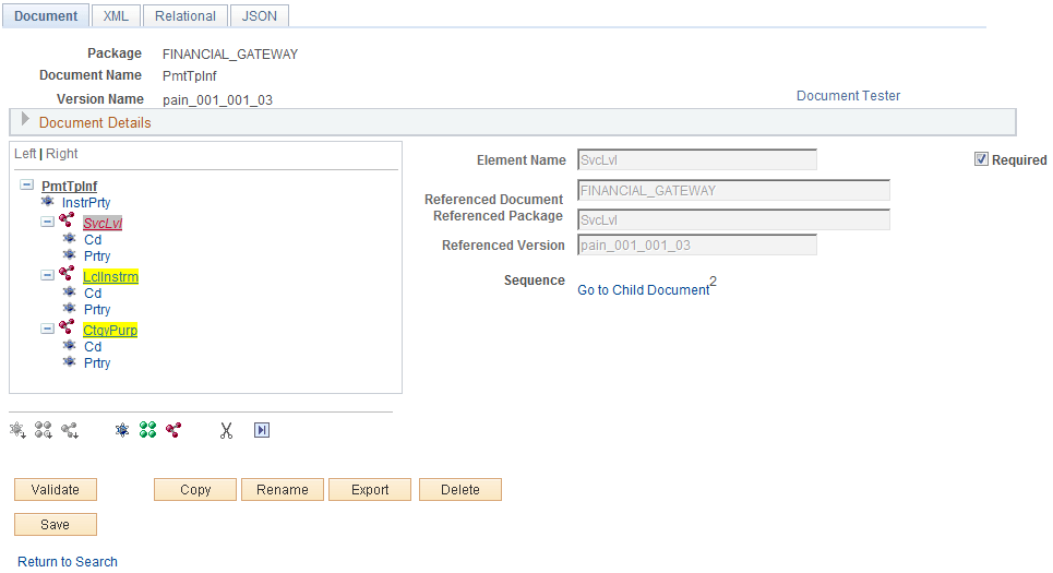

The Required check box is selected for the compound node and primitive element, but they are not mapped in the map definition.
This example illustrates the fields and controls on a PeopleSoft Document, showing a Compound Element with the Required check box selected.
In addition, the mapping details do not exist for this field on the Map Definition - Detail (Step 4 of 6) page.
The XML output in this case would look like this:
- <PmtTpInf> <InstrPrty>NORM</InstrPrty> - <SvcLvl> <CD /> </SvcLvl> </PmtTpInf>The Required check box is selected for the compound node and primitive element, and they are mapped in the map definition.

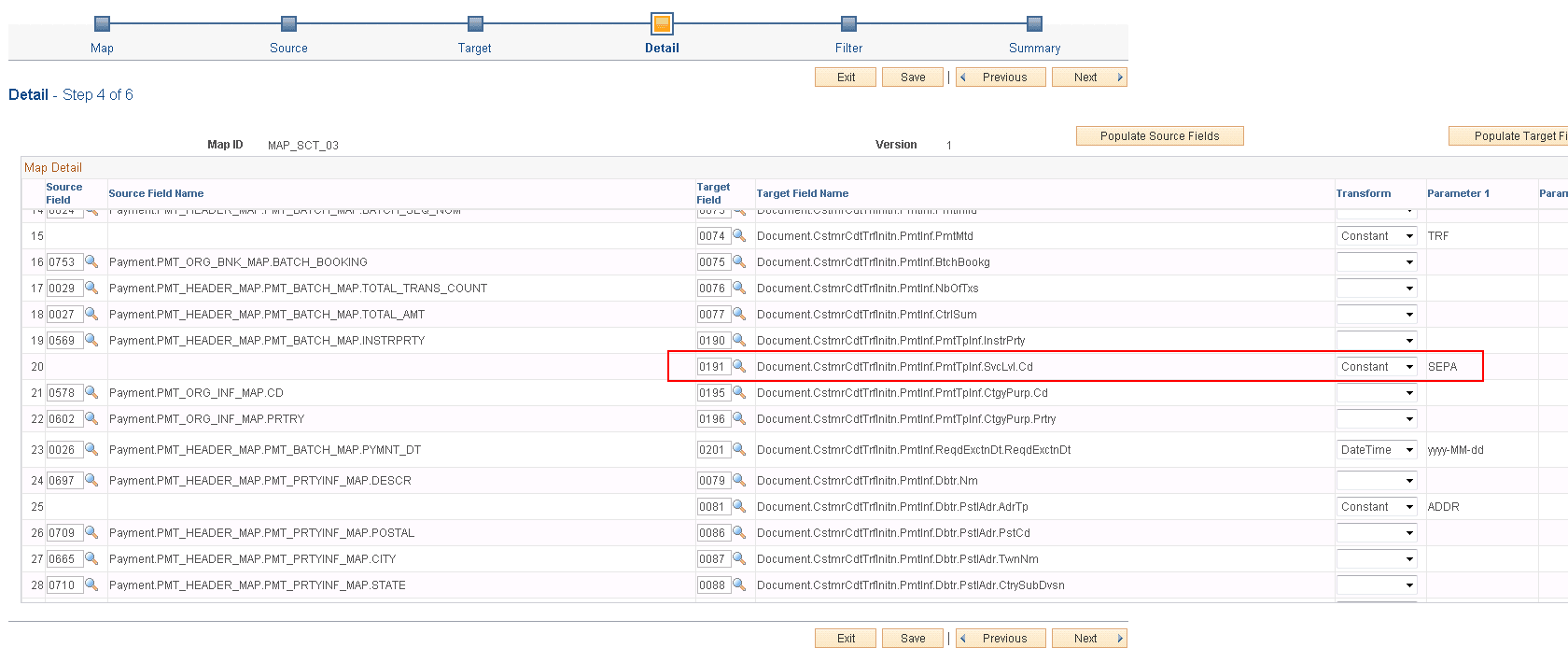

This example illustrates the fields and controls with the target fields populated on the Map Definition - Details page.
- <PmtTpInf> <InstrPrty>NORM</InstrPrty> - <SvcLvl> <Cd>SEPA</Cd> </SvcLvl> </PmtTpInf>The Required check box is not selected for the compound node and primitive element, and they are not mapped in the map definition.

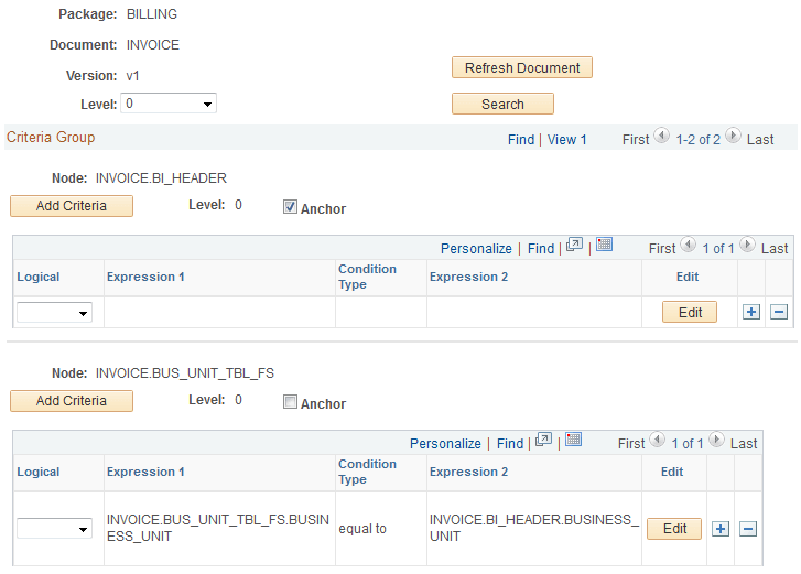

This example illustrates the Parent-Child Relationship on the Document Relationship page.
In this example, BUS_UNIT_TBL_FS and BI_HEADER are siblings. The purpose of adding the BUS_UNIT_TBL_FS record into this document is that you can translate the BUSINESS_UNIT field of BI_HEADER (for example, US001) into the DESCR field of BUS_UNIT_TBL_FS (for example, US001 New York Operator), thus providing more information in the output.
This example illustrates the Sibling Relationship on the Document Relationship page.
However, in this scenario, the goal is to export BI (billing) information, not BU (business unit) information. Thus the BI_HEADER node becomes the anchor. When exporting BI information, you can translate the BUSINESS_UNIT ID (for example, US001) to BU Name. When Data Export Import Utility processing fetches data from the sibling table, it must find the foreign key.

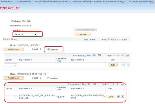

This example illustrates the fields and controls on the Document Relationship page.
In this example, only Level 0 document relationships are shown. Use the same logic to define other levels. The INVOICE_BI_HEADER is the anchor node for Level 0, which means that INVOICE_BI_HEADER is the driver table. It contains the main data, and data in tables from the other nodes will be loaded according to the anchor node.

Anchor |
Identify the node that drives the data. The Data Export Import Utility process first loads the anchor node value and then uses the anchor node value to load sibling node values. For example, the INVOICE_BI_HEADER node (table) contains the BUSINESS_UNIT field, which is the ID of BU. The BUS_UNIT_TBL_FS table contains the BU information. Data Export Import Utility processing first loads the INVOICE_BI_HEADER table and retrieves the BU ID; processing then proceeds to the BUS_UNIT_TBL_FS table, and it uses this BU information. The system distinguishes the anchor nodes from sibling nodes following these rules: The system can display multiple anchors at one level. When the system displays a child node as an anchor, its parent nodes must also be displayed as an anchor. When the system displays a parent node as an anchor, the anchor check boxes of its child nodes are deselected. The mapping utility scans anchor by anchor, and synchronizes at the sibling node. |
