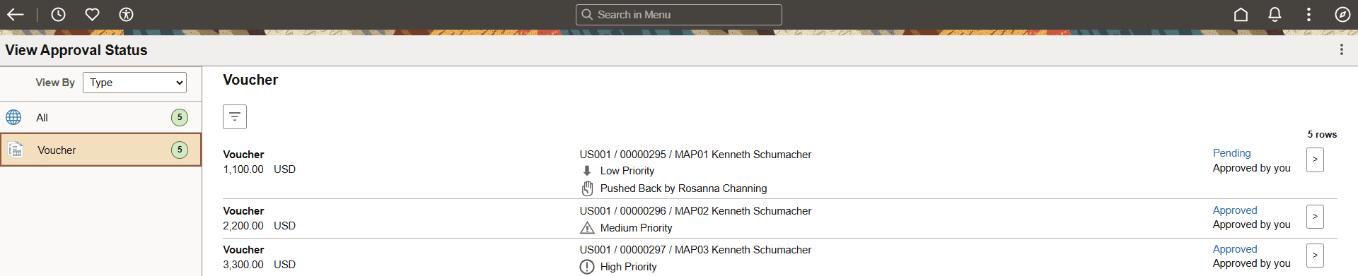

This example illustrates the fields and controls on the View Approval Status page with a Voucher that is Pushed Back in row one.
When a requester is logged in:
The list only displays transactions where the person who is logged in is the requester.
Transactions are in read-only mode, and you cannot act on them.
The list includes transactions that have a status of Pending: In-Process, On-Hold, or Pushed Back; or Completed: Approved, Denied, or Withdrawn.
Transactions that are submitted by the person logged-in are indicated with Submitted by You.
Transactions that are submitted by a proxy user for you are indicated with Submitted for you.
Transactions that have an Approved or Denied status are displayed for x number of days.
The number of days is determined on the Fluid Approval Setup - General Settings Page page, Age for Approvals History in Days field, and is calculated by the last updated date on the transaction.
When a submitter is logged in:
The behavior is the same as the requester view.
Transactions that you submitted on behalf of someone else are indicated with Submitted by You.
For example, if Sam submitted a voucher on behalf of Karl for approval, then both Sam and Karl see the transaction in their respective Requester’s view of the View Approval Status Page.
When an approver is logged in:
The list displays transactions where you are an approver and you have already acted on the transaction such as approving or denying the transaction.
Transactions that are waiting for the logged-in user's approval are not listed. Use the Pending Approvals Page to act on transactions.
Transactions where you are included in the approval chain are indicated with Approved by you or Denied by you.
Transactions are displayed for x number of days.
The number of days is determined on the Fluid Approval Setup - General Settings Page page, Age for Approvals History in Days field. and calculated by the last updated date on the transaction.
If you are a requester and an approver who acted on a transaction, the Requester role takes precedence, and is indicated with Submitted by you.
For example: You submit a voucher request, and you are listed as one of the approvers. You approve the voucher. The transaction is listed on the View Approval Status page and identified as Submitted by you. In addition, it displays the approver action taken by you.
