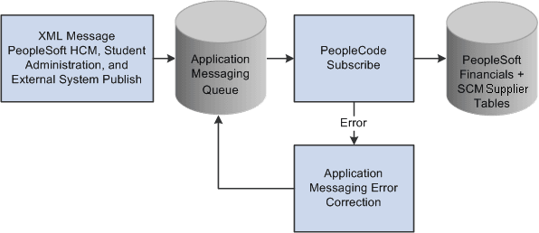

The Incremental Subscribe process enables you to subscribe to supplier data incrementally as it is published by PeopleSoft Payroll or by external applications.
Design Pattern |
Message Name |
Subscription Name |
PeopleCode Subscribe |
VENDOR_SYNC |
SupplierSync |
This example illustrates the Incremental Subscribe process:
Incremental Subscription Process for the VENDOR_SYNC Message
The supplier subscription code uses a component interface that encapsulates the supplier online component to handle default values and edits of the supplier data received in the subscribed message:

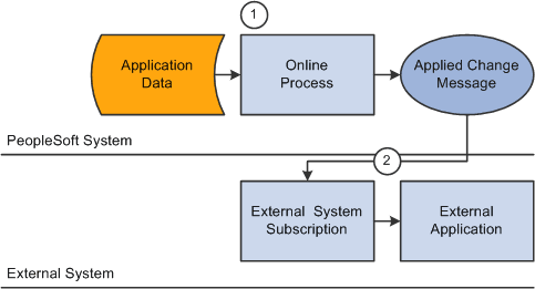

The Incremental Publish process enables you to publish supplier data incrementally to external systems.
Design Pattern |
Message Name |
Page Group Publish |
Supplier_sync |
This diagram illustrates the Incremental Publish process:
Incremental Publication Process for the VENDOR_SYNC Message
The following code calls the message publication code:

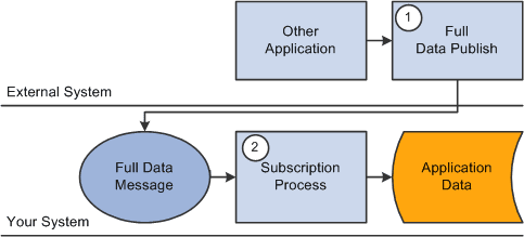

The Full Data Subscribe process enables you to subscribe to supplier data.
Design Pattern |
Message Name |
Subscription Name |
Full Data Replication |
VENDOR_FULLSYNC |
SupplierFullSync |
This diagram illustrates the Full Data Subscribe process:
Code for Full Subscription Process
The following code calls the full subscription process:

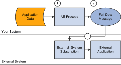

The Full Table Publish process enables you to publish supplier data to external systems.
Design Pattern |
Message Name |
VENDOR_FULLSYNC |
This diagram illustrates the Full Table Publish process:
Running the Full Data Publish Process
Use the Full Table Publish Rules page to define the publish rule for the message.
Once you have defined the rules for a full-data publish, you must use the Full Data Publish page to run a PeopleSoft Application Engine process to generate a full-data message that is published to the external systems.

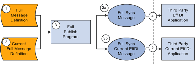

The Full Table Publish of Currently Effective Data process (VENDOR_FULLSYNC_EFF) enables you to publish current supplier data to external systems.
Design Pattern |
Message Name |
VENDOR_FULLSYNC_EFF |
This diagram illustrates the Full Table Publish of Currently Effective Data process:
Use this message only when you publish data to systems that do not support effective dating. This message publishes only the most current supplier record. It does not publish any history or future rows.
To publish PeopleSoft tables that are effective-dated to an external system whose tables are not effective-date-enabled:
Define the publish rule for the message on the Full Table Publish Rules page.
Enter record mapping details on the Record Mapping page.
Use the Full Data Publish process page to generate a full-data message for publication to an external system.

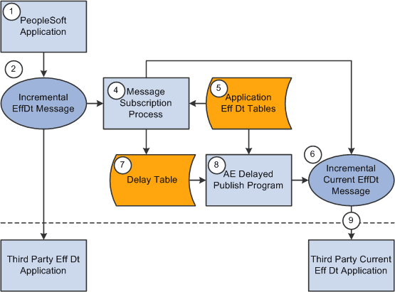

This flowchart illustrates how the Incremental Publish of Currently Effective Data process enables you to publish supplier data incrementally to external systems:
Code for Incremental Publish Process for Currently Effective Data
The following code calls the subscription process:
Declare Function process_effdt_msg PeopleCode FUNCLIB_EOEIP.EFFDT_MSG_PC FieldFormula;
process_effdt_msg("VENDOR_SYNC_EFF", False);
As with the Incremental Publish process, during the save time of this process, the Supplier Information component publishes a VENDOR_SYNC message that contains effective-dated information.
For third parties that can handle effective-dated data, messages are received and processed using the SupplierSync subscription method. For third parties that cannot handle effective-dated data, a subscription process called SupplierSyncEff can be invoked for local publications. It has been set up on the message-generating side, and it makes a call to a shared function.
The common function determines if the data is related to the current effective-dated row and, if so, it copies the data to the VENDOR_SYNC_EFF message and publishes it.
If the data has future effective dates, then the information is written to the Delay table (EO_EFFDELAY). A PeopleSoft Application Engine process publishes the data that resides in delay tables as they become current.
