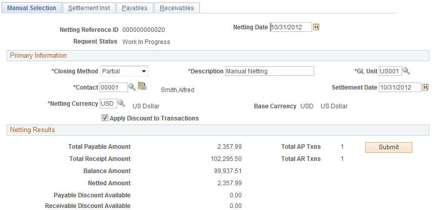

Use the Manual Selection page (NET_MANUAL_RQST) to enter primary information.
Navigation:
This example illustrates the fields and controls on the Manual Selection page. You can find definitions for the fields and controls later on this page.
Field or Control |
Description |
Netting Date |
Displays the effective date of the net. |
Netting Currency |
Select a netting currency. The system converts all amounts and displays them in this defined netting currency. |
Base Currency |
Displays the base currency of the selected GL Unit. |
Submit |
Click to submit the net. Note: Prior to submitting the net, you must complete the other pages in this component. |

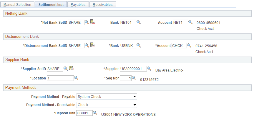

Use the Manual Select Netting - Settlement Inst (instructions) page (NET_MANUAL_RQST1) to set up your settlement instructions.
Navigation:
This example illustrates the fields and controls on the Settlement Inst (instructions) page. You can find definitions for the fields and controls later on this page.
Field or Control |
Description |
Netting Bank |
Click to select your netting bank SetID, and specify the bank and account. |
Disbursement Bank |
Click to select your disbursement bank ID, and specify the bank and account. |
Supplier Bank |
Click the link to select your supplier bank ID. Enter the Supplier, Location, and Sequence Nbr (sequence number). |
Payment Method-Payable |
Select Automated Clearing House, Direct Debit, EFT, Manual Check, System Check, or Wire Report. |
Payment Method-Receivable |
Select Check, Direct Debit, or Draft. |
Deposit Unit |
Define which business unit receives payment after the net. |

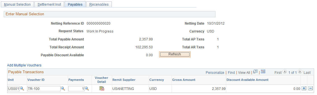

Use the Manual Select Netting - Payables page (NET_MAN_RQST_AP) to set up payables for manual netting.
Navigation:
This example illustrates the fields and controls on the Manual Select Netting - Payables page. You can find definitions for the fields and controls later on this page.
Field or Control |
Description |
Click Voucher Detail to access the Payables Voucher Detail page and view information for the voucher line item. |
Refresh |
When you are finished entering payable transaction items, click to update Total Payment Amount. |

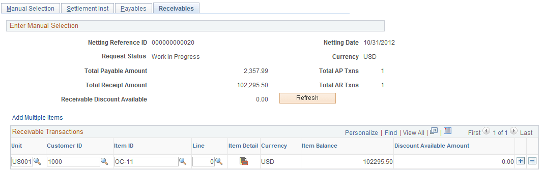

Use the Manual Select Netting - Receivables page (NET_MAN_RQST_AR) to set up receivables for manual netting.
Navigation:
This example illustrates the fields and controls on the Manual Select Netting - Receivables page. You can find definitions for the fields and controls later on this page.
Field or Control |
Description |
Click Show Item Detail to access the Receivables Item Maintenance page, and view information for the receivables line item. |
Refresh |
When you are finished entering receivable transaction items, to update Total Receipt Amount. |
