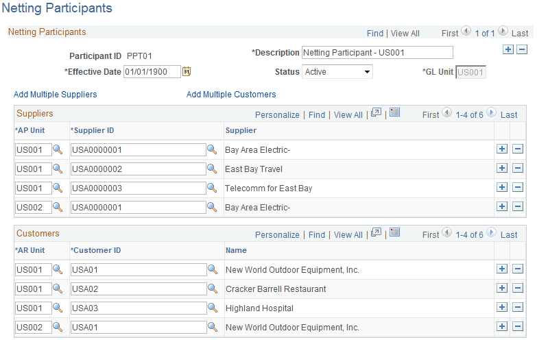

Use the Netting Participants page (NET_PARTICIPANT) to define the supplier and customer relationships involved in netting.
Navigation:
This example illustrates the fields and controls on the Netting Participants page. You can find definitions for the fields and controls later on this page.
Field or Control |
Description |
GL Unit (General Ledger business unit) |
For reporting purposes, you must select the unit that is targeted by these transactions, because the transactions affect balances at the general ledger level. |
Suppliers
Field or Control |
Description |
AP Unit (Payables business unit) |
Select the unit that houses the suppliers that are entering the netting relationship, and specify the Supplier ID. |
Add Multiple Suppliers |
Click to access the Add Multiple Suppliers page, and make this relationship a one-to-many or many-to-many relationship (for example, you might want to net the transactions of subsidiaries to a corporation). |
Customers
Field or Control |
Description |
AR Unit (Receivables business unit) |
Select the unit that houses the customers that are entering the netting relationship, and specify the Customer ID. |
Add Multiple Customers |
Click to access the Add Multiple Customers page, and make this relationship a one-to-many or many-to-many relationship (for example, you might want to net the transactions of subsidiaries to a corporation). |

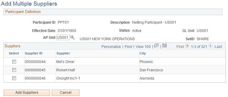

Use the Add Multiple Suppliers page (NET_VENDOR_ADD) to search and select multiple suppliers associated with a business unit to add to the netting relationship.
Navigation:
Click Add Multiple Suppliers on the Participant Definition page.
This example illustrates the fields and controls on the Add Multiple Suppliers page. You can find definitions for the fields and controls later on this page.
Field or Control |
Description |
AP Unit |
Specify a business unit from which to select suppliers. |
Add Suppliers |
Select suppliers and click this button to add them as participants. |

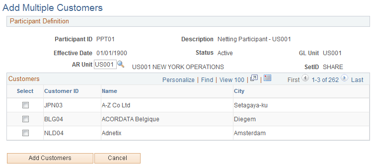

Use the Add Multiple Customers page (NET_CUSTOMER_ADD) to search and select multiple customers associated with a business unit to add to the netting relationship.
Navigation:
Click Add Multiple Customers on the Participant Definition page.
This example illustrates the fields and controls on the Add Multiple Customers page. You can find definitions for the fields and controls later on this page.
Field or Control |
Description |
AR Unit |
Specify a business unit from which to select customers. |
Add Customers |
Select customers and click this button to add them as participants. |

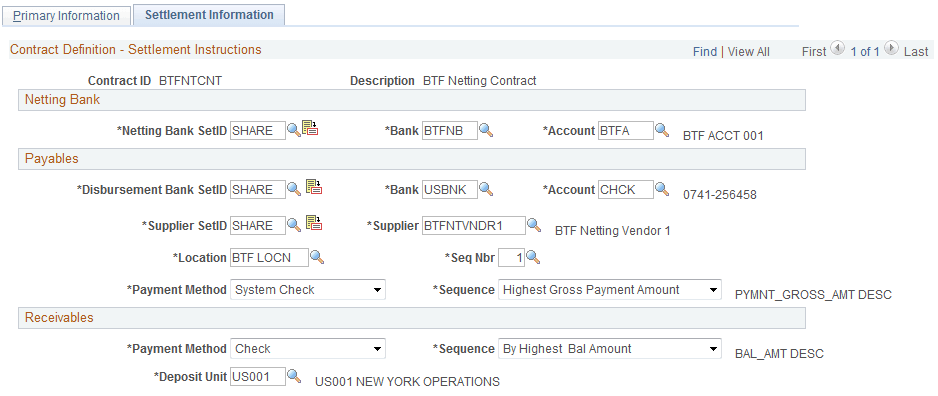

Use the Netting Contracts - Settlement Information page (NET_CONTRACT_STL) to define all settlement instruction information for a netting contract.
Navigation:
This example illustrates the fields and controls on the Netting Contracts - Settlement Information page. You can find definitions for the fields and controls later on this page.
Field or Control |
Description |
Netting Bank SetID |
Assign a netting SetID; then select the Bank and Account for the netting activities. The netting bank is a virtual bank account: no funds are actually paid into or out of the netting account. It is debited and credited by the netted amount of the AP and AR transactions. |
Disb Bank SetID (disbursement bank SetID) |
Select from the available external banks, and specify the settle through Bank and Account. |
Supplier SetID |
Assign a supplier SetID. In the Supplier field, designate the supplier involved in the net and assign a Location and Seq Nbr (sequence number). You enter the supplier ID and sequence number to associate the default bank with that supplier (this is required to support certain payment methods). |
Payment Method |
For the Payables group box, specify if payments are submitted by Automated Clearing House, Direct Debit, EFT, Manual Check, System Check, or Wire Report. For the Receivables group box, specify if payments are received by Check (Check, EFT, etc.), Direct Debit, or Draft. |
Sequence |
Select the order in which balances will net, either By Account Date (FIFO) (first in first out), By Accounting Date (LIFO) (last in first out), By Due Date (FIFO), By Due Date (LIFO), By Voucher, Highest Gross Balance, or Smallest Gross Balance. |
Deposit Unit |
Define which business unit will receive payment after the net. |
Click View Netting Account to view detailed information for the specified netting account. |
Click View Disbursement Bank to view detailed information for the specified external bank account. |
Click View Supplier Bank to view detailed information for the supplier location. |
