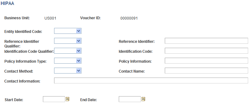

HIPAA Page
VCHR_HIPAA_SEC
(USA) Enter information for Health Insurance Portability and Accountability Act of 1996 (HIPAA) compliance. The link and page appear only if the payment method for the voucher has an EFT layout of HIPAA.

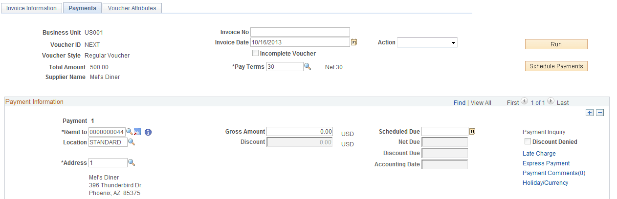

Use the Voucher - Payments page (VCHR_PAYMENT_PNL) to view the payment schedule for a voucher and override payment settings.
On this page, you can change the payment schedule, schedule multiple payments, schedule direct payments to an alternate supplier or supplier location, record a manual payment, and create an express payment.
Navigation:
Accounts Payable > Vouchers > Add/Update > Regular Entry > Payments
This example illustrates the fields and controls on the Voucher - Payments page, add mode (1 of 2). You can find definitions for the fields and controls later on this page.
Voucher - Payments page (Add mode) 1 of 2
This example illustrates the fields and controls on the Voucher - Payments page, add mode (2 of 2). You can find definitions for the fields and controls later on this page.
Voucher - Payments page (Add mode) 2 of 2
PeopleSoft Payables schedules payments for a voucher when you save the voucher. At that time, the system processes the voucher fields against the Payment Terms table to determine the net due, discount due, and scheduled due dates for the payment.
Note: Remember that if the supplier is on hold, the system does not select the voucher for payment until you remove the payment hold status for the supplier.
If a payment has been reconciled, the fields on this page are unavailable.

Pay Terms
Modify the payment terms.
Schedule Payments
Click to schedule the payment before you save the voucher. This function enables you to preview the payment due dates and discount (if any). With multipayment terms, you can also generate installment payment records (and review and edit them, if necessary) in advance of committing them when saving the voucher. You can always edit the voucher immediately after saving, but this alternate method may offer more peace of mind.
HIPAA
Click to access the HIPAA page, where you can enter HIPAA information for the voucher.
This link appears only if the payment method for the voucher has an EFT layout of HIPAA.

Scheduled Payment
Displays the scheduled payment number.
Remit to, Location, and Address
Displays the appropriate remit to supplier for the payment based on the remit to supplier that is established for the supplier on the Invoice Information page. This value is supplied by default from values that are established at the supplier location level. Whereas in most cases you remit directly to the supplier that sent you the voucher, the system enables you to override the default choices for remit to supplier, location, and address.
For example, if a supplier requires that payments be sent to its company corporate office rather than to a local office address, you can select the location to which the payment should be sent. You can also change the remit to supplier to pay one supplier for the vouchers of another, as is the case with factoring relationships, for example.
Note: The system updates the Remit to and Location fields appropriately if there are any changes to Supplier ID, ShortName, or Location fields on the Invoice Information page.

Use the Holiday/Currency Options page (PAY_OPT_SEC) to override the default bank holiday processing options and currency options for the payment.
Navigation:
Click the Holiday/Currency Options link on the Voucher - Payments page.
Holiday Processing Options
The system calculates bank holidays using the business calendar.
Field or Control
Description
Holiday Options
Select from the following values:
Due After Holiday: The system takes any bank holidays into consideration when it calculates the payment due date and delays payment until after the bank holiday.
If you select this value, you can also select the Allow due date in next month check box to enable the payment to be made in the next month. If you don't select this check box, and the payment date after a holiday does fall in the next month, the system schedules the payment before the holiday. For example, you would not select this value if you generally want payments to be made after a holiday but not in the next month when a holiday falls at the end of a month.
Due Before Holiday: The system takes any bank holidays into consideration when it calculates the payment due date and makes the payment before the bank holiday.
Not Applicable: The system does not take bank holidays into consideration when it calculates the payment due dates.
Days
Enter the number of days after or before the holiday that the payment can be made.

Use the HIPAA page (VCHR_HIPAA_SEC) to (USA) Enter information for Health Insurance Portability and Accountability Act of 1996 (HIPAA) compliance.
Navigation:
Click the HIPAA link on the Voucher - Payments page.
This example illustrates the fields and controls on the HIPAA page. You can find definitions for the fields and controls later on this page.
HIPAA page
Field or Control
Description
Entity Identified Code
Enter a code to identify the organizational entity, physical location, property, or individual: 3rd Party or Payer.
Reference Identifier Qualifier and Reference Identifier
Enter a qualifier against which to indicate that the payment is to be applied —Invoice, Master, or Plan— and a corresponding identifier number from the agency that is authorizing the payment.
Identification Code Qualifier and Identification Code
Enter a qualifier to indicate the code structure method of the identification code—D&B (Dun and Bradstreet), D&B + Sfx (Dun and Bradstreet plus 4-character suffix), Insurance, Plan ID, or Tax ID—and enter the corresponding code.
Policy Information Type and Policy Information
Enter Account, Contract, Invoice, or Policy to define the policy type, and enter additional information, such as the policy number.
Contact Method and Contact Name
Enter the preferred contact method: Email, Fax, or Telephone. Also enter the contact person's name.
Contact Information
Enter specific contact information, such as email address.
Start Date and End Date
Enter the dates to define the duration of the policy.
