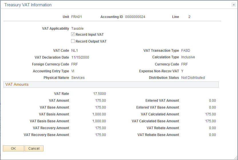

Use the Treasury VAT Information page (TRV_ACCTG_LINE_VAT) to use the Treasury VAT Information page to view VAT information for a specific accounting line.
Navigation:
Click VAT on the Accounting Entries − Accounting Entries tab.
This example illustrates the fields and controls on the Treasury VAT Information page. You can find definitions for the fields and controls later on this page.
Note: Treasury Management VAT functionality is currently limited to VAT on bank fees and other fees, recording only input VAT or the combination of input and output VAT. As such, it is unlikely that you will be using either the VO or VONT types for your VAT transactions.
Field or Control |
Description |
VAT Applicability |
Displays the default value derived from the accounting template. |
Record Input VAT |
This field is based on the defined VAT treatment. This check box is selected by default. |
Record Output VAT |
This check box is selected by default if the defined VAT treatment is EU Services Purchases or Self-Assessed Services Imports. |
VAT Code |
Displays the default value derived from the appropriate VAT defaulting hierarchy—this is also dependent on the VAT Treatment and/or VAT Applicability. |
VAT Transaction Type |
VAT Calculation Type |
Displays Inclusive or Exclusive. |
VAT Declaration Date |
Displays the default value derived from the transaction date. |
Accounting Entry Type |
Displays the VAT accounting entry type. VAT distribution account types define the different types of VAT accounting entries that may be required. Treasury Management only uses the following VAT distribution account types:
Expense Non-Recov VAT (expense nonrecoverable VAT) |
Displays one of the following values:
Distribution Status |
Indicates if the transaction has been loaded to the VAT Transaction Loader. Displays one of the following values:
VAT Rate |
Displays the VAT percentage that is applied to the transaction. |
VAT Amount |
Displays the VAT amount in the transaction currency. |
VAT Base Amount |
Displays the VAT amount in the base currency. |
VAT Basis Amount |
Displays the VAT basis amount in transaction currency. |
VAT Basis Base Amount |
Displays the VAT basis amount in the base currency. |
VAT Recovery Amount |
Displays the VAT recovery amount in the transaction currency. |
VAT Recovery Base Amount |
Displays the VAT recovery amount in the base currency. |
Entered VAT Amount |
The default value is zero (0). If either the VAT calculation type is Inclusive, or both Record Input VAT and Record Output VAT check boxes are selected, this field is set to zero and unavailable. You can override this default value by selecting Exclusive for the calculation type. This is the actual VAT amount in transaction currency that prints on the external document. If it is not equal to the calculated VAT amount (and not equal to zero), tolerance checking is performed. |
Entered VAT Base Amount |
Displays the entered VAT amount in base currency. The system uses the transaction currency for the entered VAT amount, based on the exchange rate that is applicable to the transaction. |
VAT Calculated Amount |
Displays the calculated VAT amount in the transaction currency. |
VAT Calculated Base Amount |
Displays the calculated VAT amount in the base currency. |
VAT Rebate Amount |
Displays the calculated VAT rebate amount in the transaction currency. |
VAT Rebate Base Amount |
Displays the calculated VAT rebate amount in the base currency. |
Note: This page is display-only. Once the Automated Accounting process creates the VAT accounting entries and distributes them to General Ledger, you cannot adjust the entries on a Treasury application page. You must use the General Ledger Journal Entry page to adjust VAT accounting entries.
