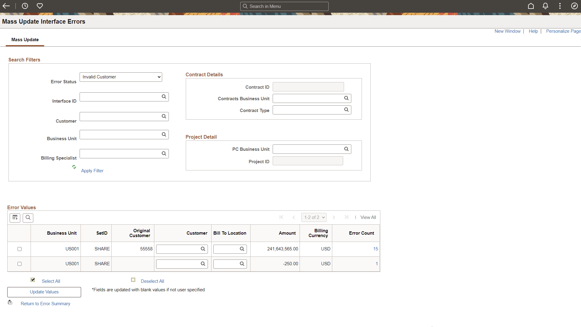

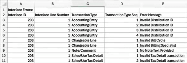

Mass correction is not possible for all the interface errors. Some errors need to be corrected using the single line correction or by making a change to the source.
This table lists the interface errors and indicates which errors can be corrected using mass update:

To verify data integrity, the Billing Interface process validates the data in the interface staging area.
If the Billing Interface process finds an error, it marks the LOAD_STATUS_BI column for all related rows as ERR (error). The Billing Interface process also marks the ERROR_STATUS_BI column with a more specific error condition.
A log file is created for all Billing Interface errors. Use the Correct Interface Errors Page to modify the Billing interface transaction data.
To view all Billing Interface errors from a Billing Interface process run:
From the Process Monitor page, access the Message Log page.
Search for the message text, "Please refer to the log file for interface errors."
If you see this text, then errors exist.
If you do not see this text, then errors do not exist.
Access the Process Details page and select the "ViewLog/Trace" link.
Select the "Interface_Errors_Log_File_xxx.csv" link to open the .csv file.
Example of Interface Errors Log File

Use the Mass Update Interface Errors page (BI_MC_INTFC_ERR) to update interface errors for multiple billing lines.
The default view is an error summary page with all errors statuses across all interface IDs. You can change the filter criteria based on your requirements.
Navigation:
This example illustrates the fields and controls on the Mass Update Interface Errors page. You can find definitions for the fields and controls later on this page.
Search Filters Section
Field or Control |
Description |
Error Status |
Select an error status found in the interface table. |
Interface ID |
Select an ID to search for errors by Interface ID. |
Business Unit |
Select a business unit to search for errors by BU. |
Customer |
Select a customer to search for errors by customer. The search is across all Set IDs and business units. |
Billing Specialist |
Select a billing specialist. You need to specify the business unit to search the errors by billing specialist. |
Contract Details |
User can search by Contract ID within a Contract BU or by Contract Type. The search can be performed only if Contracts is installed. |
Project Detail |
User can search by Project within a PC Business Unit. The search can be performed only if Projects is installed. |
Error Values Section
Use the Error Values grid to update the values. Click the Error Count link on the Mass Update page to view the Error Values grid.
Field or Control |
Description |
Update Values |
Click the Update Values button to update the Billing lines by entering the correct value. |

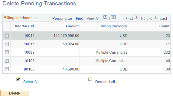

Use the Delete Pending Transactions page (BI_MD_INTFC_ERR) for deleting the entire interface ID for bills.
The Interface IDs are displayed on the Delete Pending Transactions page provided:
The interface lines have a system source as either BBI or blank. The interface IDs with lines having an internal interface source (Contracts, Inventory, Projects, Order Management, Asset Management) as the system source are not displayed.
None of the interface lines have a load status of ERR, UPD or DON. Interface IDs with pending or unprocessed lines are displayed.
Navigation:
This example illustrates the fields and controls on the Delete Pending Transactions page.
Interfaces with multiple currencies appear as a single line.
