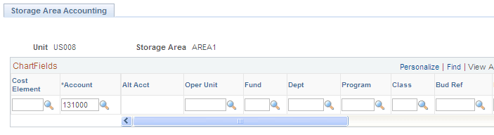

To define accounting by storage area, use the Storage Area Accounting component (STORAGE_ACCTS). Use the Storage Area Accounting Rules component interface (STORAGE_ACCTS_CI) to load data into the tables for this component.
Use the Storage Area Accounting page (STORAGE_ACCT_INV) to define the ChartField combinations for each storage area.
The system debits and credits these ChartFields when material is moved in and out of the storage area.
Navigation:
This example illustrates the fields and controls on the Storage Area Accounting page (partial page). You can find definitions for the fields and controls later on this page.
If you are using location accounting, enter the ChartField combinations for each storage area using the Storage Area Accounting page. Use these ChartField combinations to create the debit entry when materials are received in the storage area and to create the credit entry when materials are issued from the storage area. The other side of the entry comes from the matching Accounting Rules page.
This page remains available to edit, thus, giving you the ability to alter the ChartField combinations over time.
