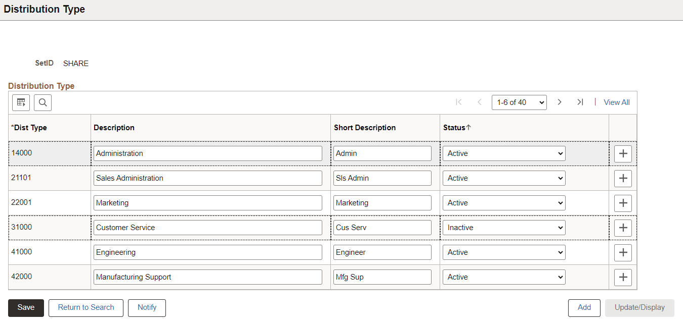

To define distribution types, use the Distribution Type (CM_DISTR_TYPE) component. Use the Distribution Type component interface (CM_DISTR_TYPE_CI) to load data into the tables for this component.
Use the Distribution Type page (CM_DISTR_TYPE) to use to define debit and credit account ChartFields at a finer level of granularity.
Navigation:
This example illustrates the fields and controls on the Distribution Type page.
In most instances, the transaction determines the debit and credit account to charge. For example, a customer shipment typically debits a cost of goods sold account and credits inventory. For some transactions, like a miscellaneous issue from stock, the transaction accounting rule can depend on the party to whom you issue the material. You could charge different departmental expense accounts for the receipt of inventory, depending on who requisitions the material from stock. Use distribution types to have the option to define different departments or cost centers.
When used in conjunction with the transaction group, distribution types enable you to define debit and credit ChartFields at a finer level of granularity. A manufacturing organization, for example, can set up a distribution type for each of its production departments. You assign these distribution types to the appropriate work center when you define the manufacturing data. When you record assembly completions at an operation or to stock, the system records the earned labor, machine, and overhead costs. If you have assigned a distribution type to the work center, the system records this distribution type along with the costs. This identifies the department or cost center that earned the labor, machine, and overhead costs. You can then set up transaction accounting rules for the transaction group Earned Labor (240) and the distribution type (for example, one of the assembly departments). Debit the production area account for the value of costs added to WIP and credit each department expense for the earned labor and applied overhead.
You can set up distribution sets in PeopleSoft Order Management with a distribution type that can be transferred to PeopleSoft Inventory and PeopleSoft Cost Management. This enables you to use the distribution type to classify costs of sales appropriate to the sales account.
By default, the newly added distribution type is Active. Only the active distribution types will be available for selection in upcoming transaction/set up pages. You can inactivate any distribution type by selecting the corresponding status value. If the user inactivates active distribution types that are already present on specific set up pages, such as transaction accounting rules pages, a warning message appears, stating that Inactivating the distribution type will be effected in upcoming transactions only, and there will be no retrospective effect. Such inactive codes, however, would not be removed from the transaction accounting rule set up pages. The user can create new rules without the inactive distribution type codes.
