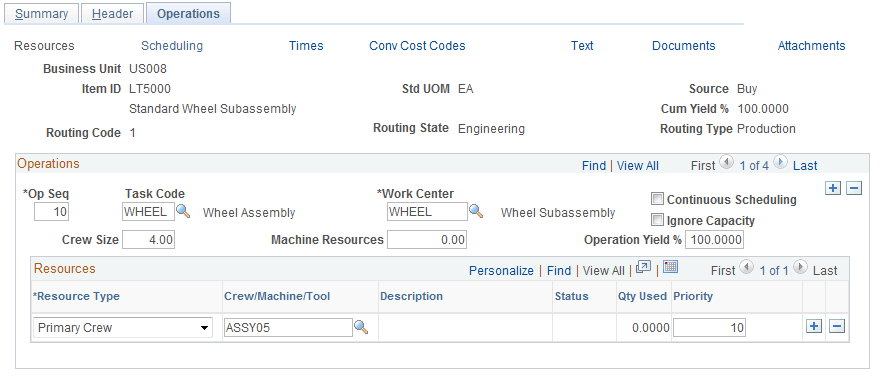

Use the Define Engineering Routings - Operations: Resources page (EN_RTG_RESOURCE) to define engineering routing resources.
Navigation:
This example illustrates the fields and controls on the Define Engineering Routings - Operations: Resources page. You can find definitions for the fields and controls later on this page.
Default values for the Op Seq (operation sequence), Task Code, and Work Center fields come from the Define Engineering Routings - Summary page, but they can be changed here.
Field or Control |
Description |
Continuous Scheduling |
Select this check box to complete the corresponding operation in a single run of continuous valid calendar time, with no gaps allowed between shifts. |
Ignore Capacity |
Select this check box to prevent the PeopleSoft Supply Planning solvers from analyzing and resolving capacity issues that affect the work center. When selected, capacity issues, although not recognized by the solvers, appear in the Supply Planning Violations Workbench if they are before the capacity fence defined for the planning instance. By selecting the Ignore Violations check box on noncritical work centers, you enable the solvers to ignore these work centers and focus on critical work centers for capacity repair. Deselect this check box to generate what-if scenarios. |
Crew Size and Machine Resources |
You can change crew size and machine resources if you have specified a task. Default values come from the specified task. If you haven't specified a task, the default values come from the work center. Crew size is the number of people at the work center. Machine resources are the number of machines at the work center. |
Resources
Default values for operation resources associated with the engineering routing operation are populated by the specified task. If no task is specified, the default values are from the work center. Specifying resources on the engineering routing operation is optional. You can delete existing resources if they aren't appropriate for use with the manufactured item.
Field or Control |
Description |
Resource Type and Crew/Machine/Tool |
To change a primary resource or add additional resources, select the resource type (Primary Crew, Primary Machine, Primary Tool, Alternate Crews, Alternate Machines, and Alternate Tools) and resource (use the Crew/Machine/Tool field) to associate with the operation. The resource must have been previously associated with the work center. You can have only one each of these resource types on a routing:
Qty Used (quantity used) |
If the resource changed or a tool is added, enter the quantity used. |
Note: You cannot associate crew and machine resources with subcontracted tasks or operations.

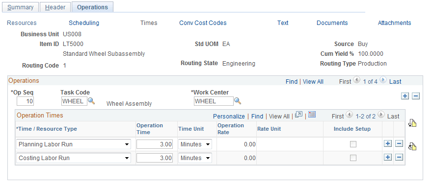

Use the Define Engineering Routings - Operations: Times page (EN_RTG_TIME) to use as part of planning and costing considerations to define engineering routing operation times and rates for an operation.
Navigation:
This example illustrates the fields and controls on the Define Engineering Routings - Operations: Times page. You can find definitions for the fields and controls later on this page.
Operations
Default values for the Op Seq (operation sequence), Task Code, and Work Center fields come from the Define Engineering Routings - Summary page, but can be changed here.
If you have already associated a task code with an operation, and you change the task, the system deletes the existing task information, including work center, resources, task times, and scheduling options, and adds the new task information for the specific operation. Additionally, if you define conversion rates at the task level, the system deletes the old task rates and adds the new rates.
You can insert a new operation in the same manner as on the Define Engineering Routings - Summary page.
You can change the work center for this task as it applies to this engineering routing sequence. If you change the work center, the system deletes the resources associated with the old work center and adds the new work center's resources. If you maintain conversion rates at the work center level, the system deletes the old rates and adds the new rates.
If the task is subcontracted, the Sub (subcontracted) check box is selected, and the Supplier ID field appears.
Note: You can specify only labor times for a subcontracted operation.
Operation Times
Default times or run rates are populated using the specified task information. You can modify the manufacturing times or rates for fixed run, post production, run, and setup for the task. Changing the times and run rates here has no effect on the default master task information. If you didn't specify a task, you can enter the times necessary to complete this operation.
If you are changing the operation costing times and run rates after the item's cost has been calculated and updated, the modification results in-process change variances for the item during any production subsequent to the change. These variances continue until the item's cost is recalculated and updated. If you are changing the operation from a regular task to a subcontracted one, you cannot select machine times or rates for the operation.
Select an operation time type and then enter an operation time or operation rate. You can specify operation rates only for planning or costing run time.
If you enter an operation time, then Time/Rate Unitfield values include Days, Hours, or Minutes. For example, if you enter 5 in the Op Time field and Days in the Time/Rate Unit field, one unit is completed every five days for the operation. The system determines the number of hours in a day by the work center's average daily hours, as defined in the Work Center Definition page.
If you enter an operation rate, then the Time/Rate Unit field values include Units/Day, Units/Hour, or Units/Minute. For example, if you enter 3 in the Op Rate field and Units/Day in the Time/Rate Unit field, three units are completed every day for the operation.
Note: If you are defining routing times for a multiple output batch item (at least one co-product on the item's BOM), then both the routing times and rates for costing and planning must be in terms of the in-process batch item's quantity (BOM quantity) and not in terms of a primary or co-product. For example, if the BOM quantity for item ID 10001 is 1000, and the BOM's primary output quantity for 10001 is 500 (for every batch of 1000 you anticipate getting 500), the routing times and rates must be defined in terms of the 1000, and not 500.
You can change any production times or rates for the task, for the specific item engineering routing, without affecting the master task information. If you make a change here, and you want to make the task data identical, you also need to make the change on the Task Time page. The converse is also true. Once you have associated times or rates with an operation, changing the task master data won't affect the data on this page.
Field or Control |
Description |
Inc. Setup (include setup) |
Select this check box for operation lead time calculation, but only for the Planning Labor Setup and Planning Machine Setup operation types. This check box is unavailable for selection in all other cases. Setup, if specified for the first operation, is always included in the lead time calculation. If you don't select Inc. Setup, setup can begin prior to any production units arriving at the work center. The system assumes that setup can occur at any time after the start of production and won't include setup as part of the item's lead time, except at the first operation. |
The system allows only queue and in-transit as well as planning and costing labor setup, run, fixed run, and post production times for subcontracted tasks and operations. You cannot specify machine times. If you are using PeopleSoft Supply Planning, you cannot use queue times.
Costing Considerations
To calculate costs for a specific item, operation, or time type, you must have a corresponding costing rate type defined for a particular engineering cost version. For example, if you had a costing fixed run time of five hours defined on the task here, you should also have defined, within PeopleSoft Cost Management, an engineering cost version and conversion code combination.
If you intend to cost the operation using a fixed amount per unit (as opposed to a rate per hour) you must include a corresponding costing operation time type. The costing operation time can represent the amount of time to complete the task, and the system uses the value to calculate earned hours. However, the system uses the amount per unit in calculating the cost, regardless of the time specified. If you don't specify a costing time, the system won't include the per-unit cost, even if there's a rate defined for the code assigned to the task.
Note: You can use the costing information (codes and rates) specified on engineering routings within engineering cost versions, as long as the routing remains in PeopleSoft Engineering. Once the routing is transferred to PeopleSoft Manufacturing, item costs must be generated and updated using a non-engineering cost version.

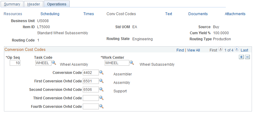

Use the Define Engineering Routings - Operations: Conv Cost Codes (conversion cost codes) page (EN_RTG_CONCOST) to associate conversion cost codes with an operation.
Conversion rates or costs are associated with each code. The system uses these rates or costs to determine the labor, machine, and overhead cost of the operation.
Navigation:
This example illustrates the fields and controls on the Define Engineering Routings - Operations: Conv Cost Codes page. You can find definitions for the fields and controls later on this page.
Default values for the Op Seq (operation sequence), Task Code, and Work Centerfields come from the Define Engineering Routings - Summary page, but can be changed here. If you are maintaining conversion rates at the work center level, the system displays the conversion codes associated with the operation's work center. If you are maintaining conversion rates at the task level, and you entered a task code, the system displays the conversion codes associated with the operation's task.
Field or Control |
Description |
Conversion Code |
To change the labor, machine, or overhead cost for a specific operation on an engineering routing, select the conversion code that the system uses to determine the new labor and machine costs. |
First Conversion Ovhd Code (first overhead conversion code) Second Conversion Ovhd Code (second overhead conversion code) Third Conversion Ovhd Code (third overhead conversion code), and Fourth Conversion Ovhd Code (fourth overhead conversion code) |
Select up to four conversion overhead codes. The system uses these codes to calculate the overhead costs associated with the operation. |
Note: If your labor or machine rate is in cost per unit, and you want to include the cost in the cost roll-up calculation, you must have selected a corresponding costing rate type. For example, if the labor run rate (cost) is 0.50 USD per unit, the routing operation must have an entry for costing labor run time in order for the 0.50 USD to be included in the operation's cost.
The rates displayed are the current rates that are used in production to calculate earned labor, machine, and overhead costs. These costs are copied into a frozen production rate record during the production cost update and inventory revaluation process and are based on the rates associated with the cost type and version used to calculate the new production costs.
