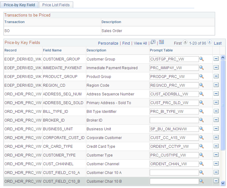

Use the Price-by Key Field page (EOEP_APPKEY_FIELD) to select the price-by fields that are used to price the transaction.
Navigation:
This example illustrates the fields and controls on the Price-by Key Field page (1 of 2). You can find definitions for the fields and controls later on this page.
This example illustrates the fields and controls on the Price-by Key Field page (2 of 2). You can find definitions for the fields and controls later on this page.
Field or Control |
Description |
Price-by Key Fields |
View the current price-by fields for the transaction. You can delete fields from this list to remove them from use in pricing the transaction. |
Build Price-by Key Fields |

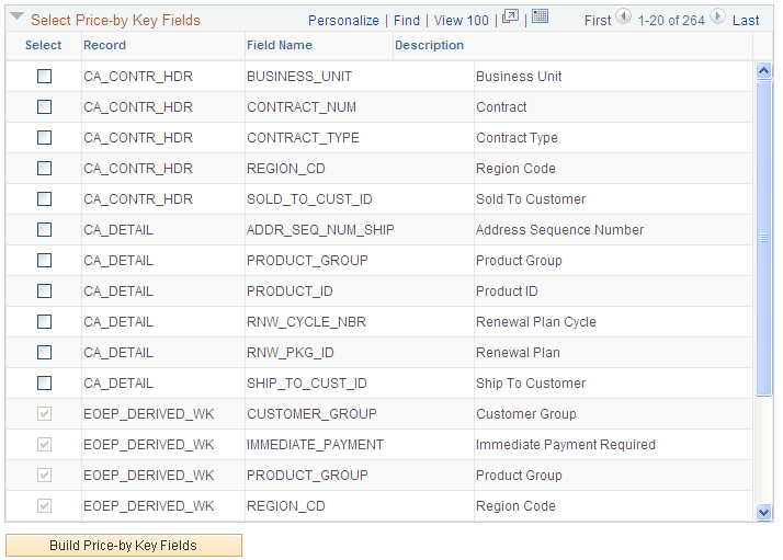

Click to add fields to the Price-by Key Fields grid after selecting them from the Select Price-by Key Fields grid. Note: If a price-by field is currently assigned to a price rule or an arbitration plan, you cannot remove it from the list of values assigned to the pricing transaction. |
Select Price-by Key Fields |
Select additional price-by fields. Note: The number of pricing keys that you can define is not limited; however, system performance slows when the number of keys increases. In addition, you might need to change the application code to pass the value to the Enterprise Pricer. For example, if you add a new field for sales orders, you must add code to the sales order to pass the value of the new field when calling Enterprise Pricer. You must perform this customization for both online and batch pricing. The RMA transaction uses the same pricing keys as the Sales Order transaction. Therefore, there is no need to set up pricing keys specific to the RMA transaction. |
