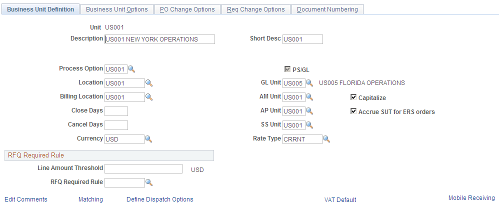

Use the Business Unit Definition page (BUS_UNIT_TBL_PM ) to create a PeopleSoft Purchasing business unit.
Navigation:
Click the Purchasing Definition link on the Maintain Business Units page.
This example illustrates the fields and controls on the Business Unit Definition page.

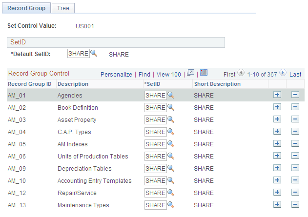

Use the TableSet Control - Record Group page (SET_CNTRL_TABLE1 ) to group record definitions for the tables that you want to share, as well as any dependent record definitions.
This creates relationships between SetIDs, business units, and record groups.
Navigation:
Click the TableSet Control link on the Maintain Business Units page.
This example illustrates the fields and controls on the TableSet Control - Record Group page.
If you are integrating with a marketplace, use the TableSet Control - Record Group page to link the PeopleSoft eProcurement record group PV_01 as a marketplace buyer.
Note: Before altering this page, you should have a clear understanding of tablesets, record groups, and relational database concepts. Please see your database administrator before making changes.

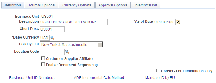

Use the General Ledger - Definition page (BUS_UNIT_TBL_GL1) to define PeopleSoft General Ledger business units.
Navigation:
Click the General Ledger Definition link on the Maintain Business Units page.
This example illustrates the fields and controls on the General Ledger - Definition page.
Set up a PeopleSoft General Ledger business unit even if you are not using the PeopleSoft General Ledger system.

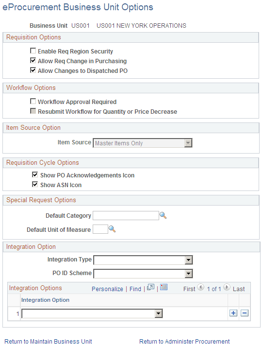

This example illustrates the fields and controls on the eProcurement Business Unit Options page. You can find definitions for the fields and controls later on this page.
Field or Control |
Description |
Enable Req Region Security (enable requisition region security) |
Select to indicate that requisitions for this business unit have regional security. This means that the result of an item search from a requisition displays only those items and suppliers that are relevant to the regions for a requester. |
Allow Req Change in Purchasing (allow requisition change in purchasing) |
Select to indicate that you can change requisitions added in PeopleSoft eProcurement (that is, having a SYSTEM_SOURCE of EPO) using the PeopleSoft Purchasing components. A eProcurement requisition can be altered in PeopleSoft Purchasing; however, a requisition added in PeopleSoft Purchasing cannot be altered using PeopleSoft eProcurement components. |
Allow Changes to Dispatched PO |
Select to enable users to create a change request when the requisition line has been source to a purchase order and the purchase order has already been dispatched. This value is overridden by the same option on the linked supplier's Supplier Properties page (i.e. ALLOW_PO_CHNG = N). Deselect to prevent users from creating a change request when the purchase order has already been dispatched. |
Workflow Approval Required |
Select to indicate that requisitions and change requests for this business unit must go through the approval workflow framework before the requisition is set to the status of approved. If this same check box is selected on the PeopleSoft Purchasing business unit then the approval workflow framework is turned on for both Purchasing and eProcurement and this check box on this page is unavailable. Selecting the Workflow Approval Required check box on the eProcurement business unit but not the Purchasing business unit turns on the approval workflow framework only in PeopleSoft eProcurement; in this case, if you edit an eProcurement requisition within a Purchasing component, the approval process is not triggered. Keep in mind that a requisition added in PeopleSoft eProcurement can be changed using the PeopleSoft Purchasing components only if you have selected the Allow Req Change in Purchasing check box on this page. A requisition added in PeopleSoft Purchasing cannot be altered using PeopleSoft eProcurement components. |
Resubmit Workflow for Quantity or Price Decrease |
Select this check box to require the approval of a change request with a decrease in item quantity or price. When a requisition is changed to increase the item quantity or price, the system automatically requires approval of the change request. |
Item Source |
Select the catalog source for this business unit. Items can come from the item master tables, the express catalog, or both. This field is available for selection when the Item Source Option on the eProcurement Installation Options page is set to Master and Express Items. |
Show PO Acknowledgements Icon (show purchase order acknowledgements icon) |
Select to display the POA icon on the requisition cycle. This icon can be used to view a purchase order acknowledgement received from a supplier. The requisition cycle can be viewed on the Manage Requisitions page or the Requisition Cycle for: <requester> page. |
Show ASN Icon (show advanced shipping notice icon) |
Select to display the ASN icon on the requisition cycle. This icon can be used to view an advanced shipping notice (ASN) received from a supplier. The requisition cycle can be viewed on the Manage Requisitions page or the Requisition Cycle for: <requester> page. |
Integration Type |
Select the type of integration that you will be using. Examples are Oracle, PeopleSoft 8.4, and SAP. |
PO ID Scheme (purchase order ID scheme) |
Select the purchase order ID scheme that you will be using. Examples are PO ID - User Defined and PO ID by Business Unit. |
Integration Option |
Select an option to control how the business unit acts for requisitions. Values include: Do Not Consolidate: Select to have the system create all requisition lines for this business unit with the Do Not Consolidate field set to Yes. External Invoices: Select to indicate the requisition cycle sources invoice data from a set of staging tables that can be populated from an external accounting system. External Payments: Select to indicate the requisition cycle sources payment data from a set of staging tables that can be populated from an external accounting system. External Receiving: Select to indicate the requisition cycle sources receiving data from a set of staging tables that can be populated from an external system. No Deletion After Integration: Select to indicate that deletions will not occur after the integration processes are run. One Distribution per Schedule: Select to indicate that users cannot create requisitions with multiple distributions per schedule. One Schedule per Line: Select to indicate that users cannot create requisitions with multiple schedules per line. PeopleSoft PO ID Used (PeopleSoft purchase order ID used): Select to indicate that the external system will have the same purchase order ID as the PeopleSoft order when integrating with an external system. |
Note: You can select more than one integration option by adding rows to the Integration Options group box.
