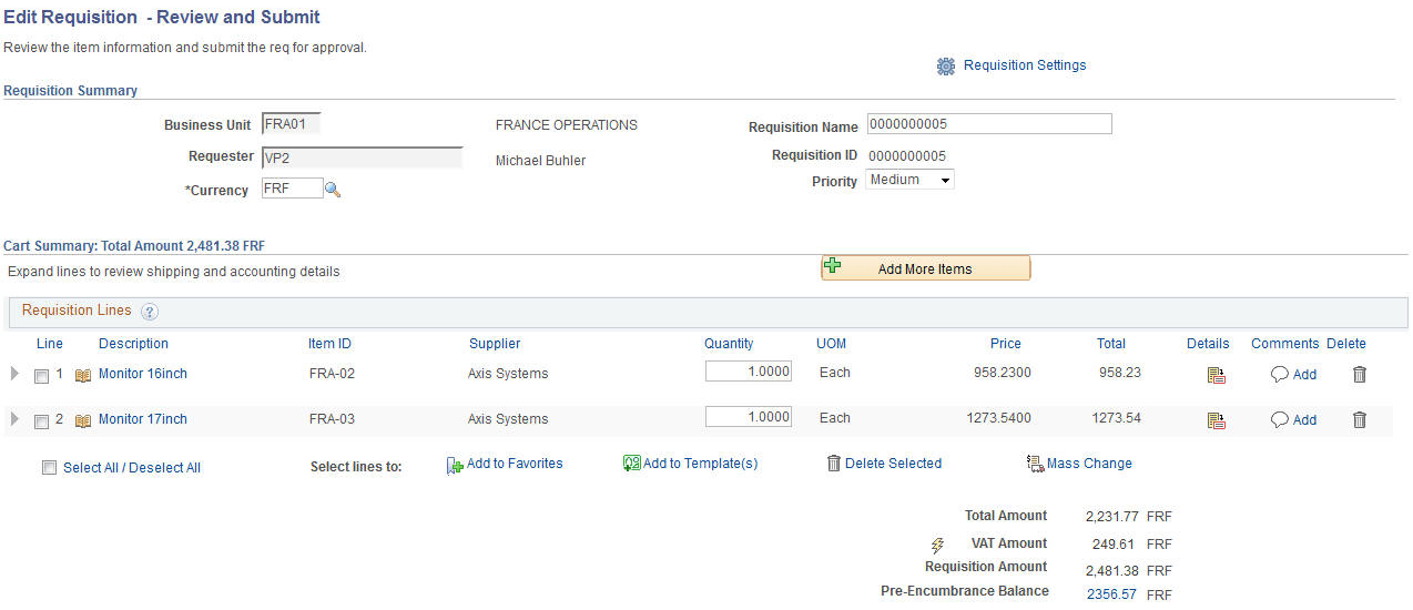

PV_REQ_CHECKOUT |
Edit requisition information. This page is accessible only for open requisitions. |

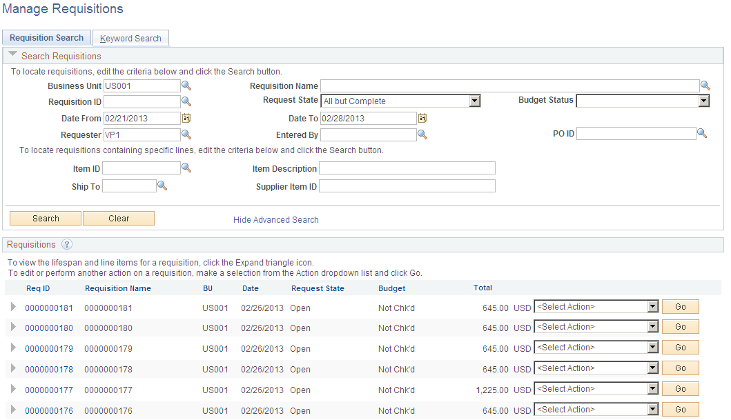

Use the Manage Requisitions page (PV_REQ_STATUS) to view and manage requisitions.
Navigation:
This example illustrates the fields and controls on the Manage Requisitions page. You can find definitions for the fields and controls later on this page.
Use this page to review requisitions. From this page, you can access other pages to perform tasks, such as review requisition details, edit or cancel requisitions, create change requests, receive stock, copy requisition, view approvals, or return stock to the supplier.
Before using this page, determine your display options:
Use the eProcurement Installation Options page to define the maximum number of rows that are retrieved and appear on the Manage Requisitions page.
If the eProcurement role action NO_DEFAULT_RESULT is assigned to a user, requisitions do not appear in the scroll area until the user clicks Search.
Search Requisitions
Enter search criteria in this group box and click the Search button to display requisitions below in the Requisitions group box. Search criteria include:
Field or Control |
Description |
Business Unit |
Select the PeopleSoft Purchasing business unit. |
Requisition Name |
To find a specific requisition, enter the description of the request entered by the requester when the requisition was added. |
Requisition ID |
Enter a specific requisition ID to display. |
Request State |
Select the state for the overall requisition (header-level) to limit the requisitions displayed to this status. Leave this field blank to display search results without using request state as a search criteria. The following search criteria are included:
Note: States are defined below for the Request State field (at the requisition header level) in the Requisitions group box. |
Budget Status |
Displays the header results of a budget check initiated by clicking the Check Budget button or the Pre-Check Budget button. The options are:
Date From and Date To |
Enter the creation date or range of dates for the requisitions. |
Requester |
Enter the requester of the requisition. |
Entered By |
Enter the user ID of the individual who entered in the requisition. This is usually the requester but can be another individual. |
PO ID |
Enter the Purchase Order ID where the requisition was sourced. |
Show Advanced Search |
Click to view four more search fields, which are:
Keyword Search
Enter a word (for example UPN ID) or a string of characters in the Keyword Search box, and then click the Search button to display requisitions having UPN ID in the Requisitions group box.
Requisitions
This group box displays requisitions based on the search criteria in the Search Requisitions group box. Basic information about the entire requisition (requisition header-level) is displayed for each requisition. You can view additional information, including line details by using the Expand Section icon.
Field or Control |
Description |
Req ID (requisition id) |
Click a requisition ID to access the Requisition Details page, where you can view additional details of the requisition. |
Requisition Name |
Displays the description of the request entered by the requester when the requisition was added. The requisition name helps to identify this requisition as it flows through the system. If no requisition name was entered, then the requisition ID is displayed. |
BU |
Displays the PeopleSoft Purchasing Business Unit for this requisition. |
Date |
Displays the date the requisition was created. |
Request State(at the requisition header level) |
This state field displays the request state across the entire procurement cycle, not just the requisition header state. The following states are included:
Budget |
View the budget status for the requisition. This column appears when Commitment Control is enabled. |
<Select Action> |
Select an option and click the Go button to perform the action. The available actions vary depending on the status of the requisition. Actions include:
Some additional Actions available are Receive, Process Returns, Check Budget, and Pre-Check Budget . Note: The options that appear for a requisition differ depending on the status of the requisition. For example, you cannot cancel a requisition for which a PO is created. |
Go |
Click to perform the selected action. |
Create New Requisition |
Click to access the Create Requisition page, where you can add another requisition. |
Review Change Request |
Click to access the Change Request List for page, where you can view and process change requests. |
Review Change Tracking |
Click to display the View Requisition Change Tracking History page, where you can view changes to requisitions if you are using the change tracking feature. This page provides an audit trail of key transactional information including, changes to any fields marked for track changes on the change template, the user who modified the requisition, and the date and time of each requisition change request. |
Manage Receipts |
Click to access the Receipts For page, where you can view and maintain receipts. |
Requisition Report |
Click to access the Print Requisition process page, where you can define parameters for creating the printed requisition report (POY1100). |

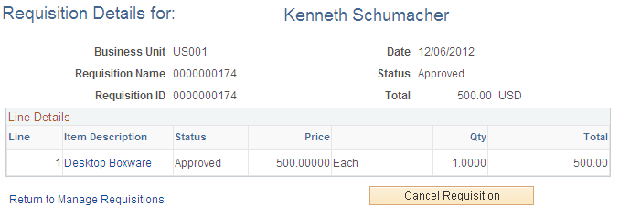

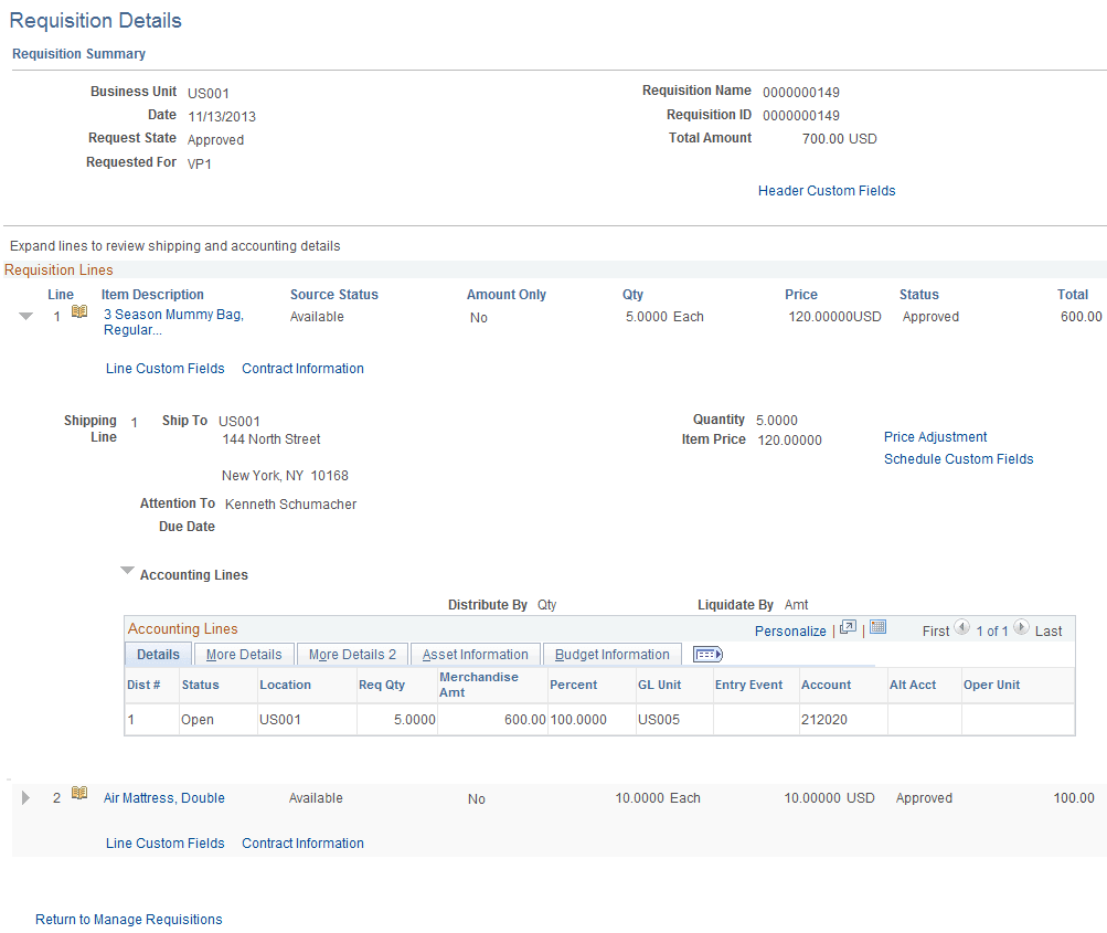

Use Requisition Details page (PV_REQ_PO_DTLS) to view details about individual requisitions. The PO Information header appears only if a PO was created for the requisition.
Navigation:
To access the Requisitions Details page (Click the Req ID link on the Manage Requisitions page).
This example illustrates the fields and controls on the Requisitions Details page. You can find definitions for the fields and controls later on this page.
This example illustrates the fields and controls on the Custom Fields for Line 1 page.
Field or Control |
Description |
Header Custom Fields |
Click to view the Custom Fields for Header page that opens in a pop-up window. The custom field values appearing on this page are display only. |
Click this icon to access the Line Attachments page where you can view the attachments to this requisition. |
Line Comments |
Displays any comments added at the requisition line-level. See Line Comment Page. |
Item Description |
Click the hyperlink to view the item's detailed description. |
Source Status |
View the stage of the requisition line in the sourcing process. Values include:
Amount Only |
A Yes indicates that this line is for an amount value only. The quantity will be 1, and only one schedule line will be available. |
Original Substituted Item |
Displays the original Item ID on the transaction line that was replaced when a Substitute Item was found. Once the field is populated, the original Item ID will not be overridden with another Item ID. If the Item ID field is changed directly by the Requester or Buyer, the Original Substituted Item field is cleared. Similarly, if the Supplier ID/Location field is changed by the Requester or Buyer, then the value in the Original Substituted Item field is cleared and the value is moved back to the Item ID field. |
This icon helps the Requester or Buyer to know whether the item has been substituted. This appears on a transaction line whenever the Original Substituted Item field is populated. If Original Substituted Item and Description fields are already displayed in the component, i.e. Requisition and PO, a text ‘Substitute Item in Use’ will appear. |
Description |
Displays the item description for the Original Substituted Item, if the field is populated. |
Sourced from Inventory |
Click the Sourced from Inventory button to access the Requisition to MSR List page, where you can view stock request information. This button only appears if the requisition line item is defined as an inventory item in PeopleSoft Inventory on the Item Definition - General : Common page. |
Requisition Schedule and Distribution |
Click this link to access the Requisition Detailed Summary page, where you can view line details, schedules, and distribution information. Note: If the Amount Only check box is selected in the requisition line and requisition line is associated to Amount Only Work Order schedule, then the Schedule Date, Amount, currency fields are displayed. The Schedule Date, Amount, Currency fields are from WO schedule not from the Requisition. |

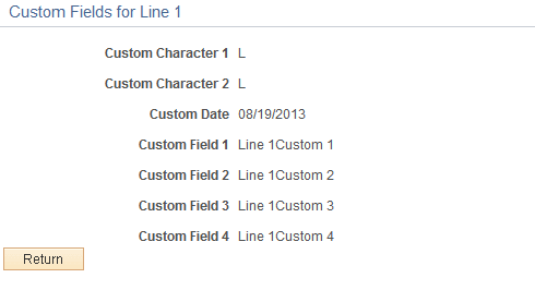

Line Custom Fields |
Click to view the Custom Fields for Line 1 page that opens in a pop-up window. The custom field values appearing on this page are display only. |
Schedule Custom Fields |
Click to view the Custom Fields for Line 1 and Schedule 1 page that opens in a pop-up window. The custom field values appearing on this page are display only. |
Price Adjustment |
Click the link to view price adjustments for the schedule. This link is controlled by users with specific role name and eProcurement role action VIEW_PRICEADJUSTMENTS. |
Ship To |
The location code that indicates the location where the supplier should deliver the items. |
Select this icon to view the Req Schedule One Time Address page (PV_REQ_INQ_ADDR), where you can view a one-time ship to address added to this requisition line when it was added or edited. The One Time Address icon is not visible if the user is linked to the eProcurement role action of NO_ONETIME_SHIPTO. |
Due Date |
The date the requester would like the items to arrive at the Ship To location. |
Ship Via |
Displays the Ship Via Code value. Note: This field is visible only if SHIPVIA_FREIGHT_DISPLAY role action is enabled. |
Freight Terms |
Displays the Freight Terms Code value. Note: This field is visible only if SHIPVIA_FREIGHT_DISPLAY role action is enabled. |
Select this icon to access the ShipTo Attachments page, where you can view the attachments to this requisition at the Ship To level. See Header Comments Page. |
Click the Schedule VAT icon to access the VAT Information for Schedule page, where you can review value added tax (VAT) information for the schedule line. The icon does not appear when the Calculate VAT on Req check box at Purchasing business unit level is not selected, the purchasing business unit is not in a VAT environment , or the VAT_DETAILS eProcurement role action is not used and the user eProcurement role is not added to the user ID profile. Using this page, you can override the recovery percentage and rebate percentage, and recalculate or reset VAT defaults changes that are made to VAT determinants. See Understanding VAT. |
Ship To Comments |
Displays comments added to this requisition at the ship to level. See Header Comments Page. |

PO Information
This link appears if the requisition item is sourced to PO. Click this link to view the PO information that opens in a secondary page.
Field or Control |
Description |
Receipt Status |
Displays the receipt status for this PO. Values include: PO Not Received: No quantities for this PO line have been received. PO Partially Received: Part or all quantities for this PO line have been received. Even if the quantity is fully received, the status does not change until you run the Match Request process in PeopleSoft Payables. PO Received: All quantities for this PO line have been received. Run the Matching process (AP MATCHING) in PeopleSoft Payables. |
View Receipt |
Click the View Receipt button to access the Receipt For a Casual User page. This button appears if a receipt was recorded for this line. |
Accounting Lines — Details
Field or Control |
Description |
Dist # (distribution number) |
Displays the number the system assigns to this distribution. The system uses this numbering to distinguish between multiple distributions for a single requisition line. |
Status |
Distribution statuses include: Open: The distribution line is open. Complete: The distribution line is closed. Processed: The distribution line has been processed and is unavailable for sourcing. Canceled: The distribution has been canceled. |
Distribution Type |
Displays the distribution type that was selected for the requisition line. Values are Labor and Expense. |
Click the Distribution VAT icon to access the VAT Information for Distribution page, where you can review value added tax (VAT) information for the distribution line. The icon does not appear when the Calculate VAT on Req check box at Purchasing business unit level is not selected, the purchasing business unit is not in a VAT environment, or the VAT_DETAILS eProcurement role action is not used. Using this page, you can override the recovery percentage and rebate percentage, and recalculate or reset VAT defaults changes that are made to VAT determinants. See Understanding VAT. |
Accounting Lines — More Details
Access the Accounting Lines — More Details tab.
Select the More Details tab.
This example illustrates the fields and controls on the Accounting Lines — More Details page.
Along with viewing accounting information, you can access projects. Click the Projects link to view and update projects and activities.

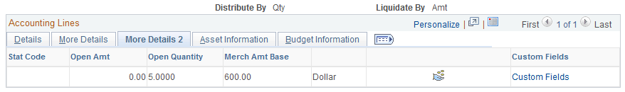

Accounting Lines — More Details 2
Access the Accounting Lines — More Details 2 tab.
This example illustrates the fields and controls on the Accounting Lines — More Details 2 page. You can find definitions for the fields and controls later on this page.
Field or Control |
Description |
Stat Code (statistics code) |
Displays the code used to maintain statistical amounts to facilitate financial analysis and reporting. You can track a variety of non-monetary amounts with statistics. |
Open Amt (open amount) |
Displays the amount that is still open on the requisition that is not sourced to the purchase order(s) when the requisition is distributed by amount. |
Open Quantity |
Displays the quantity that is still open on the requisition that is not sourced to the purchase order(s) when the requisition is distributed by quantity. |
Base Amt (base amount) |
Displays the monetary value for this distribution line. The value appears in the base currency for the business unit. The currency type also appears with the value. If the currency is different than the base currency, an exchange rate also appears. |
Click to view the exchange currency information and the exchange rate. |
Custom Fields |
Click to view the Custom Fields for Line 1 and Schedule 1 and Distribution 1 page that opens in a pop-up window. The custom field values appearing on this page are display only. |
Accounting Lines — Asset Information
Access the Accounting Lines - Asset Information tab.
This example illustrates the fields and controls on the Accounting Lines - Asset Information page. You can find definitions for the fields and controls later on this page.
Field or Control |
Description |
Asset Mgmt Bus. Unit |
Displays the Asset Management Business Unit. |

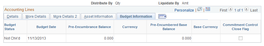

Accounting Lines - Budget Information
Access the Accounting Lines - Budget Information tab.
This tab is hidden if Commitment Control for Purchasing is not enabled.
This example illustrates the fields and controls on the Accounting Lines - Budget Information page. You can find definitions for the fields and controls later on this page.
Field or Control |
Description |
Budget Status |
When Commitment Control for purchasing is enabled, displays the distribution line results after budget checking is initiated. Values for the field include:
Budget Date |
Displays the date used by commitment control to determine the budget period to which this control budget belongs. |
Pre-Encumbrance Balance |
Displays the pre-encumbrance balance for this requisition distribution after it is successfully budget checked. Click the Pre-Encumbrance Balance amount hyperlink to view requisition accounting entries for this distribution only. You can use this page to view accounting information details including the commitment control ledger group and transactions that have been performed against this requisition distribution. When this requisition line and distribution is sourced to a purchase order and budget checked, commitment control liquidates the pre-encumbrance balance from this requisition distribution and establishes an encumbrance for the purchase order. |
Currency |
Displays the currency code for the pre-encumbrance amount at the distribution level of the requisition. The currency code is based on the commitment control ledger group for the distribution level General Ledger business unit. |
Pre-Encumbrance Base Balance |
Displays the pre-encumbrance balance in requisition base currency. |
Base Currency |
Displays the base currency of the pre-encumbrance balance on the business unit. |
Commitment Control Close Flag |
Displays as selected when the Purchase Order associated with the requisition is finalized for less, thus indicating that the outstanding pre-encumbrance has been fully liquidated. This flag also displays as selected when the requisition distribution has been canceled. When the requisition is closed and remaining pre-encumbrance amount liquidated on the budget, this flag displays as selected on the requisition distribution. |

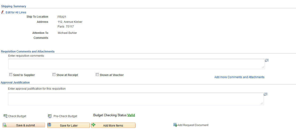

Use the Edit Requisition-Review and Submit page (PV_REQ_CHECKOUT) to edit requisition information.
Navigation:
Select Edit in the Select Action field on the Manage Requisitions page. Click the Go button.
This example illustrates the fields and controls on the Edit Requisition - Review and Submit page. You can find definitions for the fields and controls later on this page.
If you add an additional line to an existing requisition, the new line is numbered as the last line of the requisition.
Most field descriptions for the Edit Requisition component are located in the Creating Requisitions section. In the Edit Requisition component, some additional fields appear; these fields are discussed below.
If chunking is enabled, then requisition lines in the first chunk will appear and chunking navigation will be visible on this page.
See Requisition Settings Page.
Field or Control |
Description |
First <#> to <#> of <#> Last |
Displays the number of requisition line rows that are displayed on the page if requisition chunking is enabled. For example, if 21 to 30 of 30 is displayed. It means that the system is displaying the first 20 lines on the page and that there are a total of 30 lines. The number of requisition lines is determined by the requisition value entered on the eProcurement Installation Options page. When clicking on the > or the Last link to retrieve a new set of lines, the system warns you that the requisition will be automatically be saved prior to retrieving the next set of lines if they are changed. Note: These chunking navigation links appear only when editing an existing requisition. They are not displayed during add mode. |
Track Batch |
Displays the track batch (change batch) sequence number. This field only appears if you have changed a field marked for track change on the requisition change template. The first time that you save a changed requisition, the system displays Track Batch 1 in the requisition header. Each time that you make a change to the requisition, the system increases the track batch number by one. The track batch sequence number appears on the View Requisition Change Tracking History page to distinguish one change from another change and from the original field value. |
First, <, >, and Last |
The First, arrow icons (<,>), and Last links appear if requisition line chunking has been enabled on the eProcurement Installation Options page using the Requisition field. Requisition chunking splits the requisitions lines of a large requisition into more manageable groups, such as 10 lines per chunk. The number of requisition lines displayed is determined by the requisition value entered on the eProcurement Installation Options page. The chunking links enable you to move between chunks and they appear only when editing an existing requisition and not when creating a requisition. They are not hidden on the Requisition page when the total number of lines equals or is less than the chunking limit until you click the Save for Later button. When clicking the > or the Last link to retrieve a new set of lines for the first time, the system warns you that the requisition will be automatically saved before retrieving the next set of lines. This enables the system to save any changes made to the first chunk of lines. The warning message will not be issued during subsequent navigation between chunks, and it appears only once per session. |
The Sourced to Purchase Order icon displays to the right of the Line number and indicates that the requisition line has been sourced to a purchase order line. If the line has not yet been sourced to a purchase order, no icon appears. |
The Unavailable for Edit icon displays to the right of the Line number and indicates that the requisition line cannot be changed. Users cannot edit requisition lines when:
Click the Details button to access the Line Details (PV_REQ_LINE_DTLS) page to change requisition line details. |
Click to have the system recalculate and update VAT amounts for the requisition. |
VAT Amount (value added tax amount) |
Displays the amount of value added tax (VAT) calculated on a VAT-enabled requisition. It does not appear when the Calculate VAT on Requisition check box at Purchasing business unit level is not selected, the purchasing business unit is not in a VAT environment, the VAT_DETAILS eProcurement role action is not used, and the user eProcurement role is not added to the user ID profile. In addition, for Purchasing Requisition in a VAT enabled Business Unit, VAT Amount and icon also do not appear when the User ID Preferences - Requisition Authorizations for Allowed Requisition Actions of View/Override VAT Details is not selected. |
Displays the pre-encumbrance balance amount after requisition is successfully budget checked. When you use commitment control, the system deducts each type of financial obligation from the budget and tracks it according to obligation type. This enables you to determine the money that you have committed in pre-encumbrances. The system extracts these values from commitment control tables by passing the business unit, document ID, and other key information that depends on the display. The system displays this field only when commitment control for purchasing is enabled and if the document has been budget checked successfully at least once. In addition, a default commitment detail ledger must be selected on the Ledgers For A Unit – Commitment Control Options page so that the accounting entries can be summarized to display the respective pre-encumbrance balance for the requisition. Pre-encumbrance balance appears in the transaction currency of the requisition and is based on the transaction budget date, general ledger unit, and commitment control ledger group. Pre-encumbrance balance can be partially or fully liquidated from purchase orders. Click the Pre-Encumbrance Balance amount hyperlink to view Requisition Accounting Entries. You can use this page to view accounting information details including the commitment control ledger group and transactions that have been performed against the requisition. |
Delete |
Click to delete selected requisition lines. You cannot delete a requisition line that has been sourced to a purchase order. You cannot use this button to delete a requisition line that has not passed budget checking when Commitment Control is used. |
Current Change Reason |
Click this link to access the Change Reason page, where you can view the reason code and comments attached to a change request. See Change Reason Page. |
Preview Approvals |
Click this link to save the requisition first before a pop-up modal window of the workflow approval map is displayed within Edit Requisition – Review and Submit page if all requisition lines are available for sourcing. It will display a message if one of the requisition lines is sourced to Purchase Order. If the requisition is in add mode, when you click this link, the requisition is automatically saved and a modal window of the workflow approval map within Edit Requisition – Review and Submit page will pop up. |
Save & Submit |
Click to save the requisition and submit it for approval, sourcing, and dispatching to a supplier. |
Save for Later |
Click to save the requisition for later review or submission. |
Use the Requisition Details for <Requester> page (PV_REQ_CANCEL) to cancel a requisition.
Navigation:
On the Manage Requisitions page, select Cancel in the Select Action field. Click the Go button.
This example illustrates the fields and controls on the Cancel Requisition. You can find definitions for the fields and controls later on this page.
Click a line item link to review the details of that line item.
Field or Control |
Description |
Cancel Requisition |
Click to cancel a requisition. You can cancel any requisition for which a purchase order is not already submitted. |
