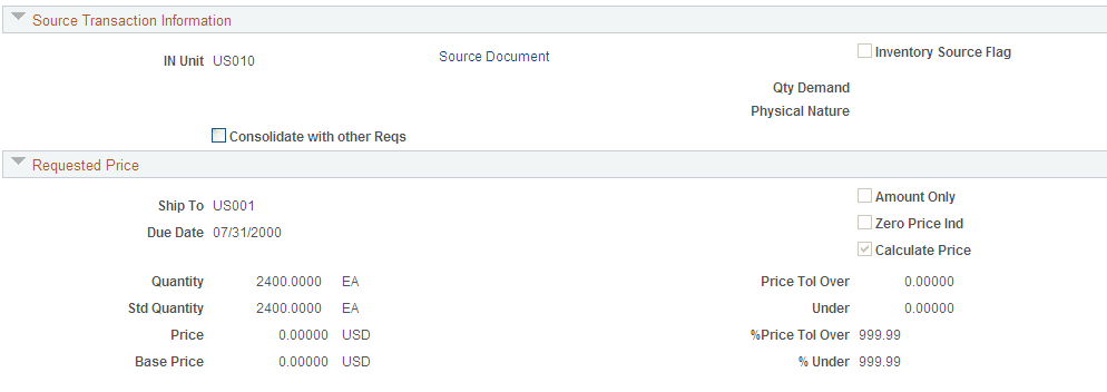

Field or Control |
Description |
% Price Tol Over and %Under |
Displays the tolerance percent price over and under. This tolerance percent is applied to the suggested price on the requisition and used in the PO Calculations process. If the purchase order price is outside of the tolerance, the PO Calculations process rejects the staged row. |
Amount Only |
If this check box is selected, the receipt is based on an amount, not a quantity. In an amount-only transaction, the price is set to 0 and the quantity is 1. |
Base Price |
Displays the price expressed in the base currency. |
Calculate Price |
If this check box is selected, the PO Calculations process calculates a price. If this check box is clear, the staged row price is used on the purchase order. |
Due Date |
Displays the due date for the purchase order. This is the date the items are due at the ship to location. |
Instance |
Displays the process instance of the PO Calculations process that last updated this row. |
Location |
Displays the Supplier location. |
LT Days (lead time days) |
Displays the lead time period between submitting the purchase order to the receipt of goods. |
PO Stg ID/PO Stage ID |
Displays the PO Stage ID. This is the same as the requisition ID when the PO stage type is R. It is taken from INSTALLATION_PO.LAST_PO_STG_ID when the PO stage type is O. |
PO Stg Type/PO Stage Type |
Requisition for the AutoSelect Requisitions process or online requisition selection when the Define PO check box is not selected. The system uses Other for any other process. |
Price |
Displays the requisition price for the item. |
Price Tol (price tolerance), Over, and Under |
Displays the tolerance amount applied to the suggested price on the requisition and used in the PO Calculations process. The PO Calculations process calculates the correct price for a purchase order based on the item prices plus or minus any price adjustments. The sourcing unit price tolerance is applied to the suggested price on the staged row and is compared with the calculated purchase order price. If the purchase order price is outside of the tolerance, the PO Calculations process rejects the staged row. |
Std Quantity (standard quantity ) |
Displays the requisition quantity expressed in the standard unit of measure for this item. |
Quantity |
Displays the requisition quantity being sourced to the selected supplier. |
Requisition ID |
If this row came from a requisition, the ID of the requisition appears. |
Sched Num (schedule number) |
Displays the schedule number on the original request. |
Ship To |
Displays the location where the items are being shipped. |
Src Method (sourcing method) |
Displays the sourcing method for this row. It determines how the supplier is selected for this line. Sourcing method appears by default from the item category or item ID. Values are Basic, Flexible, Sched Split (schedule split), and Cumulative Split. |
Stg Status (stage status) |
Displays the status of the staged row. |
Sys Source (system source) |
Displays the source of the purchase request. Values include Planning, Production, or PO Online (purchase order online). |
Unit |
Displays the business unit of the purchase request. |
Use This Supplier |
Select the supplier to use for this order. When there are multiple eligible suppliers, select the corresponding check box for the supplier of your choice. When you change the supplier, the Let POCalc Override Supplier check box on the Sourcing Workbench - Sourcing Details page is cleared to ensure that the PO Calculations process does not choose a different supplier. If you change the supplier on the Eligible Suppliers page or Flexible Sourcing page, you must rerun the PO Calculations process. |
Supplier |
Displays the supplier to whom the row has been sourced. |
Zero Price Ind (zero price indicator) |
If this check box is selected, indicates that the price for this item is zero. |

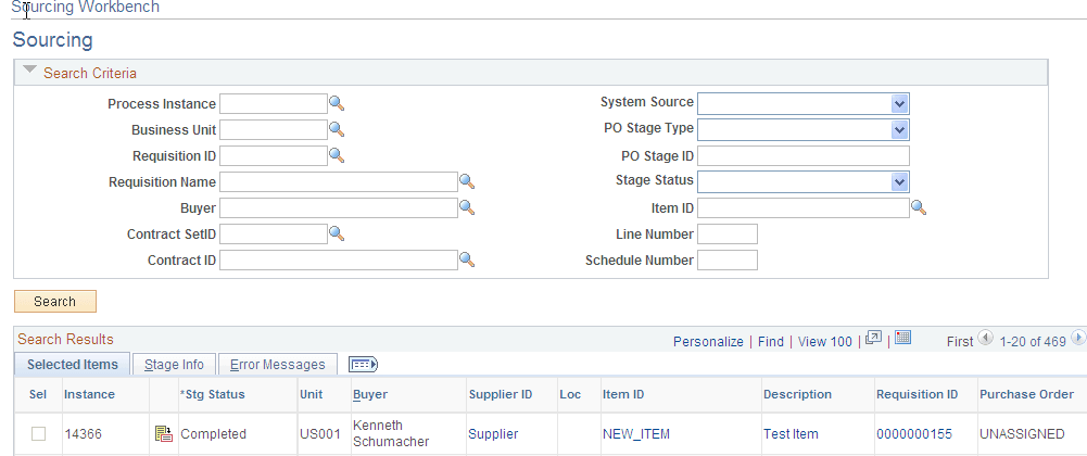

Use the Sourcing Workbench - Sourcing page (PO_SRC_ANALYSIS) to select sourcing criteria and view the rows of data on the PO_ITM_STG table.
Use pages to change the recommended supplier, quantities sourced to each supplier, or correct errors. Along with narrowing the search to specific criteria such as process instances, requisition IDs, purchase order ID, stages, and statuses, you can also search for specific contract SetIDs and contract IDs.
Navigation:
This example illustrates the fields and controls on the Sourcing Workbench — Sourcing. You can find definitions for the fields and controls later on this page.
Use this page to define the criteria that you want to use to view or update a purchase order line and its sourcing details. After defining search criteria, click the Search button to view the search results based on the criteria. The system provides the search results in the lower porting of the page and you can click on links to view vendors, items, requisition, and purchase order details. You can also select the Stage Info tab to view additional details about the staged line, including for example, the contract SetID, contract ID, and contract line if the row is associated with a contract. Finally, you select the Message tab to view messages for a row of data when its stage status is Error.

After defining selection criteria, click the Search button and the system returns the item data rows that match the criteria.
Sourcing Workbench Search Results
The system displays the search results on the Selected Item, Staged Rows, and Message tabs. Using the tabs you can link to a variety of information about the staged item. Select the Sel (select) check box to mark a specific row of data for processing. You can only select the field if the row of data is available for updating.
Along with linking to staged row details, you can use this page to purge and recycle multiple rows in a staged status. You can only perform the recycle and purge actions against those rows of data that have not been greyed out. When the staged status for a row is in a status that cannot be recycled or purged, the system provides error messages when you attempt to set the row for purging or recycling.
After making your selections and clicking the Purge or Recycle button, click Save. The system applies the changes. When you select rows, but the system does not apply an action to the rows, the system deselects the rows after you perform the action.
Note: The system does not issue error messages for actions taken on multiple rows. Messages are only issued for single row changes.

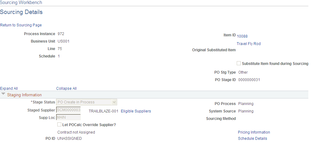

Use the Sourcing Workbench - Sourcing Details page (PO_SRC_ANLSYS_DTL) to view further details about a staged row and how to change the supplier and stage status.
Navigation:
Click the Sourcing Details button on the Sourcing Workbench - Sourcing page.
This example illustrates the fields and controls on the Sourcing Workbench - Sourcing Details page (1 of 2). You can find definitions for the fields and controls later on this page.
This example illustrates the fields and controls on the Sourcing Workbench - Sourcing Details page (2 of 2). You can find definitions for the fields and controls later on this page.
Field or Control |
Description |
Original Substituted Item |
Displays the original item ID on a procurement transaction that is being substituted. Once an Original Substituted Item is designated for a procurement transaction, it is carried all the way through to the receipt and cannot be changed. (The fieldname is also referred to as Original Item in some cases where the Item may or may not have been substituted.) |
Substitute Item Found During Sourcing |
Indicates whether or not the Substitute Item has been found specifically during the PO Sourcing batch process |
Staging Information
Field or Control |
Description |
Stage Status |
Select a stage status. You can change the stage status from Error to Recycle or to Reset/Purge after you have corrected the error on this row, so that the PO Calculations process can reprocess the staged row. To recycle and purge multiple staged rows of a purchase order, click the Return to Sourcing Page link. If the PO Calculations process fails, change the status from POCALC to Recycle as long as the process is no longer running. If the length of federal award fields exceed the length values defined in the setup, or if you enter values into the PIID and Parent PIID is not defined, then the sourcing workbench stage status shows error. |
PO Process (purchase order process) |
Displays the sourcing process used to place the row of data into the staged table. Examples of the processes include contract purchase order, manufacturing load, and autoselected by the system. |
Staged Supplier |
Select a different supplier. This field is available for entry when the stage status is Staged, Pending (pending approval), Error, or Recycle. An item supplier relationship must exist if the Accept Any Supplier option is N (no) at the business unit or item level. If you are using the Flexible sourcing method and have run the PO Calculations process, all eligible suppliers appear on the Eligible Suppliers page. Choose a supplier on the Eligible Suppliers page by selecting the Use This Supplier option. To make an informed decision about the supplier selection, use the Flexible Sourcing page to view all factors involved in the selection of the recommended supplier by the PO Calculations process. If you change the supplier for a schedule, there are other schedules on the same purchase order line, and the line is priced at the line quantity, the system issues a warning that all schedules must be priced again. If you choose to reprice the schedules, the stage status on each one changes to Recycle. When you change the supplier, the Let POCalc Override Supplier check box is clear, to ensure that the PO Calculations process does not choose a different supplier. |
Supplier Loc (supplier location) |
You can enter a different supplier location under the same circumstances that you can change the supplier for this staged row. |
Let POCalc Override Supplier |

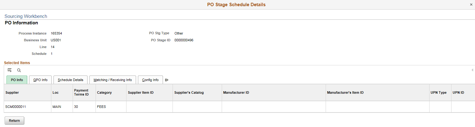

Schedule Details |
Click this link to access the Sourcing Workbench - PO Information page where you can view details about the purchase order that is going to be created. See Sourcing Workbench - PO Information (purchase order information) Page. |

Source Transaction Information
Field or Control |
Description |
IN Unit (inventory unit) |
Appears if this transaction is created through the PO Stage Load process. This is the PeopleSoft Inventory business unit from planning or manufacturing. |
Source Document |
Click this link to access the transaction from which this line originated. If this line is sourced from a requisition, selecting the link accesses the requisition. |
Inventory Source Flag |
If this row is to be sourced from PeopleSoft Inventory rather than onto a purchase order, this check box is selected. |
Qty Demand (quantity demand) |
Quantity sourced from inventory demand through the Build Inventory Demand process. This quantity is always in the item's standard unit of measure. |
Physical Nature |
Displays whether the type of item is a goods or service item. |
Consolidate with other Reqs (consolidate with other requisitions) |
Appears selected if the row originated from a requisition configured to allow the row to be consolidated onto the same purchase order with other rows meeting select criteria, such as having the same item or supplier. The consolidation takes place during the PO Calculations process. |
Note: Source information does not appear if the system source is Maintenance Management (WM).
Procurement Card For Payment
This group box will only appear if you are using a procurement card as a payment method for the purchase order.
Field or Control |
Description |
Card Number, Card Type, and Expiration Date |
Displays the procurement card information that will be used for payment on the purchase order. |
Requested Price
Field or Control |
Description |
Amount Only |
Indicates that the source requisition has a requisition line specified as amount only. If this check box is selected, the Consolidate with other Reqs and the Inventory Source Flag check boxes are not available for entry. |
Indicates that the line item is zero-priced. |
Calculate Price |
Indicates that the PO Calculations process recalculates the sourced purchase order price based on the supplier selected. If this check box is deselected, the requisition price is the purchase order price. |
Message |
A plain text warning or error message appears if the stage status is either Error or Warning. |

Use the Sourcing Workbench - PO Information (purchase order information) page (PO_STG_SCHED_DTLS) to view details about the purchase order that is going to be created.
Navigation:
Click the PO Schedule Information link on the Sourcing Workbench - Sourcing Details page.
This example illustrates the fields and controls on the Sourcing Workbench - PO Information page. You can find definitions for the fields and controls later on this page.
Field or Control |
Description |
Payment Terms ID |
Identifies the payment terms that appear on the purchase order header. |
UPN Type |
Displays the UPN Type for the PO line. |
UPN ID |
Displays the UPN ID for the PO line. |
GPO Info
Select the GPO Info tab.
Field or Control |
Description |
GPO ID |
Displays the group purchasing organization ID. |
GPO Contract Number |
Displays the group purchasing organization contract number. |
Schedule Details
Select the Schedule Details tab.
Field or Control |
Description |
Freight Terms |
Identifies the freight terms code that applies to the schedules for the purchase order. |
Replenish Code |
Displays the PeopleSoft Inventory replenishment code for this distribution. |
Inspect |
If this check box is selected, indicates that inspection is required for the line. |
Matching/Receiving Info
Select the Matching/Receiving Info tab.
Field or Control |
Description |
Unit Price Tolerance and % Unit Price Tolerance |
Indicates the amount and percentage variation allowed in the unit price of this item when matching the purchase order, voucher, and receipt. |
Ext Price Tolerance (extended price tolerance) and % Ext Price Tolerance |
Indicates the amount and percentage variation allowed in the extended price of this line when matching the purchase order, voucher and receipt. Extended price is the quantity ordered multiplied by the item unit price or the item supplier UOM price. |
Rjct Ovr % (reject over percent) |
Receiving cannot accept a shipment from the supplier that exceeds this percentage of quantity over shipped. |
Receiving Required |
Displays the receiving requirement for the item. Values are:
Early Ship Rjct Days (early ship reject days) |
Receiving cannot accept a shipment that is received early by the number of days indicated by this value. |
Config Info (configuration information)
Select the Config Info tab.
Field or Control |
Description |
Template |
The configuration code template ID appears if the item is a configured item. |
Config Code (configuration code) |
If this is a configured item, the configuration code appears. |
