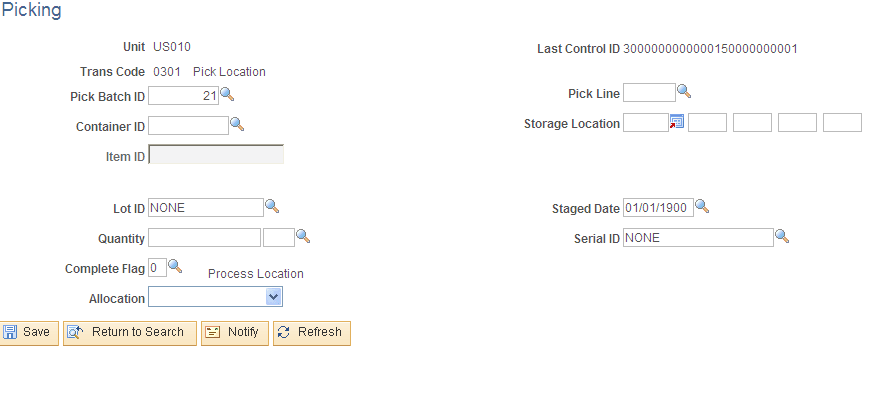

BCT_INV_PICKING |
Enter picking feedback using an electronic data collection system. |

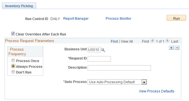

BCT_INV_REQPICK |
Define run control parameters for the Inventory Picking process (IN_FUL_PFB). This run control page process both the INVENTORY_PICKING and SHIPPING_NOTIFICATION transactions. |
Use the Picking page (BCT_INV_PICKING) to enter picking feedback using an electronic data collection system.
Navigation:
This example illustrates the fields and controls on the Picking page. You can find definitions for the fields and controls later on this page.
Note: The business unit defaults established on the Inventory Display Options page govern whether lot, serial, staged date, and configuration fields appear upon entry to this page. Any fields for which the default flag has been set to Yes always appear. Any fields for which the default is No appear when you save or refresh the page, and only if they apply to the item in question.
Field or Control |
Description |
Pick Line |
This field is unavailable for the Complete Pick Batch transaction. |
Container ID, and Storage Location |
For the Pick Location transaction, enter the storage location or container from which to pick. Note: The business unit's default display options determine how many storage location levels appear upon entry to this page. If you are entering a storage location that requires additional levels, enter the storage area, then refresh the page to display the remaining levels for that area. |
Item ID |
This field is available only for the Pick Location transaction. The item ID appears automatically, based on the pick batch and pick line information. If substitutes are permitted for the order line, you can select a substitute item. |
Quantity |
For the Pick Location transaction, enter the quantity and UOM to be picked. If the UOM Conversion Flag specifies using the entered UOM, select a stocking UOM; if the conversion flag is set to convert the entered UOM to the standard UOM, enter any valid UOM for the item. |
Complete Flag |
Indicates that a pick batch line is ready to be processed and informs the system how to process the pick batch or pick batch line. The default value is 0 for the Pick Location transaction, 1 for the Complete Pick Batch Line transaction, and 2 for the Complete Pick Batch transaction. 0 - Process Location: No additional processing is required, and the line is left open. This entry is only valid for the Pick Location transaction. 1 - Pick Line Complete: The pick batch line is processed using only the quantities entered on Pick Location transactions for this line. If the line does not have a Pick Location transaction processed against it, it is cleared from the picking plan and becomes eligible to be placed on a new picking plan. On a pick batch ID with allocations created, any allocations that have not been confirmed by Pick Location transactions are brought to 0. If the full quantity ordered for the line was not picked, and if the cancel back order option for the line is not active, a back order is created upon shipment. This is not a valid entry for the Complete Pick Batch transaction. 2 - Pick Batch Complete: All demand lines that do not have Pick Location transactions processed against them are cleared from the picking plan. These lines are eligible to be placed on a new picking plan. Demand lines that have Pick Location transactions entered against them are handled in the same manner as Pick Line Complete lines. On a pick batch ID with allocations created, any allocations that have not been confirmed by Pick Location transactions are brought to 0. If the full quantity ordered for the line was not picked, and if the cancel back order option for the line is not active, a back order is created upon shipment. 3 - Pick Line as Planned: On a pick batch ID with allocations created, the line is processed as planned, provided that no Pick Location transactions have been entered against the line. This entry is only valid for the Complete Pick Batch Line transaction. 4 - Pick Batch as Planned: On a pick batch ID with allocations created, all lines without Pick Location transactions entered against them are processed as planned. Demand lines for which Pick Location transactions have been entered are handled in the same manner as Pick Line Complete lines. |
Allocation |
For transaction code 0301, this field indicates the type of allocation applied to the demand line. This value is stored in the ALLOCATE_SOURCE field of the DEMAND_PHYS_INV record. The options are:
When you save the page, PeopleSoft Inventory inserts the transaction into the transaction log and clears the page, so you can enter a new transaction.
Use the Inventory Picking (process) page (BCT_INV_REQPICK) to define run control parameters for the Inventory Picking process (IN_FUL_PFB).
Navigation:
This example illustrates the fields and controls on the Inventory Picking process page. You can find definitions for the fields and controls later on this page.
This page is used to process the INVENTORY_PICKING transactions.
