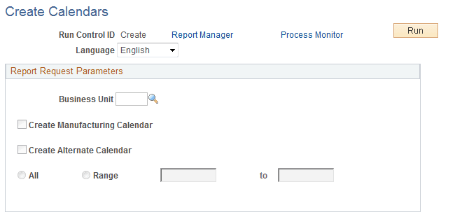

Use the Create Calendars page (RUN_MGS3000) to update the system with new calendar codes or calendar information.
Navigation:
This example illustrates the fields and controls on the Create Calendars page. You can find definitions for the fields and controls later on this page.
Report Request Parameters
Field or Control |
Description |
Create Manufacturing Calendar |
Select to create a new version of the default production calendar. |
Create Alternate Calendar |
Select to create a new version of one or more alternate calendars. If you are creating the manufacturing calendar, the Create Alternate Calendar check box is automatically selected. |
All and Range |
Specify the alternate calendars that you want to create. |
Run |
Click to run this request. PeopleSoft Process Scheduler runs the Create Calendars process at user-defined intervals. |
