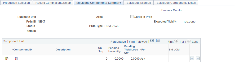

Use the Edit/Issue Components Summary page (SF_EDIT_COMPS_EDIT) to edit or view components.
In addition, use this page to edit or issue components during the Record Completions and Scrap process or after the Record Completions/Scrap process has been run.
Navigation:
if you are editing or issuing components during the completions process
if you are editing or issuing components after you've recorded completions and scrap
This example illustrates the fields and controls on the Edit/Issue Components Summary page . You can find definitions for the fields and controls later on this page.
Field or Control |
Description |
Print at Save |
Select this check box if you want to print production documents for a particular production ID at save time. |
Setup Print Options |
Click this link to access the Process/Output Options page to select different print criteria for the production documents. |
Click the Express Page button to access the Edit/Issue Express page to view or assign serial and lot numbers. |
Click the Detail button to access the Edit/Issue Component Detail page. |
Click the Item Search button to access the Item Search, Item Availability, or Item Substitution pages. |
Op Seq (operation sequence) |
Determines the WIP inventory location to which the components are issued and from which they are consumed. When you add a new component to the component list, the operation sequence defaults to zero. When recording end item completions and scrap, the system consumes a component with an operation sequence of zero at the first operation and decrements the component quantity on hand in the production area's default WIP location. You can change the operation sequence to any valid operation on the end item's operation list. When you select an operation sequence, the component must be issued to and is consumed from the WIP location associated with the operations work center. |
Per |
Indicates whether the quantity required is per assembly (Asy) or per order (Ord). Per assembly indicates the quantity required to complete one end item. Per order indicates the amount required, regardless of the end items that will be produced.
Pending Issue Qty (pending issue quantity) |
The system calculates this value for those components whose operations have had end item completions or scrap reported. Enter a new pending issue quantity if you consumed more or less than the quantity calculated. The pending issue quantity is based on the quantity completed plus the quantity scrapped multiplied by the quantity per assembly. If the quantity on the component list is expressed in terms of quantity per order, the full quantity appears. This quantity is consumed only at the time of the first backflush for production ID. For production schedules, the Calc Per Order for Production Schedules option on the Manufacturing Business Unit Option page determines how the quantity is displayed. If you have enabled PeopleSoft Workflow, the system sends a notice to the production supervisor that there is a nonzero quantity for this component. PeopleSoft Manufacturing uses the Identify Production with Pending Quantities workflow for this notification.
Pending Yield Loss Qty |
If the quantity of components lost is more or less than planned, indicate the new pending yield loss quantity here. If the item's yield loss is set to calculate the pending yield loss quantity, then the system calculates the pending yield loss for those components whose operations have had end item completions or scrap reported. You define whether or not you want the system to calculate pending yield loss quantity at the business unit or item level. If you do not want the system to calculate pending yield loss quantity, then you manually record the yield loss at the appropriate times. The system uses this formula to calculate the pending yield loss quantity: (Quantity Completed + Quantity Scrapped) x Expected Yield Loss Percentage Expected Yield Loss Percentage = (1 - Component Yield / 100) |

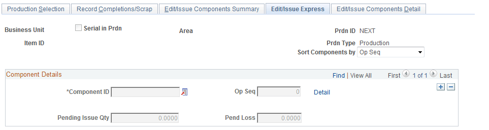

Use the Edit/Issue Express page (SF_EDIT_COMPS_EXPR) to (Optional) Select lot- or serial-controlled components that have pending issue or pending loss quantities.
You can view or change lots assigned to lot-controlled components by the backflush lot selection rule.
Navigation:
Click the Edit/Issue Express link.
Click the Edit/Issue Express link on the Edit/Issue Components Summary process page.
This example illustrates the fields and controls on the Edit/Issue Components - Edit/Issue Express page. You can find definitions for the fields and controls later on this page.
Field or Control |
Description |
Component Details |
You can change any of this information on this page:
Use the Lot/Serial Number Selection page (SF_ED_CMP_SBP_GRD) to (Optional) Select the lot or serial numbers or both of the lot- or serial-controlled components to be consumed during the completions process.
You must enter a pending quantity greater than zero for a serial-controlled or lot-controlled component before the Lot/Serial scroll area is available.
Navigation:
Click the Select Lot/Serial link.
Field or Control |
Description |
Sel (select) |
Select the serial-numbered components that you want to consume by selecting one or more check boxes. |
Access the Lot/Serial scroll area on the Edit/Issue Express page
Field or Control |
Description |
Lot ID |
Select a lot if you're editing or issuing lot-controlled components. You can view or change lots assigned by the backflush lot selection rule. |
Qty Req (required quantity) |
Specify the amount of components that you want to consume from each lot. This field can be automatically populated during backflush using the backflush lot selection rule. |

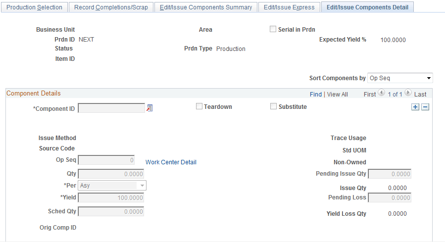

Use the Edit/Issue Components Detail page (SF_EDIT_COMPS_DET) to view detailed information for each component for selected production.
Navigation:
Click the Detail button next to the component you want to edit or view.
This example illustrates the fields and controls on the Edit/Issue Components Detail page. You can find definitions for the fields and controls later on this page.
Component Details
Field or Control |
Description |
Component ID, Op Seq (operation sequence), Qty (quantity), quantity Per, Yield, and Sched Qty (scheduled quantity) |
Enter or modify values for these fields. |
Work Center Detail |
Click this link to access work center-related information. |
Qty (quantity) |
The calculated quantity per is next to this field. The system calculates the quantity per by dividing the quantity per assembly by the bill of material's BOM quantity. You designate the level of precision for the calculated quantity per on the Manufacturing installation options page. |
Pending Issue Qty (pending issue quantity) and Pending Yield Loss Qty (pending yield loss quantity) |
Although these values appear by default from the Edit/Issue Components Summary page, you can change them here. Note: If you are not completing end items, a pending issue or pending yield loss quantity greater than zero indicates that the components couldn't be consumed from the appropriate WIP location from a previous completions or edit components transaction. This is due to a shortage of the component in the WIP location associated with the component's operation sequence. |
Issue Qty (issue quantity) |
This field represents the quantity consumed that was issued from the WIP location for the component and was charged to WIP. For items using the Kit issue method, this is the quantity that was issued during Material Release of a production Pick Plan or issued using the Issue/Return Kit Components page. You cannot modify kitted components here. This field is used for production IDs only. |
Yield Loss Qty (yield loss quantity) |
This field represents the component quantity that was scrapped during end item completion and issued from the WIP location. This field is used for production IDs only. |
