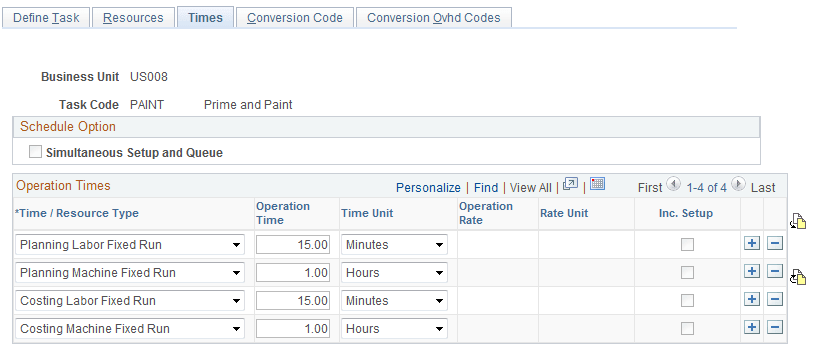

Details - Times |
SF_OP_TIME |
Review or modify an operation's labor or machine planning queue and intransit times as well as planning and costing, setup, run, fixed run, and postproduction times and run rates. |

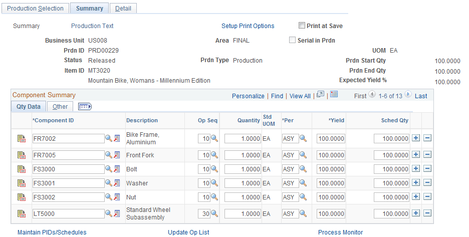

Use the Summary - Summary page (SF_OP_SUMMARY) to add, change, or delete operations on the operation list.
Navigation:
This example illustrates the fields and controls on the Update Operation List- Summary: Summary page. You can find definitions for the fields and controls later on this page.
Field or Control |
Description |
Sort Operations by |
Select End Date, Op Seq (operation sequence), or Start Date. |
Print at Save |
Select this check box if you want to print production documents at save time for a particular production ID. |
Setup Print Options |
Click this link to access the Process/Output Options page to select different print criteria for the production documents. |
Calculate Yield and Reschedule |
When inserting, changing, or deleting an operation, use this link to recalculate the operation quantities and start and due dates. You will be given the option of maintaining the existing start or end quantity and recalculating the other. |

Op Seq (operation sequence) |
Add, change, or delete operations (tasks) on the operation list. You can also change the operation sequence) by renumbering the operations. You cannot delete an operation from the operation list once completions or scrap have been recorded for the operation. Note: You cannot delete a subcontracted operation if a purchase order has been created. |
Click the Add button to add a new operation sequence. The operation can be added in any order. The operations are reordered when you click the Save button. |
Task Code and Description |
Task being performed at the operation step. Select a value if tasks have been predefined in PeopleSoft Manufacturing. Task codes are optional, but they facilitate data entry. |
Work Center |
If no task code is entered, you must select the work center where the new operation will take place. Note: Changing the task code can affect the task times, resources, scheduling options, conversion rates, and the work center. Changing either task information or the work center may result in process change variances in production. Production variances occur any time the cost of the operation differs from the cost of the operation used to determine the item's standard cost. |
Operation Start Date and Operation Due Date |
Changing these values automatically reschedules prior and subsequent operations. To change an operation's start time (if forward scheduled) or due time (if backward scheduled), select the operation to be changed and the appropriate time based on the production ID's scheduling method. If you're changing the operations for a production schedule, change only the due time because all production schedules are backward scheduled. The scheduling method of the production ID or production schedule appears in the Operation Summary header. Note: The system uses the production start quantity of an operation to calculate the scheduled quantities in the component list. For multiple output production IDs, the system uses the production end quantity of the last operation to calculate the quantities for the primary products and co-products in the output list. For by-products, the system uses the production end quantity of the last operation. For multiple output production schedules, the system uses the production end quantity of the last operation to calculate the quantities for the primary, co-products, and by-products in the output list. Note: Changing the production quantity may require the operation start or due dates to change. |
Click this link to see the impact of a date or time or work center change. This recalculates the operations based on the changes made. Using this button without saving the page allows you to create what-if scenarios for the production ID or production schedule. If you add an operation to the first row of the operation list, the production ID or production schedule start date or time appears by default, even when the production ID is backward scheduled. If the production is backward scheduled, the system automatically recalculates the start date or time once you enter the due date or time. If you change the work center for an operation and the current start date or time or due date or time does not fall within the hours of operation for the work center, the system reschedules the date or time to a valid date or time once you click the Calculate Yield and Reschedule link. Valid dates or times are based on the work center calendar if a calendar code has been associated with it. If not, the valid working days are based on the runtime production calendar. If one is not specified, the system assumes a five-day work week with the valid hours of operation based on the shift code specified for the five day work week. Note: If capacity and material availability are concerns, estimate the start and due dates and times when you create or maintain an operation using PeopleSoft Manufacturing, and then optimize the operation's start and due dates and times using PeopleSoft Supply Planning. Important! Change operation list dates one at a time. When one of the dates is changed, the remaining date and time fields are unavailable. To change multiple operations, select the first operation to be changed, enter the changes, and then click the Reschedule button. Once the system reschedules all operations, select the next operation to be changed and continue. |
Save |
Click this button before exiting the page to save the results of the recalculation. |

Operation Type (operation times or run rates) |
These values appear by default from the routing information. These times and rates may have originated from the task, if one is specified, and modified for this particular item. If a task wasn't specified, the times and rates were entered on the routing for the end item. You can modify the planning labor and machine times or rates for fixed run, post production, run, and setup. If a task was specified for the operation, change any of the production times or rates for the task without affecting the master task information. To make changes to the master task, update the operation times and rates using the Task Time page in PeopleSoft Manufacturing. If you're changing the operation costing times and run rates, the change may result in process change variances in production. This occurs when the cost of the operation differs from the cost used to determine the standard cost of the end item. If you're changing the operation from a regular task to a subcontracted one, you cannot select machine times or rates for the operation. |
Op Time (operation time) and Op Rate (operation rate) |
You can modify these values. Use operation rates for runtimes only:
Inc. Setup (include setup) |
Select this option when calculating operation lead times and can only be selected for the Planning Labor Setup and Planning Machine Setup operation types. The check box is not available for selection for all other operation types. The system always includes setup in the lead time calculation for the first operation. If this option is not selected, setup can physically begin prior to any production units arriving at the work center. However, the system calculates the start date and time of the operation to reflect the latest time the setup should begin to meet its due date and time. |
Save |
Click this button if you want to save the results of the recalculation. |
Warning! Queue and intransit planning times as well as setup and post-production planning and costing times are allowed for subcontracted operations. If you're using PeopleSoft Supply Planning, queue and intransit times are ignored.
Field or Control |
Description |
Costing Considerations |
To calculate costs for a particular item, operation, or time type, you must have a corresponding costing rate type defined along with a frozen conversion or conversion overhead rate or cost. For example, if you had a costing labor fixed runtime defined for an item, you should also have defined a labor fixed run rate per hour or per unit within PeopleSoft Cost Management for the conversion code specified on the operation list. |
Costing Operation Time Type |
Include a corresponding value if you intend to cost the operation using a fixed amount per unit, as opposed to a rate per hour. The costing operation time can represent the amount of time to complete the task and the system uses it to calculate earned hours. However, the system uses the amount per unit in calculating the cost, regardless of the time specified. If you do not specify a costing time, the system will not include the per unit cost even if there's a rate defined for the code assigned to the operation. |

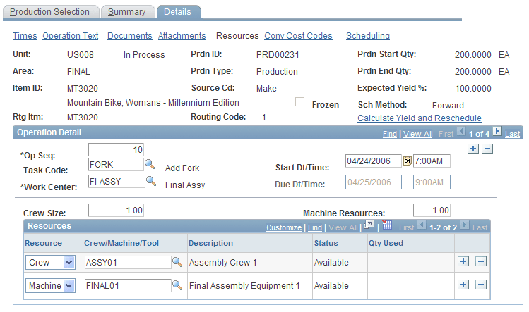

Use the Details - Resources page (SF_OP_RESOURCE) to review or modify the resources assigned to each operation on the operation list.
Navigation:
This example illustrates the fields and controls on the Details - Resources page. You can find definitions for the fields and controls later on this page.
When maintaining the operation list, you can optionally define the crews, machines, and tools that will be used at work centers to perform specific tasks. In addition, keep these in mind when maintaining operation resources:
You cannot associate resources with a Pending status to an operation.
You can have no more than one primary crew, one primary machine, and one primary tool associated with each operation.
You cannot assign crews or machines to a subcontracted operation.
Field or Control |
Description |
Op Seq (operation sequence), Task Code, Work Center, Start Dt/Time (start date and time), and Due Dt/Time (due date and time) |
These values appear by default from the Operation Summary page, although you have the option to change them. If you change the task, the system deletes all task-related information defined for the operation including work center, resources, task times, and scheduling options. The system then adds the new task information to the current operation sequence. If conversion rates are defined at the task level, the system replaces the conversion and conversion overhead rates with the new rates. |
If you change the work center, task, or operation sequence, click this link to update the schedule. To save the results of the recalculation, click the Save button before exiting the page. |
Crew Size, Machine Resources, and Resource Types
You can change the costing resource attributes (crew size and machine resources). These attributes appear by default from the work center. Crew size is the number of people at the work center. The Machine Resources field displays the number of machines at the work center. The system uses both the crew size and machine resources to determine the standard cost of an item. Therefore, if you're changing the operation's crew size or machine resources, the change may result in process change variances for the production ID.
For each operation, the resource information appears by default from the resources associated with the work center that you assigned to the task, and therefore the operation. Only the primary crew, machine, and tools are copied to the operation list. You can enter additional resources (crews, machines, and tools) by selecting a resource type and the specific crew, machine, or tool. The resource's description, status, and, when the resource is a tool, quantity used appears. The resource must already be defined as a primary or alternate resource for the work center. You can also assign resources without assigning a task to the operation.

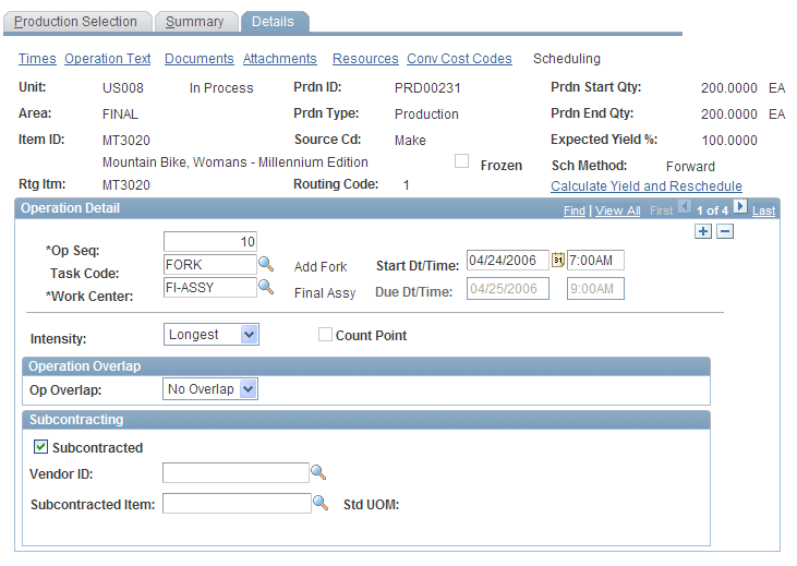

Use the Details - Scheduling page (SF_OP_SCHED) to maintain operation scheduling options.
Several scheduling options can be selected for operations, including simultaneous setup and queue, planning intensity, and operation overlap.
Navigation:
This example illustrates the fields and controls on the Details - Scheduling page. You can find definitions for the fields and controls later on this page.
Field or Control |
Description |
Op Seq (operation sequence), Task Code, and Work Center |
These fields are unavailable if completions or scrap for this operation have been previously recorded. |
Simultaneous Setup and Queue |
Select this option if setup can occur during the queue time of an operation. If you select this option, the system considers the longer of the two times when determining actual production start or due dates. Note: The Simultaneous Setup and Queue check box is not available if the page is displaying the first operation in a routing, if setup is not included for the operation, or if you're using PeopleSoft Supply Planning. |
Count Point |
This option is selected if the operation sequence is a count point. This field is display-only and appears by default from the Summary page. Count points enable you to record completions at predefined operation steps. Material will be consumed and labor and overhead will be earned back to the previous count point. Count points are optional, and are used only on production IDs. |
Frozen Operation |
Displays if the operation has been frozen by PeopleSoft Supply Planning. This check box indicates that a decision was made to hold or firm up the due date and that changes to the operation could result in a change to the operation's start and due dates and times. If the operation is frozen, and you change information that impacts the start/due dates and times, PeopleSoft Manufacturing displays a warning message indicating that the operation is frozen. You have the option to continue or cancel the changes. If you proceed with changing this information, the operation is no longer frozen. |
Intensity |
This value appears by default from the task and determines the basis of the scheduling. The start and due date of the operation can be based on either the operation's labor time (labor intensive) or machine time (machine intensive). Alternatively, the start and due date can be based on the longest (longest of the two times, evaluated for each time type within the operation). For example, if labor setup is 7 minutes, machine setup is 10 minutes, labor run is 20 minutes, machine run is 25 minutes, labor fixed run is 11 minutes, and machine fixed run is 7 minutes, the total operation time would be Machine Setup (10) + Machine Run (25) + Labor Fixed Run (11) = 36 minutes. Or, the start and due date can be based on the cumulative (the sum of the machine and labor time). Make sure that you select an intensity that matches the resource used. For example, if you select Machine Time, you must be using machines to perform all or part of the operation and machine times or rates should have been specified for setup, run, fixed run, or all three. |
Op Overlap (operation overlap) |
Values include:
The default setting for Op Overlap is No Overlap. If you select No Overlap, the Send Ahead and Overlap % fields are not available. Important! If an operation has a fixed run rate assigned to it, the preceding operation cannot have a send ahead quantity assigned to it because fixed run operations assume the entire quantity is available at the beginning of the run. For example, operation 1 cannot have a send ahead quantity assigned if operation 2 has a fixed runtime. |
Subcontracted |
This option is selected if the operation is being performed by a supplier. You cannot deselect this check box if purchase orders have been created for this outside supplier. |
Supplier ID |
If the subcontracted supplier was defined at the task level, then the name of the supplier appears in this field. Otherwise, you can select the appropriate supplier for this subcontracted operation. |
Subcontracted Item |
If this value was defined at the routing level, then the item appears in this field. You can change the value in this field. Note: The subcontracted item will be used on any subcontracted purchase orders that are created for this operation. Note: The UOM for the subcontracted item and the end item must be identical. |
