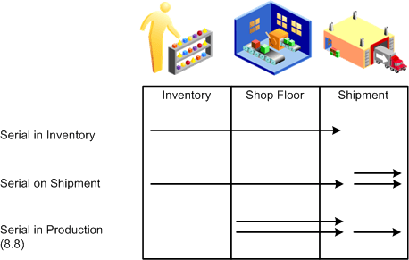

This diagram illustrates PeopleSoft and serial processing prior to Release 8.9

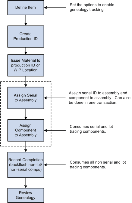

Serial IDs may be associated with the production IDs at any time during the manufacturing process.
For rework or teardown production IDs, you do not manually associate serial IDs to the assembly. The serial association occurs when you issue the assembly that is to be reworked or torn down through the picking process or kit issues.
In addition to associating a serial ID with the assembly item, you can associate component serial IDs with an assembly serial ID.
You can correct errors by disassociating the serial ID from the assembly or disassociating the component from the assembly serial ID.

This diagram illustrates the serial genealogy process flow from setting the options on the item definition, to creating the production ID, issuing material, assigning serial IDs to assembly, assigning components to assembly, recording completions, and reviewing genealogy:
