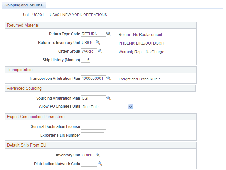

BUS_UNIT_TBL_OM6 |
Enter business unit information relating to returned material, transportation lead time, sourcing, freight, and export options. |

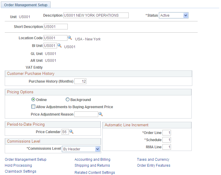

Use the Order Management Definition - Order Management Setup page (BUS_UNIT_TBL_OM1) to establish the general processing structure for an Order Management business unit, such as the link with a Billing business unit, the purchase history that is available for sales order inquiries, the defaults for pricing sales orders, and assignment of a commission level.
Navigation:
This example illustrates the fields and controls on the Order Management Setup page. You can find definitions for the fields and controls later on this page.

Default SetID |
This field appears in Add mode. The unit determines the preliminary tableset sharing setup by determining the SetIDs that are assigned to each record group for the new business unit. The SetID that is assigned to a record group determines which tableset is used as values for that specific business unit. |
Create BU (create business unit) |
When you enter a new unit, click this button to establish the SetID controls for the Order Management business unit. Note: Create SetIDs or business units that are five characters long. A performance degradation occurs if the SetIDs or business units have fewer than five characters. Note: You must click the Create BU button before you can select a Location Code and BI Unit (Billing business unit) on this page and enter information on the other business unit pages. |
Location Code |
Enter or select the location of the business unit. |
BI Unit (Billing business unit) |
Select a value to link with an Order Management business. You can create invoices by Order Management business unit or by Inventory business unit. If you also link a Billing business unit with an Inventory business unit, the Inventory business unit takes precedence. Order schedules that have been shipped, including nonstock items, are pulled into the Billing system for creation of invoices. The process of invoicing is governed by rules associated with the Billing business unit that you enter on this page. These rules determine billing frequency, billing method, and so on. Important! If you choose to invoice by Inventory business unit, you must enter a Billing business unit on the Inventory Definition - Business Unit Definition page. |
GL Unit, AR Unit, VAT Entity (General Ledger business unit), (Accounts receivables business unit), (Value-added tax entity) |
These fields appear after a BI Unit is selected. Although Order Management may interface with PeopleSoft Billing for invoicing, it does not post to PeopleSoft Receivables or PeopleSoft General Ledger directly. Instead, the PeopleSoft Order Management system is tied to a Receivables and General Ledger business unit based on the Billing business unit that is entered here. The Receivables business unit determines which receivable aging periods are included in the credit checking calculations during order entry. The General Ledger business unit determines the VAT entity. |
Automatic Line Increment
In the Automatic Line Increment group box, enter the number that determines the next line, schedule, and RMA line number. For example, if you want order line numbers to increment by one, enter 1 in the Order Line field.
Note: The demonstration database is delivered with the line increment set to 2.
Customer Purchase History
Field or Control |
Description |
Purchase History (Months) |
Enter the number of months of purchase history that you want accessible during order entry. This option enables you to view all previous purchases that the customer makes within a time window and to select previously entered order lines for copying. |
Pricing Options
Field or Control |
Description |
Online |
Select this option to price each schedule and line when the pricing calculator button is selected. Select the Price Protected option on the Line Pricing Data and Schedule Pricing Data pages to prevent the order from being repriced. |
Background |
Select this option to price the order in the background instead of online. The Order Repricing process prices order lines and schedules according to the timetable that is established by using the Process Scheduler. This process also reprices lines and schedules to reflect any quantity changes or price changes that are made after the order is entered. Note: If Background is selected, the system moves the list price to the sales order by default. Price adjustments are not applied until the Order Repricing process runs. |
Allow Adjustments to Buying Agreement Price |
This check box indicates whether the buying agreement price can be adjusted. If selected, only the list price protect flag is turned on, and the buying agreement price will be used as the base for the adjustment calculation. If this check box is not selected, the list price and price protect flags will be turned on, and the price cannot be adjusted. |
Price Adjustment Reason |
Select a default reason code when adjusting the price on the order or quote. This field is useful if you are using margin adjustments and frequently changing prices on the sales order. |
Period-to-Date Pricing
Field or Control |
Description |
Period-To-Date Price Calendar |
Select a calendar if you are using period-to-date price adjustments. Calendars are established on the Sales Calendar page. |
Commissions Level
Select to determine whether commissions are tracked and, if they are, at which level, the header level or the schedule level. This value is the default for orders and quotes during order entry.

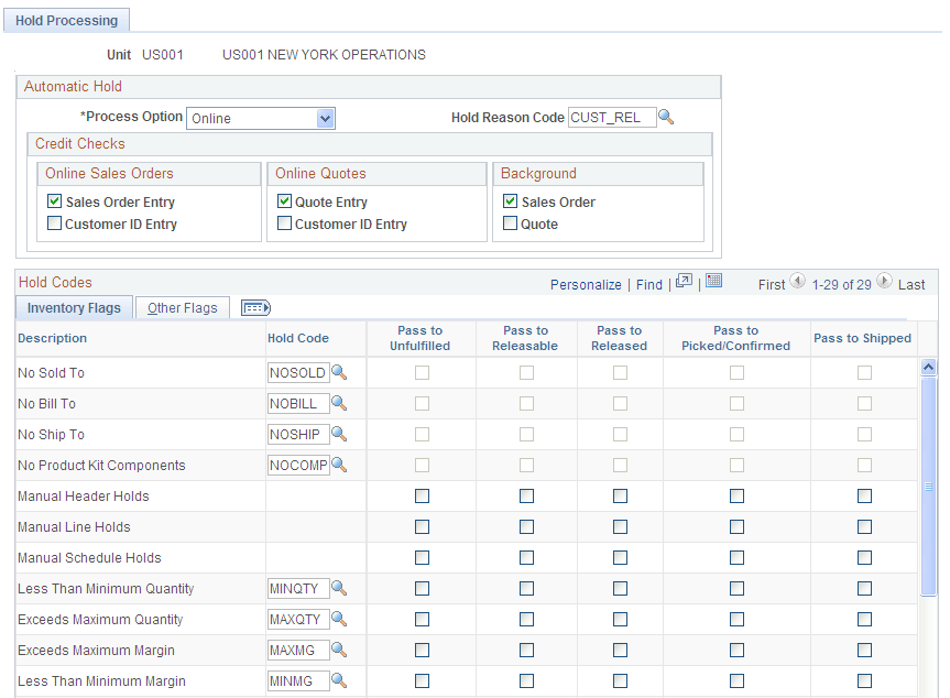

Use the Hold Processing page (BUS_UNIT_TBL_OM2) to enter automatic hold parameters and hold codes for fulfillment processing.
Navigation:
Click the Hold Processing link on the Order Management Setup page.
This example illustrates the fields and controls on the Hold Processing page (1 of 2). You can find definitions for the fields and controls later on this page.
This example illustrates the fields and controls on the Hold Processing page (2 of 2). You can find definitions for the fields and controls later on this page.
Field or Control |
Description |
Process Option |
Select a processing option from the available options. Online: Orders are placed on hold as they are entered when a hold condition exists. Background: Running the Automatic Hold Check Process (OM_HOLD) applies holds. None: No hold processing is performed. Important! A blank field is equivalent to no hold. |
Hold Reason Code |
Select the default reason code for the business unit to use when placing a hold. Establish the codes on the Reason Code page. Select a default reason code for the hold. Values are: Cust Apply: Manually apply customer hold. Cust Rel: Manually release customer hold. Prod Apply: Manually apply product line schedule hold. Prod Rel: Manually release product line schedule hold. System: Holds processed by the system. |
Financial Sanctions Screening |
Select to process Financial Sanctions Screening (FSS), which is defined at the Installation level on the Financial Sanctions Options page. You determine if you are going to perform FSS at the install level or the business unit level. FSS validates customer information with a variety of national and security lists. Hold codes can be established for the order or customer. |
Credit Checks
Field or Control |
Description |
Online Sales Orders |
Select an option to check credit during online entry. Sales Order Entry: Credit is checked every time the order is saved. The system warns you immediately when the order exceeds the credit limit. Customer ID Entry: Credit is checked only when you enter the customer ID for the order. Note: If you enter the orders in pending status, credit is not reevaluated when you change the status to open if you are using the customer entry option. You must run Automatic Credit Check (OM_CREDIT). If you are using the sales order entry option and change the status to open, credit checking is done when the order is saved. Note: Online credit checks use PeopleCode, not the background Automatic Credit Check process. |
Online Quotes |
The same options apply as for sales orders. |
Background |
Select Sales Order or Quote and schedule the Automatic Credit Check process (OM_CREDIT) to run at intervals that make sense in the environment with the Process Scheduler. Note: If you do not enable the Automatic Credit Check process, credit holds must be removed manually. |
Hold Codes
Select the Inventory Flags tab to establish options to prevent processing of demand to PeopleSoft Inventory fulfillment states.
Note: Depending on the type of hold code, some levels in PeopleSoft Inventory may not be available.
Note: Price-related holds will not be placed on the order if the order is from a buying agreement. The price-related holds are Minimum Selling Price, Less Than Minimum Margin, and Exceeds Maximum Margin.
Field or Control |
Description |
Pass to Unfulfilled |
The system passes demand data with this hold condition to the unfulfilled state in PeopleSoft Inventory. |
Pass to Releasable |
The system passes demand data with this hold condition to the releasable state in PeopleSoft Inventory. |
Pass to Released |
The system passes demand data with this hold condition to the released state in PeopleSoft Inventory. |
Pass to Picked/Confirmed |
The system passes demand data with this hold condition to the picked/confirmed state in PeopleSoft Inventory. |
Pass to Shipped |
The system passes demand data with this hold condition to the shipped state in PeopleSoft Inventory. |
Select the Other Flags tab to establish options to prevent processing to PeopleSoft Planning, Purchasing, and Billing
Field or Control |
Description |
Pass to Planning |
Enables the PeopleSoft Supply Planning system to see order demand for consideration in the planning algorithms, even though the order is on hold. |
Pass to Purchasing |
Holds that are placed on direct ship order schedules do not affect processing of the order in PeopleSoft Purchasing. |
Pass to Billing |
Use to define which holds should prevent nonstocked and direct shipped order lines from being billed in PeopleSoft Billing. |
Note: Hold codes must first be established on the Hold Codes page.
Note: Not all options are available for all hold codes.
Field or Control |
Description |
No Sold To, No Bill To, No Ship To, No Product Kit Components |
These fields define missing information holds. The options are set up on the Hold Codes page. Data from orders with these hold conditions cannot be passed to the states in PeopleSoft Inventory until you remove the hold and supply the missing information. |
Manual Header Holds, Manual Line Holds, Manual Schedule Holds |
Determine if the holds applied manually prevent or enable order data transfer to states in PeopleSoft Inventory Note: Keep in mind that the choices that you make on this page determine the effect of all manual holds. |
Less Than Minimum Quantity |
A hold condition occurs at the line level when the quantity is less than the minimum order limit for the product, established on the Product Attributes by UOM page. |
Exceeds Maximum Quantity |
A hold condition occurs at the line level when the quantity exceeds the maximum order limit for the product that is established on the Product Attributes by UOM page. |
Exceeds Maximum Margin |
A hold condition occurs at the schedule level when the margin exceeds the maximum margin that is allowed for the product, established on the Product Definition - Options page. |
Less Than Minimum Margin |
A hold condition occurs at the schedule level when the margin is below the minimum margin for the product, established on the Product Definition - Options page. |
< Minimum Selling Price (less than minimum selling price) |
A hold condition occurs at the schedule level when the price is less then the minimum selling price by unit of measure (UOM), established on the Product Attributes by UOM page. |
Margin Rule Hold |
A hold occurs if the margin price rule is violated when performing pricing during sales order entry. |
> Buying Agreement Line MaxAmt (exceeds buying agreement line maximum amount) |
A hold condition occurs at the header level when the line maximum amount plus the percent over the maximum exceeds the line maximum that is established on the buying agreement Line page. |
< Buying Agreement Min Qty (less than buying agreement minimum quantity) |
A hold condition occurs at the header level when the buying agreement line minimum is less then the quantity minimum that is established on the buying agreement Line page. |
> Buying Agreement Max Qty (exceeds buying agreement maximum quantity) |
A hold condition occurs at the header level when the buying agreement line maximum quantity plus the percent over the maximum exceeds the maximum quantity that is established on the buying agreement Line page. |
Price Discrepancy Hold |
A hold condition occurs at the header level when the customer's purchase order price differs from the price that is calculated by the system for orders that come through EDI/XML. |
Arrival Date Window Hold |
Enter a hold code to place the schedule on hold if the scheduled arrival date is outside of the window that the customer wanted to receive the goods. The system looks at the ship early and ship late days on the Ship to Options page along with the carrier, warehouse, and customer exception calendars and transportation lead times to determine if the scheduled arrival date is unacceptable. Note: If the schedule is marked as a customer pickup, the arrival date window hold will not be applied. |
Configuration Hold |
A hold condition occurs at the header level when the configuration contains errors for orders that come through EDI/XML. |
Customer Pickup |
The order is placed on hold until the customer picks up the order. Fulfillment can only be passed to released and picked/confirmed states in PeopleSoft Inventory. The hold code prevents PeopleSoft Inventory from fulfilling the order. The hold is managed by the system when the pickup option is selected on the line or schedule. When the order is picked up by the customer and the order is completed (the CSR clicks the Complete Order button), the hold is removed. |
Exceeds Customer Credit |
The order or quote is placed on hold when the bill to customer's credit limit is exceeded. In situations where some orders are on hold because the credit limit is reached and others are not, the system applies and releases the credit holds by order date. |
Exceeds Corporate Credit |
The order or quote is placed on hold when the corporate customer's credit is exceeded. In situations where some orders are on hold because the credit limit is reached and others are not, the system applies and releases the credit holds by order date. |
Exceeds Maximum Order Amount |
The order or quote is placed on hold when the bill to customer's maximum order amount is exceeded. |
Outstanding AR (outstanding accounts receivables) |
The order is placed on hold when the bill to customer has any outstanding accounts receivable balance in the specified aging category or beyond. |
Credit Card Hold |
The order is placed on hold at the Header level until the credit card provider authorizes the credit card amount for the order. Note: No further processing with PeopleSoft Inventory, Supply Planning or Purchasing can occur until the credit card is authorized. |
Supplier Managed Inventory |
This hold is used with the order verification option from the sold to customer to indicate that the order generated by VMI must be reviewed. |
Order Sanction Hold |
Enter a hold code for FSS screening during sales order entry. On the sale order, the customer information would be screened if there is an address override or a payment is entered for a counter sale. |
Customer Sanction Hold |
Enter a hold code for FSS screening that occurs for the customer. The hold code appears on the sales order if the customer is a match with the list used for FSS. |

Use the Shipping and Returns page (BUS_UNIT_TBL_OM6) to enter business unit information relating to returned material, transportation lead time, sourcing, freight, and export options.
Navigation:
Click the Shipping and Returns link on the Order Management Setup page.
This example illustrates the fields and controls on the Shipping and Returns page (1 of 2). You can find definitions for the fields and controls later on this page.
This example illustrates the fields and controls on the Shipping and Returns page (2 of 2). You can find definitions for the fields and controls later on this page.
The information that you enter in the Returned Material group box appears by default in all the RMAs that you enter for this business unit.
Field or Control |
Description |
Return Type Code |
Select an option that applies to the majority of returned material for the Order Management business unit. |
Return To Inventory Unit |
Select an option if you use a central inventory business unit for receiving and inspecting returned material. |
Order Group |
Select an option to use as the default order group for all replacement sales orders that are generated by RMAs. |
Ship History (Months) |
The value that is entered in the field determines the date range for the customer's shipment history that is available for populating RMA lines. |
Transportation Arbitration Plan |
Select an option as the default for orders that are entered in the business unit for transportation lead times. You must have previously defined a transportation arbitration plan. |
Sourcing Arbitration Plan |
Select an option as the default for determining alternate sourcing alternatives. You must have previously defined a sourcing arbitration plan. |
Allow PO Changes Until |
Use to select when the PO can be changed that is created when using alternative sourcing. Options are Dispatched or Due Date. |
General Destination License |
Enter a value that applies to orders for products that are not export controlled. The value appears by default on the export bills of lading in PeopleSoft Inventory. |
Exporter's EIN Number |
Enter the Employer ID Number (EIN) of the exporter. The value appears by default on the export bills of lading in PeopleSoft Inventory. |
Inventory Business Unit, Distribution Network Code |
Enter a value for one of the options. You cannot select both. The system uses the distribution network code default when you enter order lines for a customer who does not have a permanent ship-to customer ID and, as a result, is not linked to a distribution network code that determines the Ship From business unit. In situations where you always have products ship from one Inventory business unit, select an Inventory business unit that moves by default to all order lines. |

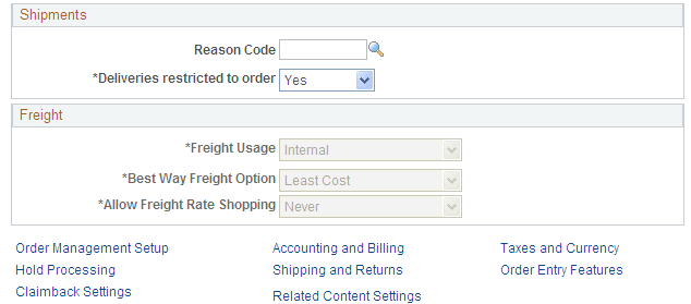

Shipments group box
Use this group box to define options for delivery management.
Field or Control |
Description |
Reason Code |
Select a reason code to describe the goods that are shipped as well as their nature and quality. This code is included on orders and shipping documents to meet government requirements. You can only enter reason codes with the reason type of shipments. The code appears by default on the Ship Options tab in the Order Lines section of the Order Entry Form. |
Deliveries restricted to order |
Select an option to determine if a delivery can contain demand lines from more than one sales order or quote. The options are:
Note: The Deliveries Restricted to Order field can be defined within the default hierarchy on the Shipping and Returns page of the Order Management business unit, Order Groups page, customer's General Information - Ship To Options page, and the Buying Agreement Form-Header Terms page. In the default hierarchy, the more specific information overrides the more general information; in this case, the setting for the Deliveries Restricted to Order field that is defined on a buying agreement overrides a value on a customer and the value on the customer would override the value on the order group. A value on the order group would override the value at the order management business unit. |
Freight group box
Use this group box to setup freight calculations for sales orders within this business unit.
Field or Control |
Description |
Freight Usage |
Specify the type of freight calculation to be done in combination with the Freight Supplier field in the Carrier ID table. Options are:
Allow Freight Rate Shopping |
This field is used when integrating with an external third-party freight provider. The field identifies whether the interfacing third-party freight system allows rate shopping. Rate shopping enables a user to choose which freight carrier and charges to use on the delivery based on the choices retrieved from the third-party freight provider. This method displays the Freight Rate Shopping page for users to view, evaluate, and select the best freight carrier for their needs. Rate shopping can be performed from the Order Entry Form in PeopleSoft Order Management and from the Delivery Management Workbench in PeopleSoft Inventory. In addition, freight rate shopping can be performed for a quote. The option are:
For freight rate shopping at order entry time, the Allow Freight Rate Shopping field works with the online Process Freight Charges field on the Order Entry Features page within the Order Management business unit definition. If the value is None in the Process Freight Charges row and the Online column, the freight rate shopping cannot be performed from the Order Entry Form component. If the value is Manual or Online in the Process Freight Charges row and the Online column, the freight rate shopping can be performed if the Allow Freight Rate Shopping field is Always or Optional. |
Best Way Freight Option |
This field is used when integrating with an external third-party freight provider. This value in this field is used as the default value on the Order Entry Form component and the Order Completion process. When you select a best-way freight option, the system sends a best-way request to the third-party provider system and the third-party provider returns only one freight choice per delivery ID. The user can preview this choice. The best-way option is used only if the carrier on the delivery is missing. The options are:

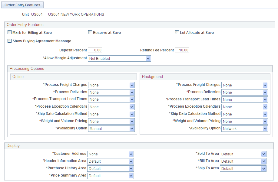

Use the Order Entry Features page (BUS_UNIT_TBL_OM9) to enter quote and sales order processing options.
Navigation:
Click the Order Entry Features link on the Order Management Setup page.
This example illustrates the fields and controls on the Order Entry Features page (1 of 2).
This example illustrates the fields and controls on the Order Entry Features page (2 of 2).
The table displays a list of invalid setup combinations for the online and background processing options. You will not receive an error message if you select an invalid combination; however, the valid combination is automatically selected:
Option |
Invalid Combination |
Process Freight Charges, Online, Online |
Process Freight Charges, Online, Manual |
Field or Control |
Description |
Mark for Billing at Order Save |
Select this check box to automatically record a shipped line for each nonstock order schedule when you save it with a status of open. Otherwise, the Populate Billing (OM_BILL) process populates the interface tables that are in PeopleSoft Billing with shipment history. PeopleSoft Billing runs the Billing Interface process and then finalizes and prints invoices. The shipment history for nonstock products is recorded by using the Mark Lines for Billing process page. Run the Mark Lines for Billing process as a background process or manually record shipment lines for nonstock schedules by using the Mark Lines for Billing page. |
Reserve at Save |
Select this check box to automatically invoke the reservation process every time that you save the sales order. If you add new lines and then save, the system reserves only the new lines. The order status must be open for the reservations process to automatically reserve orders by using this option. |
Lot Allocate at Save |
Select this check box if you want the system to perform lot allocation when you save the order. If you do not select this check box, the CSR can select lot allocation from the Header menu on the Order Entry Form page. |
Show Buying Agreement Message |
Select this check box to display a warning message that states that the product is not found for the buying agreement that is defined on the order line. |
Deposit Percent |
Enter the percentage that is collected for special order or back order goods on a sales order. Deposit percent is provided by default from the customer into the order. If no deposit percent exists, then the system uses the deposit percent from the business unit specified here. |
Refund Fee Percent |
Enter the percentage that is charged for refunding a deposit. |
Allow Margin Adjustment |
Select from the drop-down list to enable the CSR to manipulate the margin on the sales order or quote. |
Select from the order options to determine how each is processed:
Field or Control |
Description |
Process Freight Charges |
Use this row to determine when freight charges should be calculated and applied to a sales order. For the Process Freight Charges row and the Online column, select one of the following options:
For the Process Freight Charges row and the Background column, select one of the following options:
Process Deliveries |
Use this row to determine when a delivery ID should be applied to demand for a sales order line or quote line. You can choose to create or update deliveries when a user saves a new sales order or quote, changes a field on an existing order or quote, and when the Order Completion process (OM_BACKGRND) is run. For the Process Deliveries row and the Online column, select one of the following options:
For the Process Deliveries row and the Background column, select one of the following options:
Group order schedules into deliveries in order to calculate freight charges, use weight and volume pricing, and manage shipping information. |
Process Transport Lead Times |
Calculate scheduled arrival and ship dates by using transportation lead times. |
Process Exception Calendars |
Calculate the scheduled arrival and ship dates based on the ship to customer, ship from inventory business unit and carrier exception calendars. Exception calendars for customers are set up on the General Information - Ship Exception Dates page and, for Inventory business units, on the Closure Calendar page. Carrier exception dates are established on the Carrier Exception Calendar page. If you do not select the exception calendar processing option, the system calculates the scheduled dates based on today's date. |
Ship Date Calculation Method |
Use to determine how to calculate the requested delivery dates. The system uses the customer, warehouse and carrier calendars to determine the dates. If the requested delivery dates cannot be met, choose from the available options: Forward: The system will use the first available date after the requested delivery date. Prior to this release, the system calculated the dates using this method only. Backward: The system will use the first available date before the requested delivery date. |
Weight and Volume Pricing |
Calculate the price of the products in the order based on weight or volume. Also, establish pricing for a UOM that is different than the ordering UOM. Note: If you are using weight and volume pricing, you must also select the Process Deliveries option. |
Availability Option |
Availability options are: Automatic: By default, provides the highest priority PeopleSoft Inventory business unit from alternate sources of supply. You can override the default by using the Alternate Sources of Supply page on the sales order. The system will search alternate sources of supply again and display other sources that are available based on the arbitration plans and rules that are defined. Manual: By default, provides the highest priority PeopleSoft Inventory business unit in the distribution network that has the quantity available to satisfy the quantity scheduled on the sales order. You can override the default by using the Alternate Sources of Supply page on the sales order. The system will search alternate sources of supply and display other sources that are available based on the arbitration plan and rules that are defined. Network: By default, provides the highest priority PeopleSoft Inventory business unit in the distribution network that has the quantity available to satisfy the quantity scheduled on the sales order. This option corresponds to having the Availability Check flag selected in previous releases. None: If you are using a distribution network on the customer or PeopleSoft Order Management business unit, the highest priority PeopleSoft Inventory Business Unit from the distribution network is provided by default to the sales order schedule, regardless of item availability. If you are not using distribution networks, the Inventory business unit that is defined on the Order Management business unit is provided by default to the sales order schedule. This option corresponds to having the Availability Check flag cleared in previous releases. |
Online Authorizations |
Select to authorize credit cards during sales order entry. |
Corporate Credit Check |
Select to determine if the corporate credit check is performed online or only performed by the background credit checking process, so as not to impact online performance. |
Default Credit Card Group |
Enter a default credit card group to manage the display of credit card types for a specific business unit. If the value is not defined in the business unit definition, the system uses this value. The grouping can be utilized by the Order to Cash applications to limit or control what credit card types and third-party processors are available within their transactions. See documentation for the Credit Card Groups Page. |
When you are selecting online and background processing, you can choose these options:
Option |
Online |
Background |
Freight is calculated when you:
None, Background |
Field Chg (Field change), None, Order Save |
None, Background |
None, Background |
None, Background |
None, Backward, Forward |
Process Weight and Volume Pricing |
None, Manually, Order Save |
None, Background |
Automatic, Manual, Network, None |
Automatic, Network, None |
Credit Card Authorizations |
Online, None |
NA |
Note: For Deliveries, Transport Lead Times, and Exception Calendars, online processing can occur at Field Chg (change), when any of the fields that make up the option are modified, or at Order Save, when the order is saved.
Display
This section discusses how information initially appears during sales order entry based on the default for the business unit.
Note: The appearance of sales orders and quotes can also be defined for each user from the User Preferences page.
Field or Control |
Description |
Customer Address |
The customer address appears on the Order Header page only when you enter a new order header or access an existing order header from the add/search page. |
Header Information Area, Purchase History Area, Price Summary Area, Sold To Area, Bill To Area, Ship To Area |
Select to move the display of information in the designated areas of the Order Entry Form page by default. During order entry, you can open or close the area as needed. Options are: Collapsed: The section appears in a collapsed mode. Default: The Header Information Area, Purchase History Area, Price Summary Area, and Sold To Area appear in the open mode. The Bill To Area and Ship To Area appear in the collapsed mode. Open: The section appears in an open mode. |

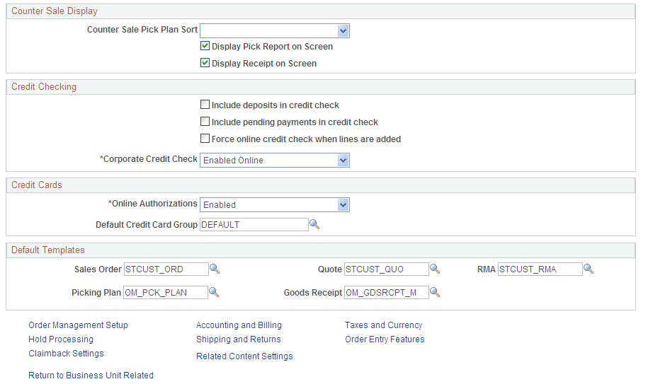

Counter Sale Display
Field or Control |
Description |
Counter Sale Pick Plan Sort |
Select how to sort the pick plan. Values are: IBU/Line: Sort by the Inventory Business Unit line. IBU/Loc (location): Sort by the Inventory Business Unit location. |
Display Pick Report on Screen |
Select if you want the pick report to appear on the computer screen. If you do not select the option, the report will only be available in print format. |
Display Receipt on Screen |
Select if you want the receipt to appear on the computer screen. If you do not select the option, the receipt will only be available in print format. Note: If this option is not selected, a warning message to enter a default printer is displayed when you add or modify a Cash Drawer ID. |
Credit Checking
Field or Control |
Description |
Include Deposits in credit check |
Select this check box to include deposits in the credit checking algorithms. |
Include pending payment in credit check |
Select to include payments that have not yet been processed by PeopleSoft Receivables in the credit checking algorithms. |
Force online credit check when lines are added |
Select this check box if you want the system to force an online credit check when new lines are added to an order. |
Default Template
Use to specify the customer template used to enter customers who are not already in the system. The customer template must be saved with a status of Template in order to be selected for use with sales orders, quotes, or RMAs.
Field or Control |
Description |
Sales Order, Quote, RMA, Picking Plan, Goods Receipt |
Select the template to be used for each transaction. |
