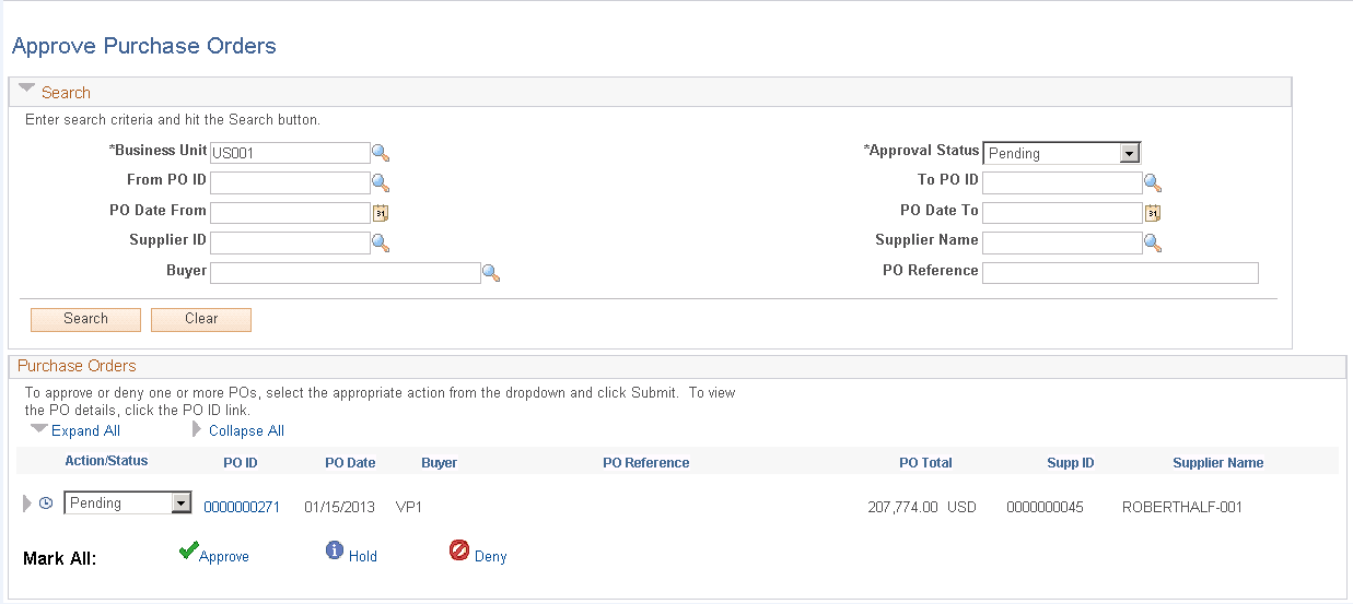

Use the Approve Purchase Orders page (PO_MASS_APPR) to enter search criteria to view purchase orders that require your approval or purchase orders that previously required your approval.
This page can display multiple purchase orders and can be used to perform approval tasks such as approve or deny. On this page, you can use the mass approval feature to approve or deny multiple purchase orders at one time.
Approving a Purchase Order
To approve a purchase order use either the Approve Purchase Orders page or the Purchase Order Approval page.
On the Approve Purchase Orders page:
This page displays multiple purchase orders requiring approval. To approve individual purchase orders or lines, change the Action/Status field from Pending to Approve. To approve all purchase orders displayed in the search results, use the mass approval feature by clicking the Mark All: Approve link.
Click the Submit button.
Navigation:
This example illustrates the fields and controls on the Approve Purchase Orders page. You can find definitions for the fields and controls later on this page.
The Approve Purchase Orders page enables you to view and take action on purchase orders that require your approval or view purchase orders that do not require your approval.
Use this page to search for and view purchase orders needing your approval. Purchase orders displayed are based on the user ID of the person entering this page. You can limit the scope and number of purchase orders that appear on the page. For example, you can limit the search results to a specific buyer, date range, or approval status. After displaying the purchase orders, you can perform approval tasks on a group of purchase orders, one individual purchase order, or even separate PO lines. For more details on a particular purchase order, click the PO ID link to access the Purchase Order Approval page where you can view the details of one individual purchase order and perform approval tasks.

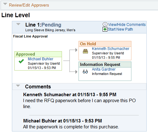

Holding a Purchase Order or Purchase Order Line
The hold action gives the approver time to research an issue and prevents the approval process from going to the next approval step until the approver takes action on the purchase order or purchase order line. When an approver uses the hold action, the system inserts an ad hoc reviewer at the current approval step and the approver can add a comment requesting more information. If multiple approvers are required to approve in this one approval step in the approval framework, then the other approvers of the same step can approve or deny the PO or PO line; however, the approval process does not move to the next approval step until the hold is removed by the approver who entered it. The approval hold is removed when either the approver chooses to approve or when the purchase order is updated in such a way that the approval process is restarted.
This page illustrates the results on the Purchase Order Approval page after the Hold button is used.
This example illustrates the fields and controls on the Hold on PO Line. You can find definitions for the fields and controls later on this page.

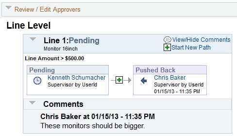

Pushing Back Purchase Orders
Once a purchase order line has been approved by at lease one person, the next approver can push back the purchase order line in order to have the previous approver reconsider the approval. To pushback a purchase order line use the Purchase Order Approval page.
On the Purchase Order Approval page:
Select one or more lines that are pending approval. You can only pushback lines that have been previously approved within this approval step.
At the bottom of the page, use the Enter Approver Comments field to enter comments about the pushback.
Click the Pushback button below the Review Lines group box.
This page illustrates the results on the Purchase Order Approval page after the Pushback button is used.
This example illustrates the fields and controls on the Pushed back PO line. You can find definitions for the fields and controls later on this page.

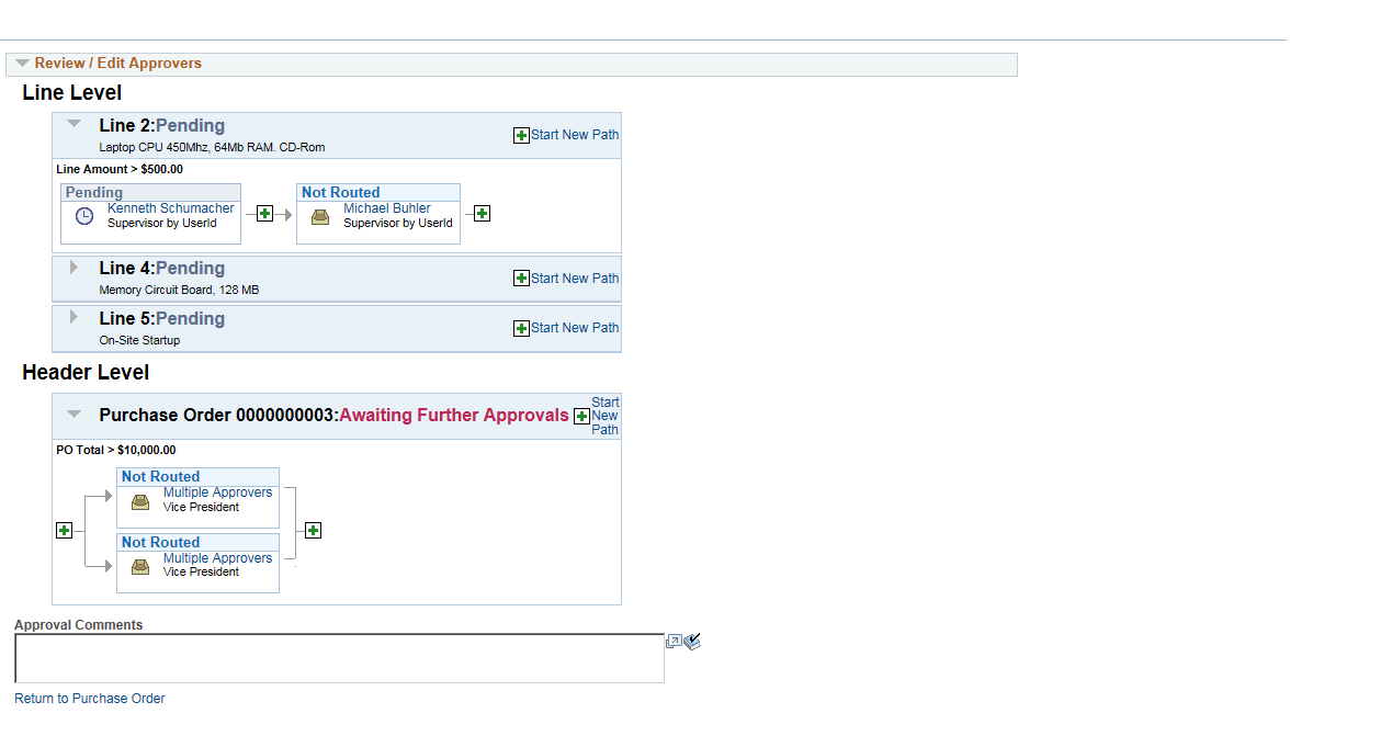

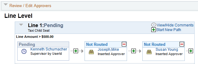

Insert Ad Hoc Approvers
Use the Purchase Order Approval page to insert ad hoc approvers and reviewers, in the Review/Edit Approvers group box, click the plus + symbol for a pending purchase order line. The Insert additional approver or reviewer window appears for you to select the user ID, and to indicate whether the person is an ad hoc approver or reviewer for this line.
You cannot change ad hoc approvers or reviewers; however, you can delete and add them again to indicate whether they are approvers or reviewers. To delete an approver or reviewer, click the minus – symbol. To add multiple approvers or reviewers click the plus + at the point where you want the additional approver or reviewer to receive the approval.
Use the Ad Hoc User List field on the Configure Transactions page to limit the users that can be added as ad hoc approvers and reviewers. If this field is left blank, then any active user can be added as an ad hoc approver or reviewer.
When you click the + symbol, the following window displays:
This example illustrates the fields and controls on the Insert additional approver or reviewer page. You can find definitions for the fields and controls later on this page.
This example illustrates the fields and controls on the Review/Edit Approvals section after an ad hoc approver has been added. You can find definitions for the fields and controls later on this page.

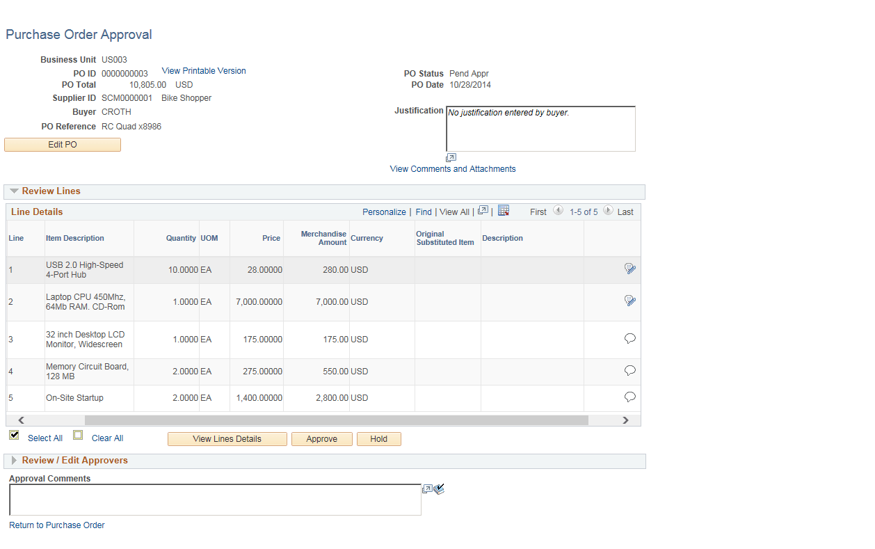

Use the Purchase Order Approval page (PO_APPROVAL) to view an individual purchase order that requires your approval.
This page displays the details of just one purchase order and can be used to perform approval tasks such as approve, deny, or pushback.

This example illustrates the fields and controls on the Purchase Order Approval page 1 of 2. You can find definitions for the fields and controls later on this page.
This example illustrates the fields and controls on the Classic Purchase Order Approval page 2 of 2. You can find definitions for the fields and controls later on this page.
Use this page to view the approval steps of a single purchase order. If your approval is needed, determined by your user ID, then the approval tasks are available. Based on your setup, the following options are available on this page:
Approving a purchase order or purchase order line.
Placing one or more purchase order lines on hold. This action inserts an ad hoc reviewer and requires you to enter comments.
Push back a purchase order or purchase order line. A pushback action returns the transaction to the previous approval step.
Add or remove ad hoc approvers or reviewers.
Review an online purchase order that shows the layout of the printed version.
Make comments to be viewed by other approvers or reviewers.
Note: If you select a line that does not require action, you receive a message telling you to select a line that is pending an approval.

Review / Edit Approvers
The Review / Edit Approvers displays the approval path for each line and the purchase order header. Use this section of the Purchase Order Approval page to review the approval flow, such as who approved the purchase order before you and who will approve it after you.
Click the plus + symbol to insert ad hoc approvers and reviewers. If you want to remove an ad hoc approver or reviewer click the minus — symbol.

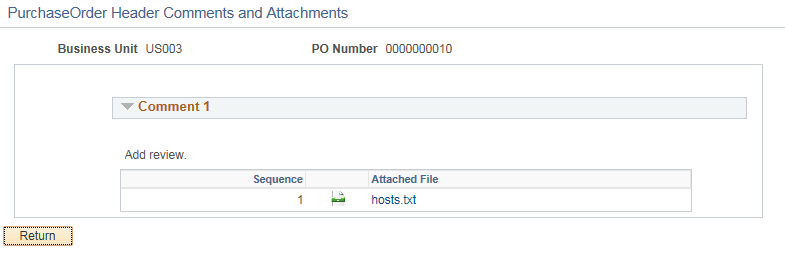

Purchase Order Header Comments and Attachments
Navigation:
Click the View Comments and Attachments link on the Purchase Order Approval page.
This example illustrates the fields and controls on the PO Header Comments and Attachments page. You can find definitions for the fields and controls later on this page.

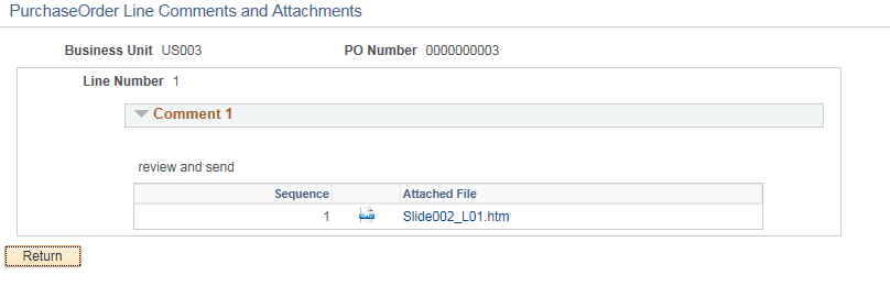

Purchase Order Line Comments and Attachments page
Navigation:
Click on the Comments and Attachments icon on the Purchase Order Approval page line details section.
This example illustrates the fields and controls on the Purchase Order Line Comments and Attachments. You can find definitions for the fields and controls later on this page.
