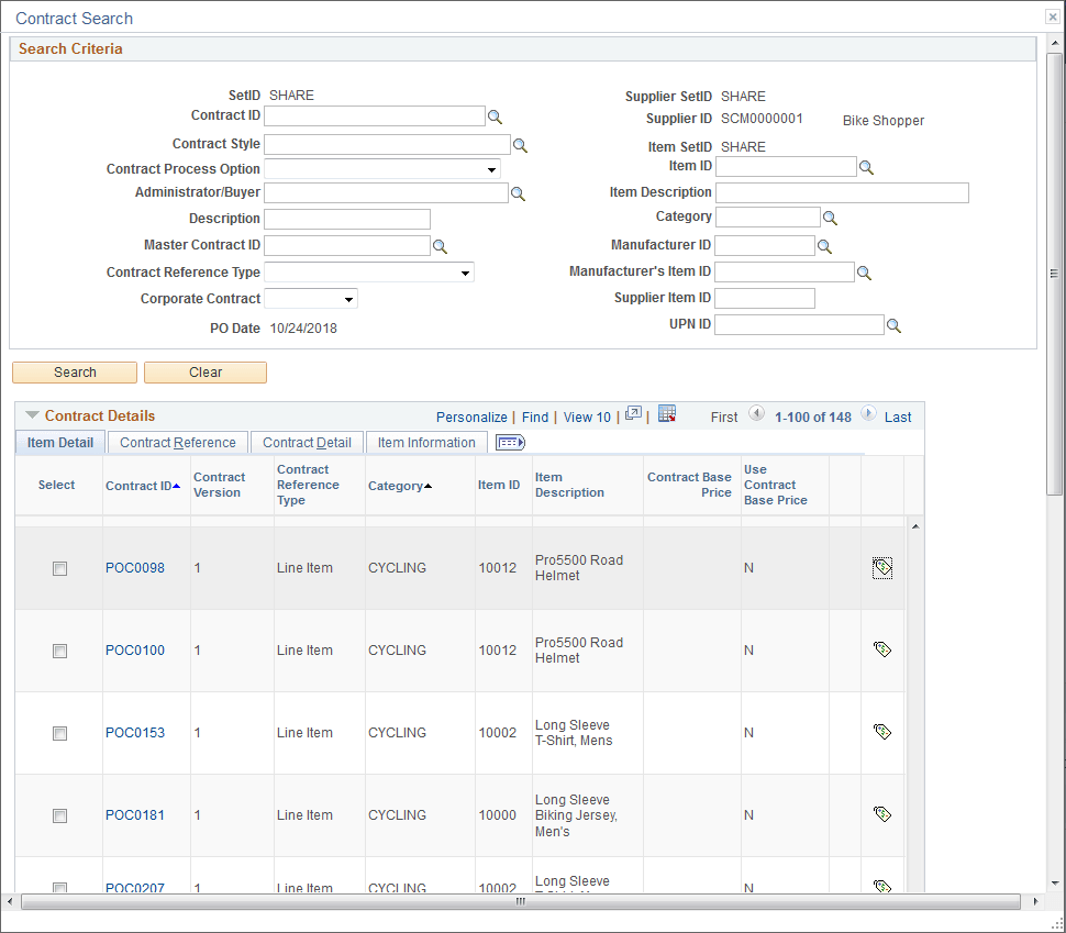

CNTRCT_SRCH |
Search for contracts. |

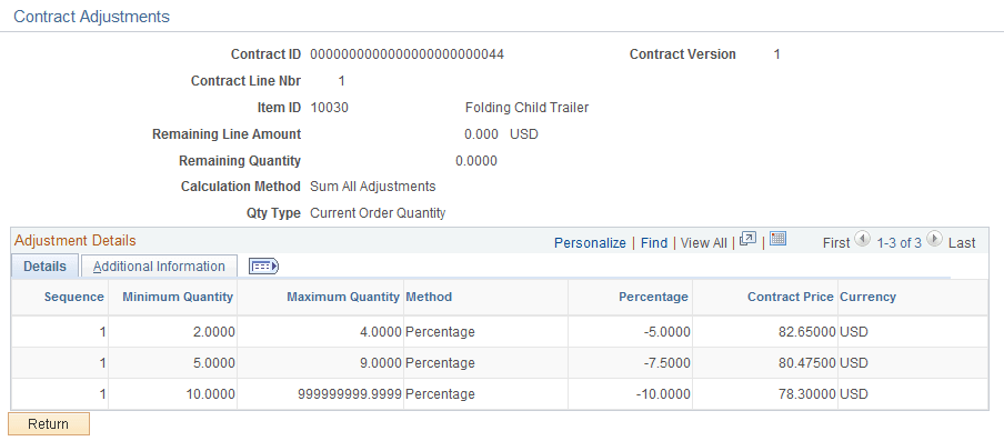

CNTRCT_ADJ_SEC |
View contract detail information, such as item and/or item description, contract line number or category line number, remaining quantity and remaining line amount. |

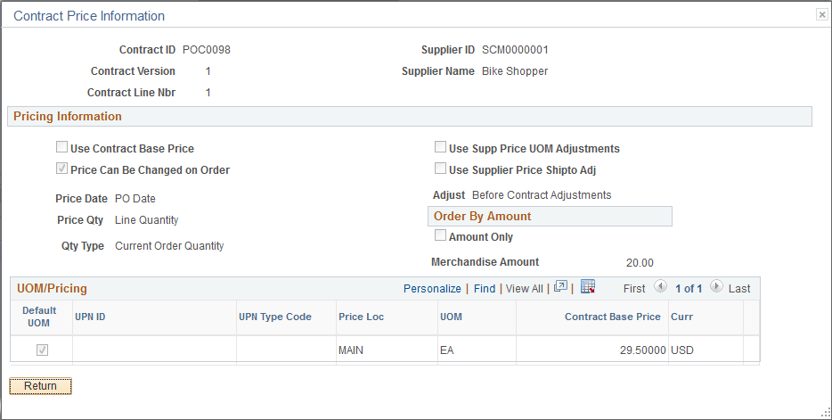

CNTRCT_UOMPRCN_SEC |
View pricing and unit of measure details for the contract. |

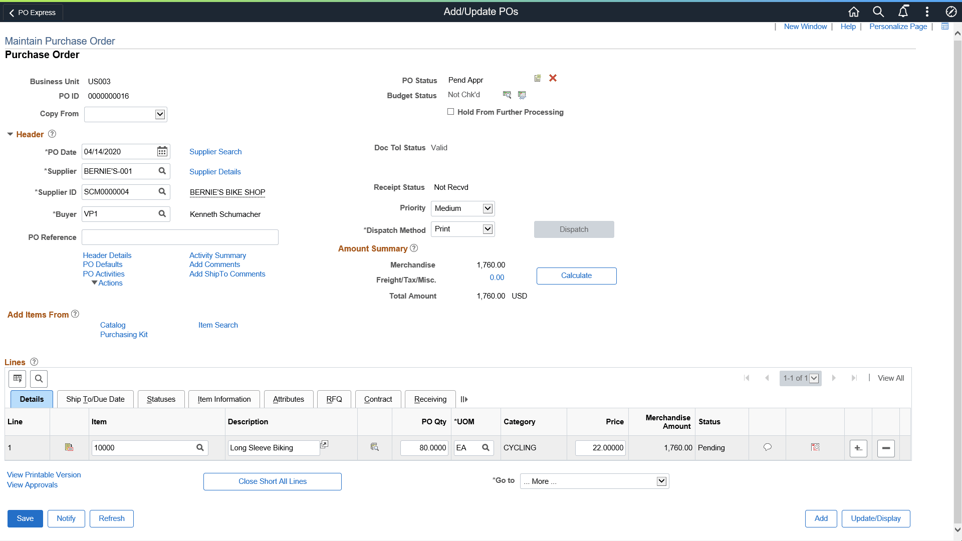

Use the Maintain Purchase Order - Purchase Order page (PO_LINE) to enter or change purchase order information online.
Navigation:
This example illustrates the fields and controls on the Maintain Purchase Order - Purchase Order page(1of2). You can find definitions for the fields and controls later on this page.
Details
Access the Details tab.
Field or Control |
Description |
The icon will appear on the Details tab if there is a substitute item in use. |
Click the Line Details button to access the Details for Line page. |
The Part of Line Group button displays when there is a group ID value and at least one of the schedules for the line has an event ID value. The button does not perform an action. |

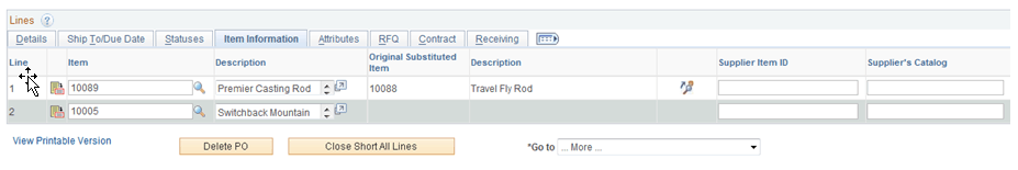

Item Information
Use the Item Information tab to enter item information such as supplier and manufacturing information.
This example illustrates the fields and controls on the Item Information Page. You can find definitions for the fields and controls later on this page.
The Item Information Tab displays the new item sub fields:
Field or Control |
Description |
Original Substituted Item |
Displays the original Item ID on a procurement transaction that is being substituted. Once an Original Substituted Item is designated for a procurement transaction, it is carried all the way through to the Receipt and cannot be changed. (This is also referred to as only ‘Original Item’ in some cases where the Item may or may not have been substituted.) |
Description |
Displays the description associated with the original substituted item |
The icon will appear on the Item Information tab if there is a substitute item available. |
Click the Item Search icon to access the Substitute Item page (SUB_ITM_SRCH), which you can use to view and select all items available to substitute. For Information on Substitute Item Search page Field descriptions SeeUnderstanding Item Substitution in Procurement |

Contract
You can use this tab to manually enter purchase order contract lines for line group items and to view contract details for the purchase order.
Field or Control |
Description |
Click the Contract Search button to access the Contract Search page, where you can perform advanced searches for contracts. See Contract Search Page. |

Attributes
Field or Control |
Description |
Physical Nature |
Select to indicate whether the object is a physical good or service. |
Price Qty (price quantity) |
Quantity that the system uses to determine minimum order quantities and price adjustment quantities. Select Line or Schedule. If you set up an item-supplier relationship for the purchase order line item, there is a specific price for the item with that supplier, as well as a minimum quantity that you are required to purchase. If you have set up price adjustments for the item and supplier, they may depend on the purchase order quantity. |
Price Date |
Date that the system uses to determine minimum quantity and price adjustment dates. Select PO (purchase order date) or Due (schedule due date). The price date works in conjunction with the value in the Price Qty field. |
Amount Only |
Select this check box to designate the line as an amount-only line. If selected, the purchase order quantity value on the line is set to 1 and the field becomes unavailable for entry. The Amount field on the line becomes available for entry. The line amount that you enter becomes the schedule price and amount. If you have an existing purchase order quantity value, line amount, schedule amount, and schedule price, and then select this option, each of these values is reset:
If this check box is selected, the system will also determine and populate the Receiving Required field value for the purchase order line. The system will look first at the Default Amount Only PO to "Do Not Receive" check box setting you specify on the Purchasing Options page associated with the business unit. If that check box is selected, the system will populate the Receiving Required field with Do Not (do not receive). If that check box is clear, the system will then look at the item and then the item category to determine the Receiving Required field value for the purchase order line. Plus, the Inspection Required field will not be available for entry. This field is not available if the purchase order is used with a recurring purchase order voucher. |
Procurement Group ID |
Enter a procurement group ID to include this line in a procurement group. A procurement group gathers a group of line items on a requisition, purchase order, or receipt to help organize a larger item. For example, the Procurement Groups feature can be used in combination with PeopleSoft Asset Management to collect all item IDs that belong to a larger asset such as an air conditioning unit. |
Primary Unit |
Select this check box to choose this line item as the main item for an item-grouping in a procurement group; for example, an air conditioning unit could be the primary unit in a procurement group to create a complete asset. In order to use this check box, you must enter a value in the Procurement Group ID field on this page. If a primary unit item ID has already been selected on the Procurement Groups page then this field cannot change the primary unit. |
Unit Allocation Qty |
Enter the quantity of this item needed to complete a primary unit in a procurement group; for example, four brackets per air conditioning unit. If this page is for the primary unit item and it is serial-controlled then this quantity is restricted to one. This field is only available if you have not selected the Amount Only check box. It is utilized during receiving and asset integration. |
Unit Allocation Amt |
Enter the amount or price of this item needed to complete a primary unit in a procurement group; for example, 500 USD of installation services per air conditioning unit. This field is only available for amount-only transactions lines that have selected the Amount Only check box. It is utilized during receiving and asset integration. |

Use the Contract Search page (CNTRCT_SRCH) to search for contracts.
Navigation:
Click the Contract Search button on the Maintain Purchase Order page.
This example illustrates the fields and controls on the Contract Search Page. You can find definitions for the fields and controls later on this page.
Use this page to find a contract and use its prices to populate purchase order values. The system automatically applies the contract price to the purchase order.
You can search for individual contracts by contract ID or limit the search to only those contracts for a specific contract process option. You can also search for manufacturer contracts—the system uses the Supplier ID you specify to search against the distributor contract supplier.
After you define contract search criteria, click the button. The system searches for active, effective contracts based on the search criteria that you entered and displays the results with the most recent contract first. For Ad Hoc Contract Lines based on Item Identification, Multiple Item Identifying criteria may be entered (or transferred from the transaction line), in which case Contract Lines with partial matching identifiers are retrieved. If you are using contract usage options to control which business unit, contract domain, or ship to location can be used with a contract, the system returns only those contracts with valid contract control values. The system populates the Contract Details grid with the results and includes these tabs:
Item Detail
Contract Reference
Contract Detail
Item Information
The tabs help you to identify the correct contract to select if there are multiples.
Click the Clear button to remove search criteria.
Field or Control |
Description |
Contract Style |
Select a contract style. Values for contract style are user-defined using the Contract Style page. |
Administrator/Buyer |
Select an administrator or buyer related to the contract. |
Master Contract ID |
Select a master contract ID. Master contracts are groupings of several contracts for the same supplier and then tracked using one master contract ID. |
Contract Reference Type |
Select a reference type on which to base a search. A contract reference type indicates the source of item information contained in a contract. When you select items, the reference type is also included on the purchase order. Reference types include: Cat Cntrct (category contract): Searches for contract category lines that you can add to the purchase order. Line Item: Searches for contract line items. The search results will contain line item types that meet other criteria that you define. Open Item: Searches for items that are specified on the contract to be purchased against it. |
Manufacturer ID |
Enter a manufacturer related to the contract. |
Manufacturer’s Item ID |
Enter a manufacturer item related to the contract. |
Supplier Item ID |
Enter a supplier related to the contract. |
UPN ID (Universal Product Number ID) |
Enter a universal product number related to the contract. |
Item Detail
To apply the contract item price to the purchase order price, select a value from the returned search and click the OK button. The system overrides the item, item description, contract ID, contract line, and contract version using the contract row of data that you select.
Field or Control |
Description |
Contract ID |
Click to access the Maintain Procurement Contract page. You can use the page to view and update the contract. |
Click the Contract Adjustment icon to access the Contract Adjustments page. |
Click the Unit of Measure Pricing icon to access the Contract Price Information page, where you can view pricing and unit of measure details for the contract. |
Contract Reference
This tab provides supplementary details about the contract.
Contract Details
This tab provides details about the contract, such as the Contract Style selected, the begin date of the contract, and the type of Punchout Pricing option selected for a contract.
Item Information
This tab provides details about supplier and manufacturer items for the contract, such as manufacturer item ID, supplier item ID, and default universal product number from the contract line.
Use the Contract Adjustment (CNTRCT_ADJ_SEC) page to view contract detail information, such as item and/or item description, contract line number or category line number, remaining quantity and remaining line amount. Remaining Amounts are calculated if a maximum quantity or maximum amount has defined on the contract.
Navigation:
Click the Contract Adjustment icon on the Contract Search page.
This example illustrates the fields and controls on the Contract Adjustment Page.
Use the Contract Price Information (CNTRCT_UOMPRCN_SEC) page to view pricing and unit of measure details for the contract.
Navigation:
Click the Unit of Measure Pricing icon on the Contract Search page.
This example illustrates the fields and controls on the Contract Price Information page.
Use the Header Misc. Charges (header miscellaneous charges) page (PO_MISC_WRK) to apply miscellaneous charges that you add on the Header - Miscellaneous Charges page to the lines of the purchase order.
Navigation:
Select 13 - Header Misc. Charges in the Go to field on the Maintain Purchase Order - Purchase Order page.
All Charges
The All Charges group box displays information about the miscellaneous charges selected on the Header Miscellaneous Charges page.
The actions of the these three items apply to the single miscellaneous charge that appears in the All Charges group box.
