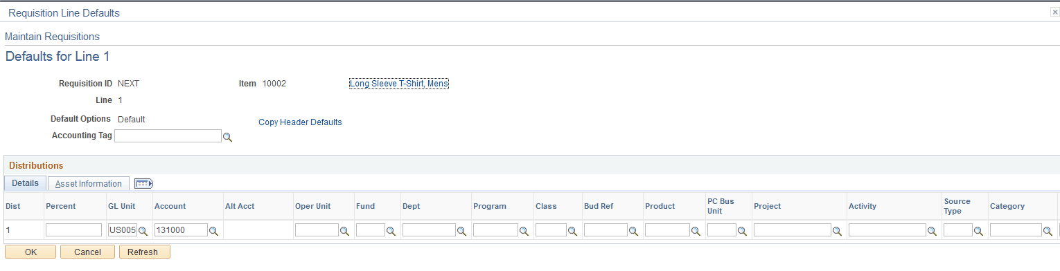

Defaults for Line Page |
REQ_LINE_DEFAULTS |
Enter default information for a requisition line. |
Retrofit field changes to all the distributions on the requisition line Page |
REQ_DFLT_RETROFIT |
Apply default field-value changes for the requisition line to all distribution lines. |

Use the Defaults for Line page (REQ_LINE_DEFAULTS) to enter default information for a requisition line.
Navigation:
Click the Line Defaults button on the Maintain Requisitions - Requisition page.
This example illustrates the fields and controls on the Defaults for Line page. You can find definitions for the fields and controls later on this page.
When you change requisition line default information and exit the page, whether using the Default or Override option set at the header, the system prompts you with the Retrofit field changes to all the distributions on the requisition line page.
Field or Control |
Description |
Default Options |
Displays either Default or Override. This value is defined on the Requisition Defaults page. |
SpeedChart |
Select a default SpeedChart. The SpeedChart feature enables you to use a code that contains preset distributions. Note: The field is enabled only when the default option is set to override. Note: Accounting Tags appear in lieu of Speedcharts when the Accounting Tag check box is selected for Purchasing on the Accounting Tag Registration page. See Setting Up Accounting Tags |
Accounting Tag |
Enter an Accounting Tag that will be used to populate ChartFields on transaction distribution lines. The system automatically prorates the distribution amounts according to the proration percentages defined on the Accounting Tag. Note: The field is enabled only when the default option is set to override. Note: Accounting Tags appear in lieu of Speedcharts when the Accounting Tag check box is selected for Purchasing on the Accounting Tag Registration page. See Setting Up Accounting Tags |
Copy Header Defaults |
Click to copy requisition header distribution defaults to the line. |
