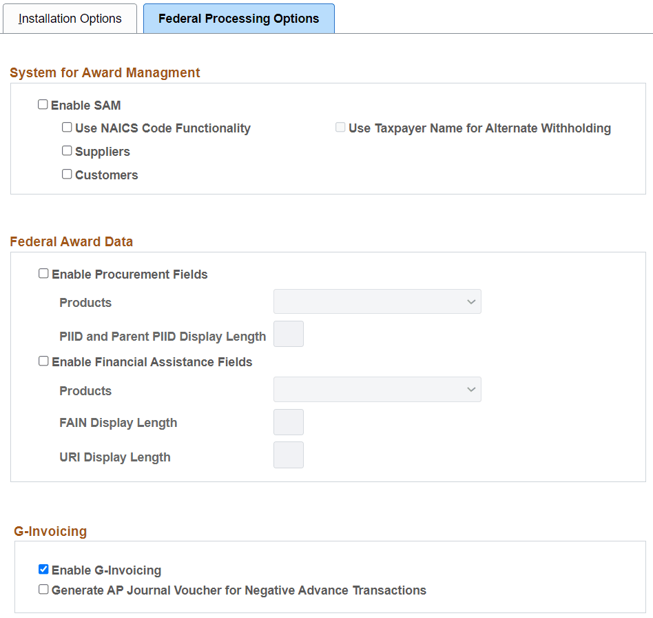

Use the Federal Processing Options page (INSTALLATION_FD) to enable PeopleSoft G-Invoicing to run the APIs and view the G-Invoicing specific fields on the purchase order and receipt.
Navigation:
This example illustrates the fields and controls on the Federal Processing Options page. You can find definitions for the fields and controls later on this page.
Field or Control |
Description |
Enable G-Invoicing |
Select to enable G-Invoicing fields and functionality. |
Generate AP Journal Voucher for Negative Advance Transactions |
Select to automatically create Journal Vouchers for negative advance adjustment performance transactions received from G-Invoicing. This field is visible only when Enable G-Invoicing is selected. |

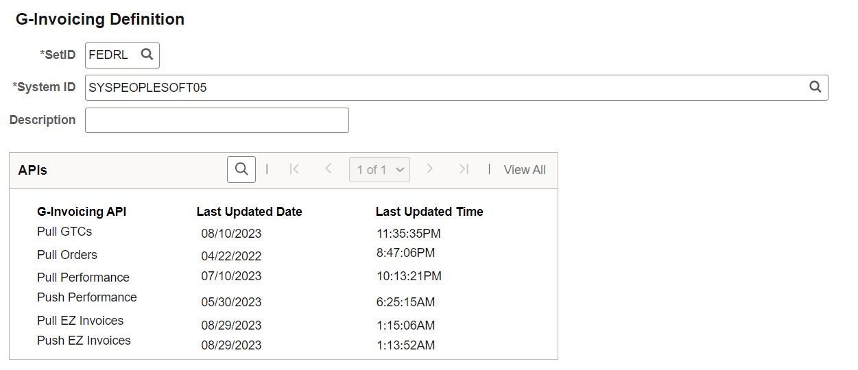

The G-Invoicing Definition page (PO_GINV_DEFN) captures fields required by G-Invoicing for messaging. Additionally, this page stores the last date and time that each API ran for the selected G-Invoicing System ID. All G-Invoicing System IDs must be defined on this page. System IDs are used for security in G-Invoicing.
Navigation:
This example illustrates the fields and controls on the G-Invoicing Definition page. You can find definitions for the fields and controls later on this page.
Field or Control |
Description |
SetID |
Enter the Set ID associated with the System ID definition. |
System ID |
Enter the G-Invoicing System ID. |
Description |
Enter a description of the entry. |
G-Invoicing API |
Displays the available APIs. |
Last Updated Date (read only) |
Displays the date FROM which transactions are selected by the pull APIs. |
Last Updated Time (read only) |
Displays the time FROM which transactions are selected by the pull APIs. |

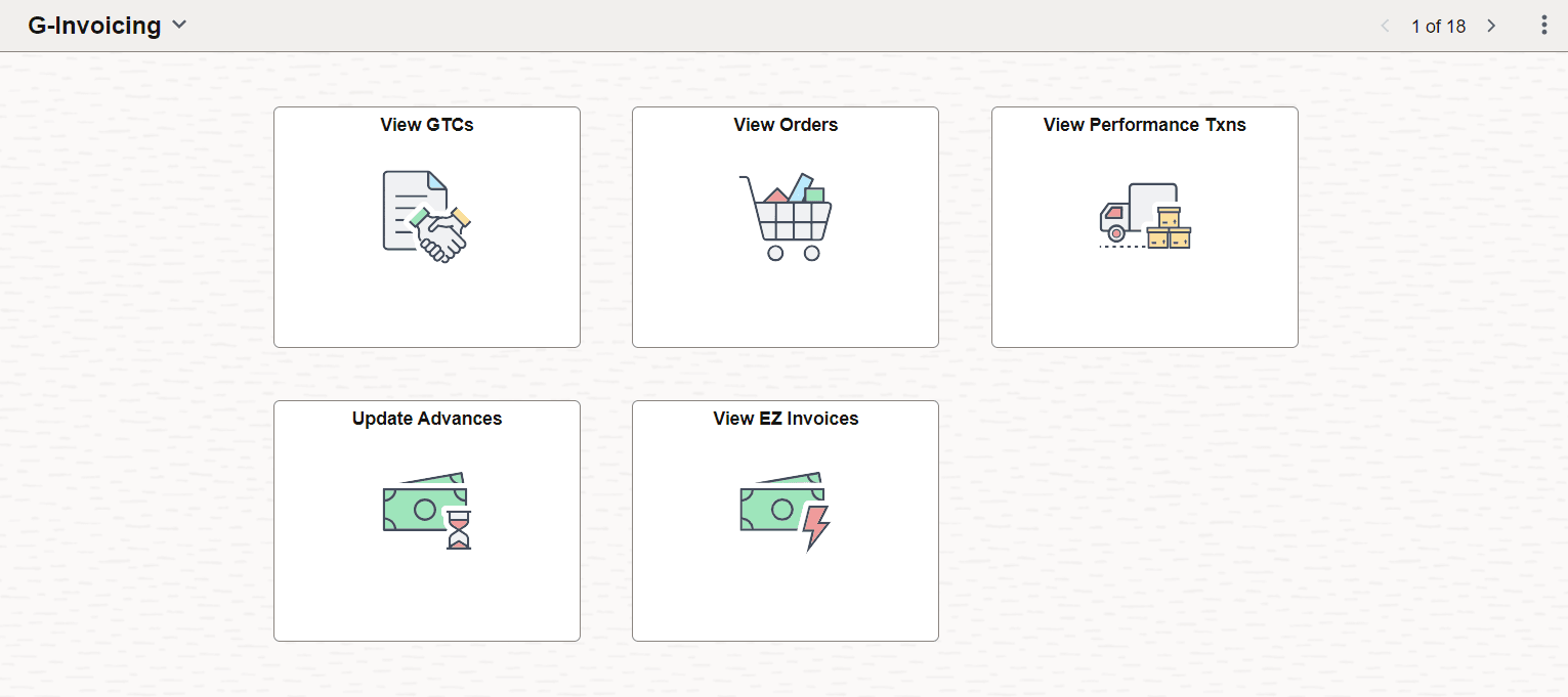

G-Invoicing navigation collection page is used to group the G-Invoicing inquiry pages together allowing a user to easily navigate from one component to another.
This example illustrates the fields and controls on the G-Invoicing page.

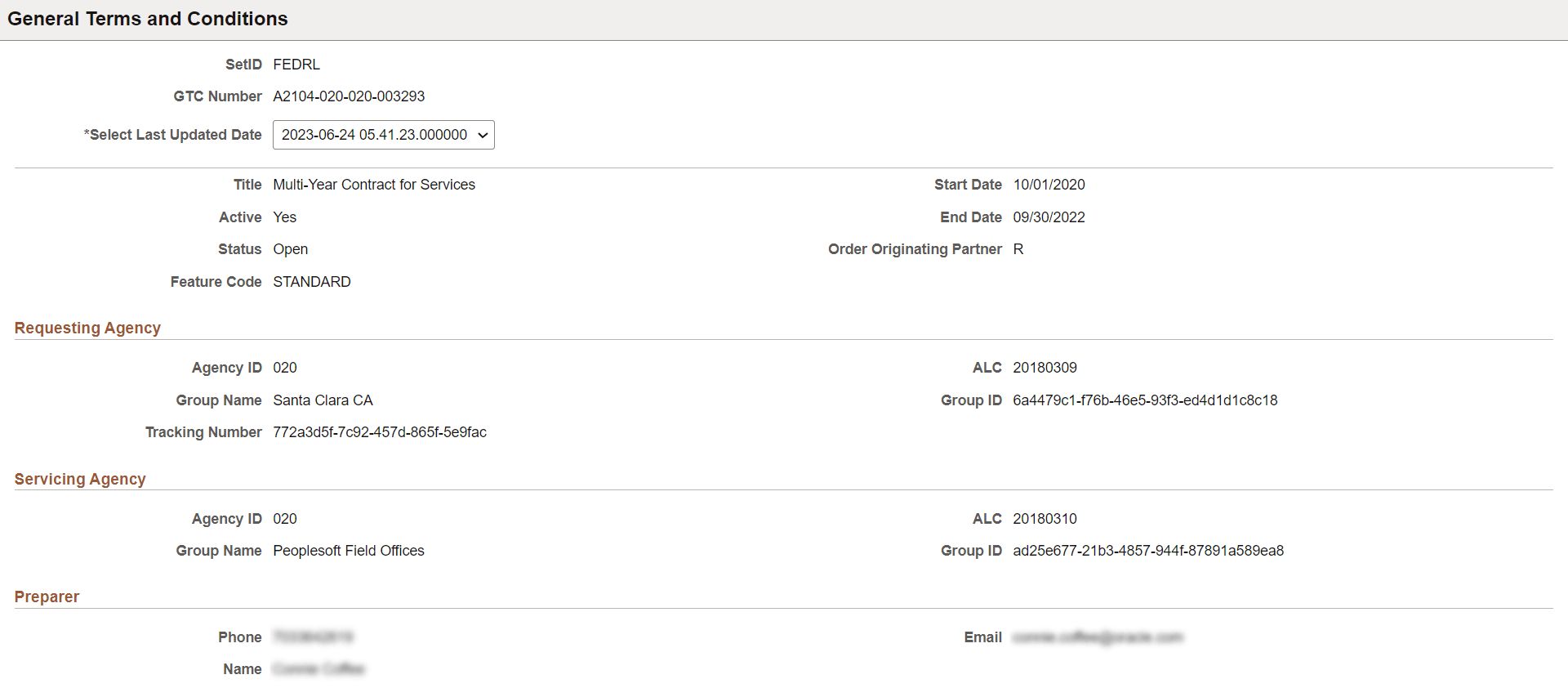

Use the GTCs (General Terms and Conditions) page (PO_GNV_GTC_FL) to view G-Invoicing General Terms and Conditions that have been pulled using the Pull GTCs API.
Navigation:
This example illustrates the fields and controls on the General Terms and Conditions page. You can find definitions for the fields and controls later on this page.
Field or Control |
Description |
SetID |
Displays the derived set ID associated with the G-Invoicing System ID on the G-Invoicing Definition page. |
GTC Number |
Displays the GT&C number assigned in G-Invoicing. |
Title |
Displays the GT&C Title entered in G-Invoicing. |
Feature Code |
Displays the G-Invoicing type:
Status |
Displays the GT&C Status received from G-Invoicing. |
Start Date |
Displays the GT&C Start Date entered in G-Invoicing. |
End Date |
Displays the GT&C End Date entered in G-Invoicing. |
Active |
Indicates whether the GT&C is available for selection on Purchase Orders. |
Click to view the GT&C Detail page. Click the Select Last Updated Date drop down to see the GT&C changes that have occurred in G-Invoicing for a specific date/time. |
This example illustrates the fields and controls on the GT&C Detail page.

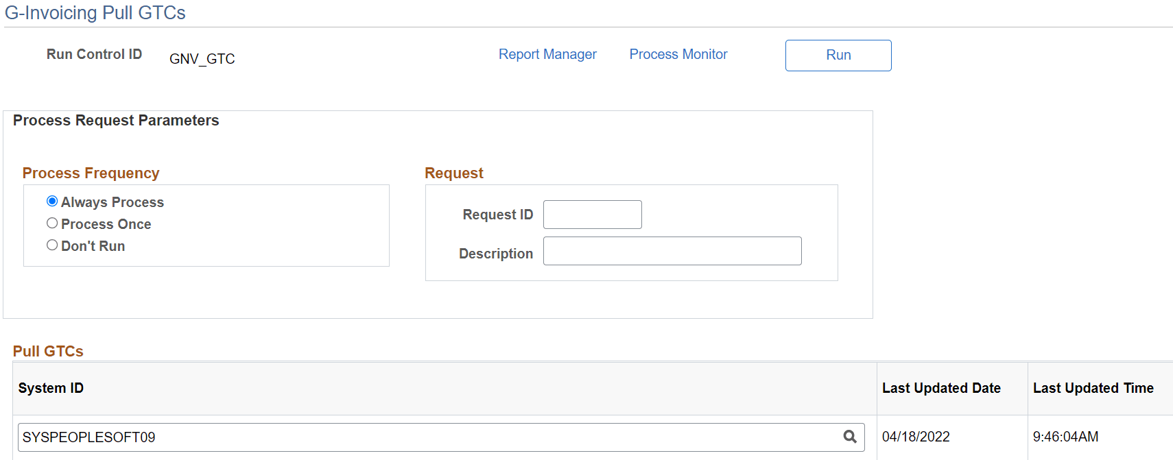

Use the G-Invoicing Pull GTCs page (PO_RUN_GINV_PROC) to run the Pull GT&Cs API which populates the View General Terms and Conditions grid. Only G-Invoice GTCs with a status of Open (REC) or Closed (CLZ) are pulled.
Navigation:
GT&Cs are entered directly into G-Invoicing and a subset of fields is pulled into PeopleSoft using this API. The GT&C Number is used for reference on purchase orders.
This example illustrates the fields and controls on the G-Invoicing Pull GTCs page. You can find definitions for the fields and controls later on this page.
Field or Control |
Description |
Run Control ID |
Enter a run control ID. |
Process Frequency |
Select how often the process should run. The available options are:
System ID |
Enter the System ID to use when pulling transactions from G-Invoicing. |
Last Updated Date and Last Updated Time |
Displays the last run date and time for the API. |

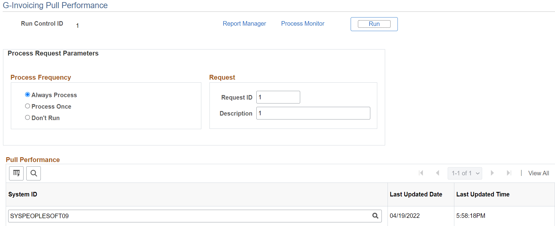

Use the G-Invoicing Pull Performance page (PO_GINV_PFM_PROC) to run the Pull Performance transactions which populates the View Performance grid.
Navigation:
This example illustrates the fields and controls on the G-Invoicing Pull Performance page. You can find definitions for the fields and controls later on this page.
Performance transactions include:
Advance payments ('548’)
Adjustments to advances (negative ‘548’)
Delivered/performed transactions (‘035’)
Adjustments to delivered/performed transactions (negative ‘035’). These transactions are for informational purposes only and no transactions are automatically created. Since the specific reason for the adjustment is unknown, these transactions need to be reviewed and determine manual correction in Purchasing as necessary.
Received/accepted transactions (‘050’)
Adjustments to received/accepted transactions (negative ‘050’)
Deferred payment transactions (‘014’). For informational purposes.
Field or Control |
Description |
Run Control ID |
Process Frequency |
System ID |

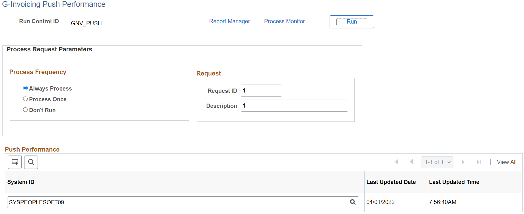

Use the G-Invoicing Push Performance page (PO_GINV_PFM_PUSH) to run the Push Performance transactions API which sends Received/Accepted transactions and adjustments to G-Invoicing.
Navigation:
This example illustrates the fields and controls on the G-Invoicing Push Performance page. You can find definitions for the fields and controls later on this page.
The following transactions are pushed back to G-Invoicing:
Received/accepted transactions (‘050’). These transactions originate from Receipts.
Adjustments to received/accepted transactions (negative ‘050’). These transactions originate from adjustments to Receipts and Return to Vendor transactions.
Field or Control |
Description |
Run Control ID |
Process Frequency |
System ID |
Note: Pull Performance must be run prior to pushing RTV and receipt adjustment transactions so that the Reference Performance Number can be populated on the ‘050’ adjustment transaction. All ‘050’ adjustments must reference the Received/Accepted transaction (‘050’) they are adjusting. G-Invoicing assigns a performance number to a ‘050’ transaction after it is pushed using the API. This performance number becomes the reference performance number for the ‘050’ adjustment.

G-Invoicing Performance Transactions classified as Delivered/Performed from the Supplier Agency are used to create Advanced Shipping Notifications (ASNs) in PeopleSoft. These ASNs become Advanced Shipping Receipts (ASRs) once loaded to Purchasing.
Performance transactions meeting the following criteria are selected for ASN creation:
Performance type is Delivered/Performed or ‘035’.
In Process flag on the Performance Inquiry table must not be Complete.
Performance transaction not previously processed into an ASR.
Performance transaction is NOT an Adjustment (Reference Performance field is blank).
The Pull Performance API loads all eligible delivered/performed performance transactions to the ASN staging tables.

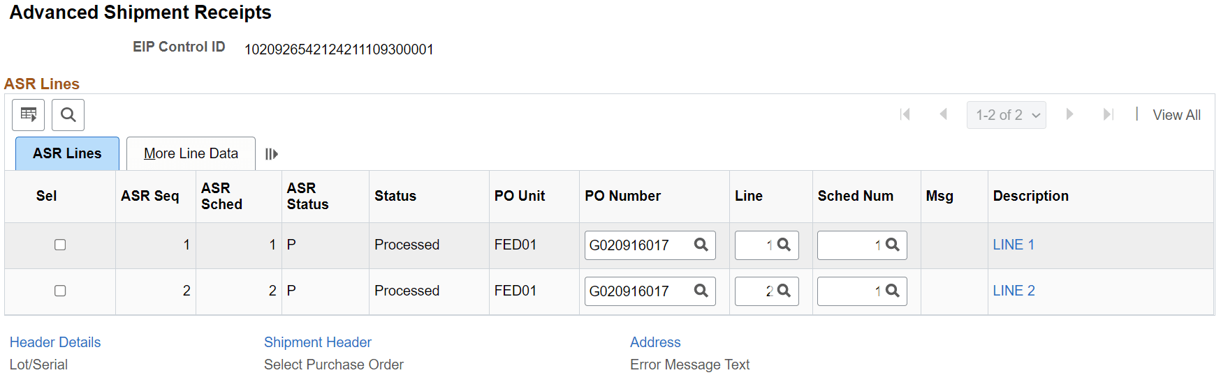

Use Advanced Shipment Receipts page (Purchasing> Receipts> Review Receipt Information> Advanced Shipment Receipts) to view the staged shipments. Use Load Purchase Order Receipts page (Purchasing> Receipts> Load Receipts) to create Receipts from the staged ASR transactions.
For additional information, see Loading Receipts Received Using EIPs and EDC
Creating G-Invoicing Receipts Manually
It is possible to bypass the ASN/ASR process and create G-Invoicing receipts manually.
Pull Performance will create ASNs for all eligible ‘035’ transactions. These transactions can either be ignored or canceled. Processing them in addition to creating a receipt manually will cause duplicate entries.
This example illustrates the fields and controls on the Advanced Shipment Receipts page
To designate the receipt as G-Invoicing so that the Push Performance API generates a ‘050’ transaction, the following fields are required to be entered:
Referenced PO ID is required and the selected PO must be designated as G-Invoicing.
Shipment Number must be entered with the exact G-Invoicing Performance Number from the Seller agency.
Invoice Number must be entered.
Ship and Receipt Date must be entered as the G-Invoicing Performance Date.
Note: All Received/Accepted (‘050’) transactions and adjustments to Received/Accepted (negative ‘050’) transactions must either be entered in PeopleSoft OR in G-Invoicing but not both. Entering ‘050’ transactions directly into G-Invoicing and PeopleSoft will cause errors and reconciliation issues.
The G-Invoicing receipts are in an open status after the Load Receipts process is run.
A user must verify and confirm the Receipt Quantity on the line as well as enter an Invoice Number. The receipt status changes to Fully Received, once saved.
Note: The Receipt Quantity entered on the PeopleSoft receipt cannot exceed the quantity that the Supplier Agency reported on the delivered/performed (035) transaction or the push back to G-Invoicing will fail.
For additional information, see Maintain Receipts - Receiving Page
Now the Receipt is eligible to be pushed back to G-Invoicing as a received/accepted (050) performance transaction. Use the G-Invoicing Push Performance page to run the Push Performance API which sends eligible receipts to G-Invoicing.
