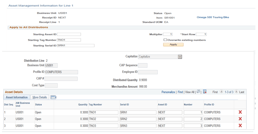

RECV_WPO_AM |
View and enter information about asset purchases. This information is passed to PeopleSoft Asset Management. This page is available for entry only if the selected receipt is targeted for PeopleSoft Asset Management. One or more of the distributions must have a PeopleSoft Asset Management business unit and AM profile designated, and optionally, other asset management data. |

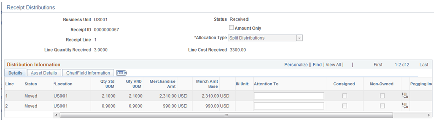

RECV_WPO_DIST |
View distribution information for the selected receipt. |

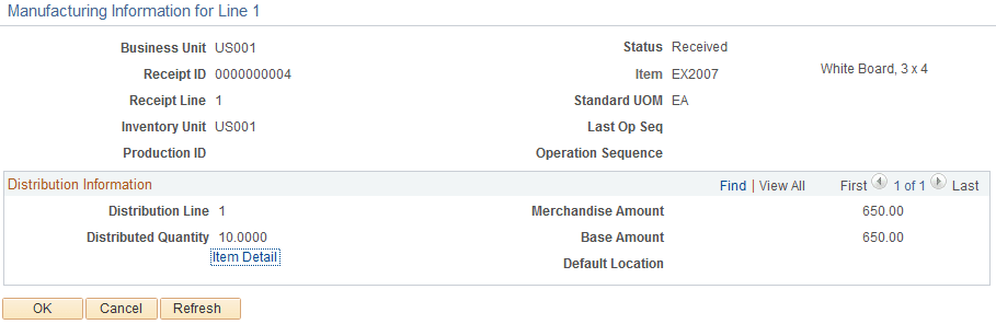

RECV_WPO_MFG |
Maintain manufacturing information for the receipt line. |

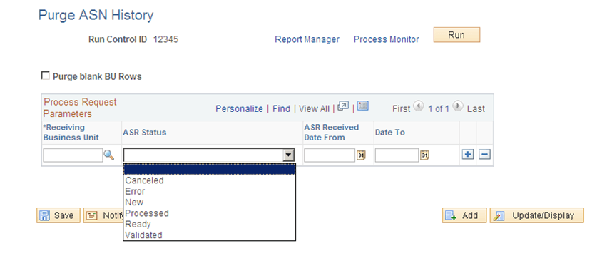

Purge ASN History Page |
RUN_PO_ASN_PURGE |
To purge the EC rows when transaction is complete |

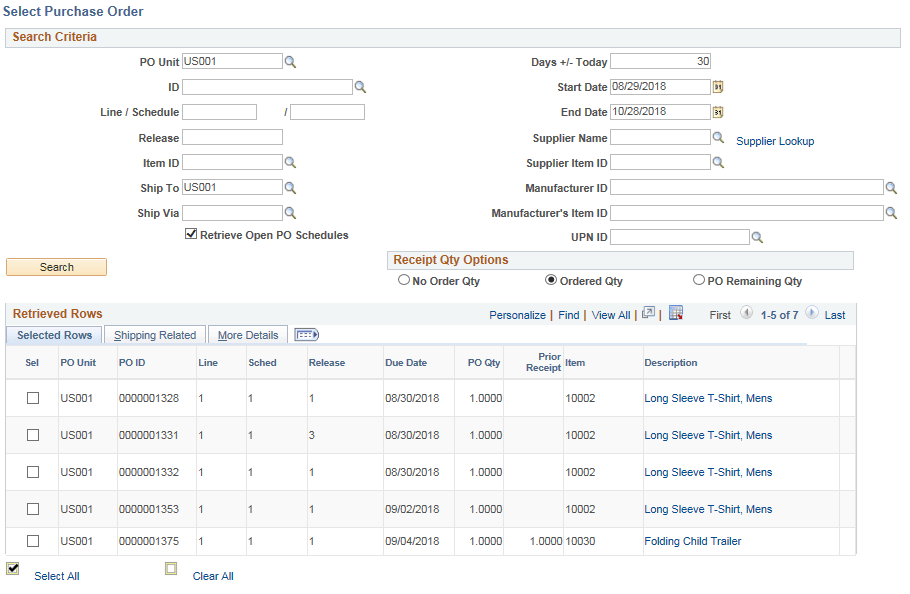

Use the Select Purchase Order page (PO_PICK_ORDERS) to search for and retrieve purchase order schedules against which to create receipts.
Select the PO Receipt check box before entering the Select Purchase Order page.
Navigation:
Purchasing, Receipts, Add/Update Receipts, select a purchase order
Click the Select Purchase Order link on the Maintain Receipts - Receiving page.
This example illustrates the fields and controls on the Select Purchase Order page. You can find definitions for the fields and controls later on this page.
Note: This page is only available if you select the PO Receipt check box on the Add/Update Receipt dialog box.
The search functionality of this page enables you to perform a broad or narrow search on purchase orders based on a variety of search criteria. You can use one or all of the available fields. After the search retrieves a list of purchase order line and schedules that meet the search criteria, you can select the purchase order line and schedules and have the system place them on the transaction document.
Field or Control |
Description |
PO Unit (PeopleSoft Purchasing business unit) |
Select the business unit. |
ID |
Enter the purchase order number or purchasing contract number. Entering a contract ID retrieves all of the purchase order schedules associated with the contract. Note: The open purchase order schedules is controlled by the Retrieve Open PO Schedules check box. |
Line and /Sched Num (schedule number) |
Enter the purchase order line and schedule numbers. |
Release |
Enter the release number of the contract associated with the item, if applicable. |
Retrieve Open PO Schedules |
Select this check box to retrieve only purchase order schedules that haven't been fully received. If you do not select this check box, purchase orders that have been fully received appear in the search, as well as purchase order schedules that haven't been fully received. |
Days +/- Today |
Enter a value to further restrict or expand the number of purchase order schedules that appear within the start date and end date values. This value is added or subtracted from the current date to calculate the start date and end date values. The default value appears from the User Preferences - Procurement: Receiver Setup page. You may also enter the start date and end date. The system will select all schedules whose due date falls on or between the two dates. |
Start Date and End Date |
Used as a comparison against the purchase order due date to determine which schedules are retrieved. These values appear by default to the current date plus or minus the value in the Days +/- Today field. |
UPN ID (Universal Product Number Identifier) |
Enter a UPN ID, which is one of the search criteria to retrieve the PO Line. |
Receipt Qty Options
Select No Order Qty (no order quantity), Ordered Qty (ordered quantity), or PO Remaining Qty (purchase order remaining quantity) to determine the receipt quantity to appear. These fields specify quantities to transfer to the receipt. Accessibility to these fields is determined by the user's blind receipt authorization set on the User Preferences - Procurement: Receiver Setup page.
Field or Control |
Description |
No Order Qty (no order quantity) |
Select this option to signify that the receiver must enter the actual quantity received. This selection requires a live count of the items prior to receipt in the system. If selected, the copy function does not transfer order quantities to the receipt. You will need to manually enter all receipt quantities. |
Ordered Qty (ordered quantity) |
Select this option to automatically make the received quantity the purchase order quantity. This selection makes the receipt quantity the purchase order quantity regardless of any prior receipt quantity. |
PO Remaining Qty (purchase order remaining quantity) |
Select this option to have the receipt display the numeric difference between the quantity ordered and the current quantity received. Selecting this option replaces the received quantity with the quantity that has not yet been received. |
Search |
Click this button to display purchase order lines and schedules that match the entered criteria in the Retrieved Rows group box. |
Retrieved Rows
In this group box, all the purchase order lines and schedules that match the search criteria appear.
Selected Rows
Field or Control |
Description |
Sel (select) |
Click this check box next to a purchase order line to work with a particular line. You can select multiple schedules at once when this page is accessed from the Maintain Receipts - Receiving and Return To Vendor pages. |
Prior Receipt |
Displays the number of items already received. |
Shipping Related
Select the Shipping Related tab.
Field or Control |
Description |
Orig Prom (original promise date) |
This values appears by default from the purchase order schedule and contains the purchase order schedule original due date. |
More Details
Select the More Details tab.
Field or Control |
Description |
UPN Type |
Displays the UPN Type for the PO line. |
UPN ID |
Displays the UPN ID for the PO line. |
PO Amount (purchase order amount) |
Displays the monetary value of the merchandise on the selected purchase order line. |
Recv Reqd (receiving required) |
Displays whether receiving is required for this item. Values are:
If receiving is required, the item is subject to any receiving tolerances defined for the item. |
Rcv Tol % (receiving tolerance percentage) |
If tolerance is activated for the receipt of this item, the tolerance percentage appears. This percentage determines how much of an over shipment is allowed without having to reject items. |
Price |
Displays the unit price of the item on the selected purchase order line. |

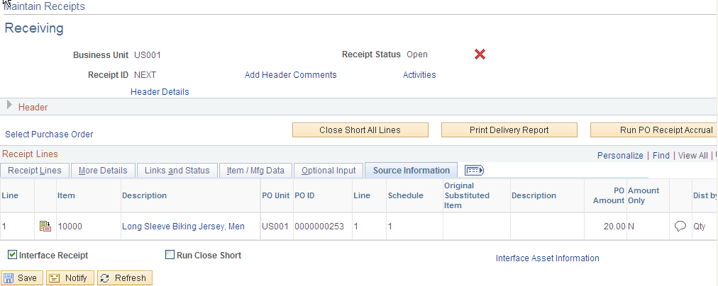

Use the Maintain Receipts - Receiving page (RECV_WPO) to create receipts for non-purchase order and purchase order line items.
Navigation:
(PO receipt) Select a purchase order line on the Select Purchase Order page and click the OK button.
This example illustrates the fields and controls on the Maintain Receipts - Receiving Page. You can find definitions for the fields and controls later on this page.
Note: If a supplier sent you ASR information using electronic data exchange and the receipts have already been created by the Receive Load process, the receipt information appears in the scroll area for your review in Update/Display mode.
Field or Control |
Description |
Header Details |
Click this link to access the Maintain Receipts - Header Details page. Use this page to view and enter receipt header information. |
Receipt Status |
Status of the receipt header. Values are: Closed (closed receipt) Hold (hold receipt) Moved (moved to destination) Open (open) Received (fully received) Canceled (canceled) |
Click the Cancel Receipt button to cancel the entire receipt. Canceling the transaction cannot be reversed. |
Add/Edit Comments |
Click to access the Maintain Receipts - Receipt Header Comments page. Use this page to add header level comments that will be associated with this receiver ID. Once comments are added, the link will be displayed as Edit Comments. Click the link to add additional header level comments or to review existing ones. You can also upload one or more supporting documents to the header comments. The system displays an error message if you try to load more than the number of attachments specified on the Installation Options - Multiple Attachments Page for Purchasing product. |
Activities |
Click this link to access the Maintain Receipts - Activities page. Use this page to add or review activities associated with the receipt header. |
Document Status |
Click this link to access the Receipt DOC Status page. Use this page to review information about procurement documents associated with the receipt. |
Header
Field or Control |
Description |
Supplier ID, Supplier Location, and Ship To Location |
Select the supplier ID, supplier location, and Ship To location for the non-purchase order receipt item. These fields must be entered before you can continue with a non-purchase order receipt. For purchase order receipts these fields are display only and appear by default from the purchase order. |
Close Short All Lines |
Click to select the Close Short check box for all eligible receipt lines in the Receipt Lines grid box. Then, you can click the Run Close Short check box at the bottom of the page to initiate the closing of purchase orders at the time of receipt. If the Run Close Short check box is selected when the receipt is saved, and one or more of the receipt lines have the Close Short check box selected, the Receipt Push process (PO_RECVPUSH) process calls the Close Short (PO_CLSSHORT) process. The Receipt Push process deselects the Run Close Short check box after the Close Short process has run. You can also run the Close Short process using the Close Short menu option. You can also include receipts created using mobile devices when the Close Short process is run. When you save the receipt in the Mobile Inventory Management application and the Receipt Push process runs, the process calls the Close Short process to create the close short transactions for the purchase orders included in the receipt. See Understanding How to Receive Stock in PeopleSoft Inventory Using Mobile Receiving. You select the Run Close Short check box on the User Preferences Receiver Setup page to provide users with permission to close a purchase order. |
Print Delivery Report |
Click this button to save the currently entered receipt information and initiate the RECV_DEL multi-process job in the same business event. The RECV_DEL multi-process job contains the Receipt Delivery (PO_RECVDELV) application engine process that gathers data for the Receipt Delivery Detail report (receiving data along with purchase order header and line comments) and the Receipt Delivery Detail (POY5030) report that produces a report from the gathered information. Note: This job can also be activated from a mobile device using the Mobile Inventory Management application. See Understanding How to Record Deliveries in PeopleSoft Purchasing Using Mobile Inventory Management. |
Run PO Receipt Accrual |
Click this button to access the Accrue Receipt page where you can run the Receipt Accrual process, the Miscellaneous Charges process, or both. The button is only available if the receipt has been saved and is eligible for accrual. Note: An error will appear if Do Not Generate Reversal is not selected as the reversal code on the Journal Generator Template. |
Select Purchase Order |
Click this link to access the Select Purchase Order page. Use this page to search for and retrieve purchase order schedules against which to create a receipt. |
Receipt Lines
Receipt lines display in this group box for the purchase order lines selected on the Select Purchase Order page.
Field or Control |
Description |
Click the Details button to access the Receipt Line Details for Line page, where you can view details about the receipt. This page formats the information you see here and on the subsequent tabs in a single long page format. |
Description |
If you are receiving against a purchase order, the item selected and its description will be displayed. If you are entering a non-purchase order receipt, you can enter an existing item ID and a description and category will be displayed. If you have the authority to change a non-purchase order receipt price, you can enter just a description for the item you are receiving. After you enter the description for the item, the Category field is available for entry. |
This icon appears on a transaction line whenever the ‘Original Substituted Item field’ is populated. This indicator helps the Requester or Buyer to know whether the item has been substituted. If Original Substituted Item and Description are already displayed in the component, i.e. Requisition and PO, a text ‘Substitute Item in Use’ and the Original Substituted Item and Description fields will appear. If the Original Substituted Item and Description fields are not displayed anywhere in the component, click on the icon to view another page displaying these values |
Original Substituted Item and Description |
The ‘Original Substituted Item’ field displays the original Item ID on the transaction line that was replaced when a Substitute Item was found. Once the field is populated, the original Item ID will not be overridden with another Item ID If the Item ID field is changed directly by the Requester or Buyer, the ‘Original Substituted Item’ field is cleared out. Similarly, if the Supplier ID/Location field is changed by the Requester or Buyer, then the value in the ‘Original Substituted Item’ field is cleared and the value is moved back to the Item ID field These fields are displayed from the Requisition through to the PO. However, these fields do not appear in case of online update by the Requester or Buyer. The Original Substituted Item Description field displays the Item Description for the Original Substituted Item, if the field is populated When using ‘Copy From’ to copy a Requisition into a new Requisition or a Purchase Order into a new Purchase Order, the ‘Original Substituted Item’ for each transaction line is cleared out and the value is moved back to the Item ID field. When using ‘Copy From’ to copy a Requisition into a Purchase Order, values remain the same |
Receipt Price |
When an item is received against the purchase order, the item's purchase order price is displayed in the receiving unit of measure. If you are entering a non-purchase order receipt and have specified an item ID, the item's purchasing item attributes price is displayed. If you have the authority to change a non-purchase order receipt price, you can make modifications here. Additionally, if you entered a description only item, you would enter the price here. When the price is changed the new price will be used to recalculate transaction and base merchandise amounts on the receipt line. Note: The item description, price, and category will no longer be available for modification once the non-purchase order receipt line has been moved to inventory, moved to assets, or accounts payable matching has fully or partially matched a voucher. |
Receipt Qty (receipt quantity) and Recv UOM (received unit of measure) |
Enter the quantity delivered and the UOM in which it was received. When you enter the receipt quantity for a line, the Accept Qty value is calculated by subtracting the rejected quantity from the receipt quantity. If you are using the supplier rebate functionality, you can still change the receipt quantity that was previously entered, even if there are accrued rebate transactions tied to this receipt with a vendor rebate claim. However, in this case the rebate accrual transaction won't be recalculated but a workflow and/or email notification will be sent to the rebate manager. After reviewing the changes, the rebate manager must decide whether manual actions, such as adjusting the subsequent claim amount, is required. If there are no accrued rebate transactions you can change the receipt quantity and the Rebate Accruals process will recalculate the rebate accrual transaction. |
Click the Copy quantity down button to enter the same Receipt Qty (received quantity) value on the selected line to all Receipt Qty fields for all subsequent lines. |
Accept Qty (accepted quantity) |
Displays the quantity of items accepted. When you enter a Receipt Qty value for a line, the accepted quantity is calculated by subtracting the rejected quantity from the receipt quantity. |
Status |
Displays the status of the receipt line. Closed (closed schedule) Hold (hold schedule) Open (open schedule) Received (received schedule) Canceled (canceled schedule) |
Category |
If you have entered a description only for a non-purchase order receipt line item, select the category to associate with the item. |
Close Short |
Select to indicate that you want to include this receipt line when the Close Short process is run. When you select the Run Close Short check box and if one or more receipt lines are selected, the Receipt Push process calls the Close Short process to create the close short transactions for the purchase orders. After the Close Short process is run, the system deselects the Run Close Short check box. To select all eligible receipt lines, click the Close Short All Lines button on the receipt header. |
Serial |
Identifies if the receipt line is serial controlled. If you are receiving a description-only purchase order line (no item ID) and the line is asset-related, the serial check box can be selected. For serial-controlled items, you must enter the serial ID at the time of receipt or the receipt line status stays in the Open status and is not eligible for interfacing to inventory or assets. |
Device Track |
Indicates whether a receipt line is device tracked. The default value is selected and unavailable for device-tracked items unless they are description only (no item ID). The field is available for items that are description only. |
AM Status (asset management status) |
Displays the status of the item data in relation to PeopleSoft Asset Management. Values are: Pending: Indicates that the receipt line is asset-related and is pending interface with PeopleSoft Asset Management. Click the link to access the Asset Management Information for Line page where asset information can be recorded. Moved: Indicates that the receipt line has been interfaced to PeopleSoft Asset Management. If the receipt line is not asset-related this field is blank. |
INV Status (inventory move status) |
Displays the item status in relation to PeopleSoft Inventory. Values are: Pending: Indicates that the receipt line is inventory-related and is pending interface with PeopleSoft Inventory. Click the link to access the Inventory Putaway Information for Line page where storage location information can be reviewed or entered. Moved: Indicates that the receipt line has been interfaced to PeopleSoft Inventory. If the receipt line is not inventory-related this field is blank. |
Receipt Line Comment |
Select to accesses the Receipt Line Comments page where you can add comments and upload one or more supporting documents. The system displays an error message if you try to load more than the number of attachments specified on the Installation Options - Multiple Attachments Page for Purchasing product. |

Interface Receipt |
This check box setting appears by default from the selection of this field on the User Preferences - Procurement: Receiver Setup page. Select this check box if you want to automate the passing of inventory, asset, and manufacturing information through the receiving process. If the Interface Receipt check box is selected on the receipt, then one of the multiprocess jobs is submitted to the process scheduler upon saving the receipt. The type of receipt related lines determine which job is submitted by the system. |
Run Close Short |
Select to run the Close Short process when you save this receipt. When you select the check box and save the receipt, and one or more of the receipt lines have the Close Short check box selected, the Receipt Push process (PO_RECVPUSH) process calls the Close Short (PO_CLSSHORT) process. The Receipt Push process deselects the Run Close Short check box after the Close Short process has run. You can also run the Close Short process using the Close Short menu option. You select the Run Close Short check box on the User Preferences Receiver Setup page to provide users with permission to close a receipt short. |
Subcontract Streamline |
This check box will appear at the bottom of the page if one or more of the receipt lines is subcontracted related. This check box indicates you want to use the streamline processing between purchasing receiving and subcontract completions in manufacturing. If selected during online receiving, the system will perform the purchase order receipt and the production completion in one step rather than multiple steps. If the receipt is subcontracted related, this check box setting appears by default from the selection of this field on the User Preferences - Procurement: Receiver Setup page. This check box will be cleared and unavailable if:
Also, you will not be able to change this check box setting if the source for the receipt is data collections. If the Interface Receipt check box and the Subcontract Streamline check box are both selected on the receipt, then one of the multiprocess jobs is submitted to the process scheduler upon saving the receipt. The type of receipt related lines determine which job is submitted by the system. |
Interface Asset Information |
Click this link to access the Pre-AM1 page. Use this page to preview and correct data that is being sent to PeopleSoft Asset Management. |

Manufacturer Information
Field or Control |
Description |
IN Unit (PeopleSoft Inventory business unit) |
Displays the PeopleSoft Inventory business unit value used for PeopleSoft Manufacturing-related transaction. |
Operation Sequence |
Displays the operation sequence of the PeopleSoft Manufacturing-related transaction. This is the manufacturing subcontracted operation for which the outside processing service was performed. |
Production ID |
Displays the production ID of the PeopleSoft Manufacturing-related transaction. This is the production ID for which the outside processing services were performed. |
Revision |
Displays the revision number of the item if applicable. |
Manufacturer ID |
Displays the item's manufacturer ID. |
Manufacturer |
Displays the name of the manufacturer. |
Model |
Displays the model of the item. |
Mfg Itm ID (manufacturing item ID) |
Displays the manufacturer item ID for the item. |
Configuration Code |
Displays the identification code assigned to specific configuration details for the items, if applicable. |

Use the Asset Management Information for Line page (RECV_WPO_AM) to view and enter information about asset purchases.
This information is passed to PeopleSoft Asset Management. This page is available for entry only if the selected receipt is targeted for PeopleSoft Asset Management. One or more of the distributions must have a PeopleSoft Asset Management business unit and Asset Management profile designated, and optionally, other Asset Management data.
Navigation:
Click the Asset Management Status Pending or Moved link under the Receipt Lines tab of the Maintain Receipts - Receiving page.
If available, this link appears in the Asset Management Status column in the grid section of the Maintaining Receipts - Receiving page.
Example of Asset Management Information for Line Page for Split Distributions.
This example illustrates the fields and controls on the Asset Management Information for Line page. You can find definitions for the fields and controls later on this page.
Note: If the defaults for the asset purchases are setup in such a way that you do not need to override them during the receiving process, it is not necessary to access the Assets pages in PeopleSoft Asset Management. These rows are generated and populated with defaults at save time. However, if the receipt line is serial controlled, you must supply the appropriate required information.
If the purchase order distribution has a PeopleSoft Asset Management business unit and asset profile ID specified, the receipt items are identified as asset purchases. Use this page to enter or override default asset information to be sent to PeopleSoft Asset Management.
If the item being received requires serialization, the number of rows generated is equal to the distribution quantity converted to the standard unit of measure.
If the item does not require serialization, then one row is generated with a quantity equal to the distribution quantity.
The asset rows populate automatically when the receiving agent accesses the Asset Management Information for Line page.
Use this page to accommodate split-funded assets. For example, if you purchased a vehicle to be shared by three departments, use this page to split-fund the vehicle between the departments. This can occur only if the purchased vehicle is an asset and is not inventory-related, meaning there is no inventory business unit specified for it on the purchase order distribution. In this scenario, a single asset tag number is assigned to the vehicle and associated with each of the three department distributions
In addition, if the receipt line is serial controlled, the system verifies the following for the selected receipt line:
The sum of interface record quantities for any given serial ID is 1.
Only one Asset ID is assigned to any given serial ID on the receipt line.
Only one tag number is assigned to any given serial ID on the receipt line.
Field or Control |
Description |
Next Asset ID |
Click this button to temporarily assign a value of AUTO-ASSIGN as the line item asset ID value. This value is replaced with the next available asset ID value upon saving the receipt. Note: This button is hidden when the Split Distributions receipt allocation type is in effect since the grouping of assets requires special handling for Split Distributions. |
Use One Asset ID |
Click this button to group multiple receipt distribution lines into a single Asset Identification. Note: This functionality is not available if the receipt line has a single distribution only. Furthermore, this button is hidden when the Split Distributions receipt allocation type is in effect since the grouping of assets requires special handling for Split Distributions. |
Distribution Information
Field or Control |
Description |
Business Unit |
PeopleSoft Asset Management business unit associated with the selected distribution line. The PeopleSoft Asset Management unit can be entered for new non-purchase order receipts, but cannot be changed once the receipt has been saved. |
Profile ID |
Displays the identifier for the receipt item product profile defined in PeopleSoft Asset Management. |
CAP # (capital acquisition planning number) |
Displays the capital acquisition plan identifier. This identifier is defined in PeopleSoft Asset Management. |
Cost Type |
Displays the cost type code for the receipt item, if applicable. Cost types represent different components of the cost of an asset, such as materials, labor, and overhead. For example, you can differentiate between the cost of building an asset and its market value by allocating the cost of production to one cost type and the margin of profit to another cost type. Cost type, in combination with asset category and transaction code, determines into which accounts the costs are entered in the general ledger. |
Capitalize |
Designates whether or not the receipt item is capitalized. Values are: Non Cap(not a capitalized asset) Capitalize (capitalized asset) |
CAP Sequence (capital acquisition planning sequence) |
Displays the sequence number for the capital acquisition plan. |
Apply to All Distributions
(Displayed for FIFO, Prorate, and Specify allocation types)
Field or Control |
Description |
Assign Tag ID and Assign Serial ID |
If the receipt line is serial controlled, both the Assign Serial ID and Assign Tag ID options are available. If the receipt line is not serial controlled, only Assign Tag ID is available. |
Enter Starting Number |
If you assign serial IDs, this represents the starting serial ID, which is assigned to the first detail row and is indicated by the Start Row field. If you assign tag IDs, this represents the starting tag ID, which is assigned to the first detail row and is indicated by the Start Row field. |
Multiplier |
Enter the number multiplier. The system used this value to increment the starting number from detail row to detail row. |
Start Row |
This is a required field and automatically changes to a value of 1. Indicate the detail row to use as the starting point for assigning values that are determined by the starting number and multiplier. |
Overwrite existing numbers |
Select to override existing values in the detail grid rows for either the tag ID or serial ID, depending on which action is selected (Assign Tag IDs or Assign Serial IDs). |
Apply |
Click this button to assign values to the detail rows in the grid. When you click this button, the system uses the Starting Tag and/or Starting Serial ID’s and/or Starting Asset ID to the receipt asset lines under first distribution and then repeat the exact same assignment across the remaining distributions associated with the receipt line. |
(Displayed for Split Distributions allocation type)
Field or Control |
Description |
Starting Asset ID |
Enter the Asset ID to be applied to the first asset line on all the distributions for the receipt line. |
Starting Tag Number |
Enter the tag number to be applied to the first asset line on all the distributions for the receipt line. |
Starting Serial ID |
Enter the Serial ID to be applied to the first asset line on all the distributions for the receipt line. |
Multiplier |
Start Row |
Select to override existing values in the detail grid rows depending on which starting IDs or numbers are entered (Starting Asset ID and/or Tag Number and/or Serial ID). |
Apply |
Click this button to assign values to the detail rows in the grid When you click this button, the system uses the Starting Asset ID and/or Starting Tag and/or Starting Serial ID, the multiplier, and the start row values to determine how values are assigned to the grid. The system assigns the values to the asset lines under the first distribution and then repeats the same assignment across the remaining distributions associated with the receipt line so that each split unit is assigned the same values. |
Asset Information
Field or Control |
Description |
AM Business Unit (PeopleSoft Asset Management business unit) |
Displays the PeopleSoft Asset Management business unit. |
Status |
Displays the receipt asset row status. Identifies whether or not this specific asset row has been passed to the PeopleSoft Asset Management system. One asset row can have a status of Moved and another row on the same distribution can have a status of Open. |
Quantity |
Displays the quantity assigned to the asset row. If the receipt line is serial controlled, the quantity is not available for change. Note: The sum of the quantities on the asset rows must equal the distributed quantity on the receipt. |
Tag Number |
Enter the asset tag number for the asset row. If you enter the tag number value on the purchase order distribution, those values appear by default from the purchase order distribution. In addition, the system checks the tag number that you entered on the receipt to make sure it is not already assigned to an asset, when the Allow Dup Tags option is not set for the PeopleSoft Asset Management business unit. If the tag number has already been assigned to another asset the system gives you a warning message. The system only looks at the Assets table it does not look at the interface tables, previously entered receipts, purchase orders, or requisitions to see if the tag number has been assigned to another pending transaction. |
Serial ID |
Serial ID for the distribution sequence. This field is available for entry only when the Serial option is selected for the selected line on the Maintain Receipts - Receiving page. |
Asset ID |
Asset ID for the asset row. The default value is NEXT. If you do not override this value, NEXT is passed to PeopleSoft Asset Management, where the next asset ID is assigned. You may choose to override the NEXT value and manually enter an asset ID or assign one by using the Next Asset ID button. If the Asset ID value is anything other than NEXT and the same Asset ID value is assigned to multiple asset rows for the selected receipt line, then these asset rows must all have the same custodian, location, model, and manufacturer values as well. |
Number (sequence number) |
When the Asset ID is NEXT, this field facilitates the grouping of multiple asset lines under the same asset. All asset lines across all distributions with the same number in this field will be assigned to the same asset. |
Profile ID |
Identifier for the receipt item product profile. This value is not available for change by the receiving agent and is populated by the value on the receipt distribution. |
Click the Cancel Row button to cancel this asset row information. This row is a child of the distribution line. If the receipt has not been interfaced, this asset row is not be interfaced and is deleted during receipt interface processing. If the receipt has been interfaced, then a retirement asset transaction is passed to PeopleSoft Asset Management. |
More Details
Field or Control |
Description |
VIN |
(Optional) Enter the VIN number for each individual serial receipt. Only one VIN can be assigned to each serial ID. Note: This field is available only if you are receiving a serial-controlled item and the Asset Type associated with the item and asset profile is FLEET. |
Custodian |
Enter the recipient of the asset item on the selected distribution sequence. If the asset ID value is anything other than NEXT and the same asset ID value is assigned to multiple asset rows for the selected receipt line, then this value must be the same on those same asset rows. |
Location |
Select the delivery location for the distribution sequence. If the asset ID value is anything other than NEXT and the same asset ID value is assigned to multiple asset rows for the selected receipt line, this value must be the same on the asset rows. |
Mfg ID (manufacturer ID) |
The manufacturer ID for the item appears by default from the manufacturer ID assigned to the purchase order line using the Maintain Purchase Order - Details for Line page. You can also select a manufacturer ID if one is not displayed. Once you select a manufacturer ID the description for the manufacturer appears in the Manufacturer field. |
Model |
The model appears by default from the model associated with the item on the Purchasing Attributes - Purchasing Attributes page. If a model does not appear, you can modify or select the model of the product. If the asset ID value is anything other than NEXT and the same asset ID value is assigned to multiple asset rows for the selected receipt line, this value must be the same on the asset rows. |
Manufacturer |
Select the manufacturer of the product. If the asset ID value is anything other than NEXT and the same asset ID value is assigned to multiple asset rows for the selected receipt line, this value must be the same on the asset rows. Note: If a manufacturer ID is entered for the line then you will not be able to select a Manufacturer. If the manufacturer ID field is blank then you can select a manufacturer using this field. |
Capitalize |
Displays whether or not the receipt item is capitalized. Appears by default from the value of the parent distribution row, but can be overridden by validation edits. |
PO Comment
Displays the purchase order line comments for the selected item. Information such as the asset tag numbers can be entered upon creation of the order.
Validations Edits
Edits and validations are performed when you click the OK button on the Asset Management Information for Line page. Capitalization to asset ID cross-edits ensures that the capitalization flag is either on or off for all asset rows for a given asset ID. Rows with an asset ID of AUTO-ASSIGN or NEXT are not included in the edit. However, the row with an asset ID of NEXT and a sequence number value (NEXT1, NEXT2, and so forth) will be included in the edit. If a combination of on and off capitalization flags are detected for one asset ID, a message appears requiring an action to be selected.
If you select Yes on the message prompt, the system turns on the capitalization flag for all asset rows with the same asset ID.
If you select No on the message prompt, the system turns off the capitalization flag for all asset rows with the same asset ID.
The original capitalization flag value copied from the purchase order distribution remains on the receipt distribution. Only the receipt line asset row changes.

Split Distributions
For serialized items, the Split Distributions receipt allocation type directs online Receipts to split each unit (i.e. quantity of 1) across all the distributions according to the distribution percentage. Each split unit will automatically be assigned the same asset grouping sequence number so PeopleSoft Asset Management will assign the same Asset ID to each fractional unit.
Example of Split Distributions for Serialized Items
If the receipt line has a quantity of 3 and there are 2 distribution lines with the first allocating 70% to fund F100 and the second allocating 30% to F200, each unit will be split so that a quantity of .7 is assigned to the receipt asset line for the first distribution and .3 is assigned to the receipt asset line under the second distribution.
After the quantity is split across all the distributions, the system will then automatically assign a Number (i.e. asset sequence number) of 1 to the asset lines which represent the first unit so that they are assigned to the same asset ID downstream by PeopleSoft Asset Management. The remaining 2 units are broken down the same way and assigned the next sequence number (i.e. 2 and 3). The end result is 3 receipt asset lines under the first distribution with a quantity of .7 and an asset sequence number of 1 through 3, and 3 receipt asset lines under the second distribution with a quantity of .3 and an asset sequence of 1 through 3 as well. In other words, there will be 3 assets assigned to each split unit.
Distribution |
Asset Line |
Asset Line Qty |
Fund |
Tag |
Serial ID |
Asset ID |
1 |
1 |
0.7 |
F100 |
T1 |
S1 |
NEXT1 |
1 |
2 |
0.7 |
F100 |
T2 |
S2 |
NEXT2 |
1 |
3 |
0.7 |
F100 |
T3 |
S3 |
NEXT3 |
2 |
1 |
0.3 |
F200 |
T1 |
S1 |
NEXT1 |
2 |
2 |
0.3 |
F200 |
T2 |
S2 |
NEXT2 |
2 |
3 |
0.3 |
F200 |
T3 |
S3 |
NEXT3 |
Note: The Asset ID in the table above represents the default value of NEXT appended to the Number field on the Asset Management Information page. In the example above, there are to be 3 separate system generated Asset IDs.

Use the Maintain Receipts - Receipt Distributions for Line page (RECV_WPO_DIST) to view distribution information for the selected receipt.
Navigation:
Click the Distribution button under the Links and Status tab of the Maintain Receipts - Receiving page.
You can also access the Custom Field by clicking the Distribution button. The Custom Field link appears on the Details Tab. You can click the Custom Field to enter the custom related information.
The user definable fields in this Custom Fields section are available when you check the Enable Custom Fields check box on the Purchasing Installation Options page. You can customize these fields for your use. The custom fields are informational only.
This example illustrates the fields and controls on the Maintain Receipts - Receipt Distributions for Line page. You can find definitions for the fields and controls later on this page.
For More information See Understanding User-Definable Fields
Field or Control |
Description |
Allocation Type |
Displays the allocation type for the receipt. This field appears by default from the Maintain Receipts - Receiving page. This field becomes available if there are multiple distributions for a schedule. Values are: FIFO (first-in-first-out): Allocations to the receipt distributions are fulfilled based on the sequence in which they are added to the purchase order schedule for purchase order receipts or the receipt line for non-purchase order receipts. Prorate: Allocate the receipt amount across the distributions for the schedule based on what percentage the purchase order distribution amount is of the purchase order schedule amount for purchase order receipts. Specify: Allocate the receipt amount or quantity across multiple distributions for the schedule based on the quantity or amount that you enter for the distribution lines. When you select this value, the Qty Std UOM or the Amount field become available for entry. Split Distributions: This behaves just like the prorate type for non-serialized items. The receipt quantity is allocated to the distributions in the same manner as the prorate type and the resulting receipt asset lines are all assigned to same asset. For serialized items, each individual unit is split across all the distributions and grouped together under a separate asset. Note: The Prorate and Split Distributions allocation types are hidden when the item is designated for inventory. |
Details
Field or Control |
Description |
Line |
Displays the distribution line number. |
Status |
Displays the status of the distribution row. |
Location |
Enter the location to where the goods are to be delivered. |
Qty Std UOM (quantity in the standard unit of measure) |
Displays the quantity of items being distributed, expressed in the standard UOM. If you select an allocation type of Specify, enter the quantity received across the multiple distribution lines. |
Qty VND UOM (quantity in the supplier's unit of measure) |
Displays the quantity of items being distributed, expressed in the supplier UOM. |
Amount |
Displays the merchandise amount for the distribution row in the transaction currency. If you select an allocation type of Specify, enter the amount received across the multiple distribution lines. |
Currency |
Displays the transaction currency code. |
Base Amt (base amount) |
Displays the merchandise amount for the distribution row in the base currency code. |
Currency |
Displays the base currency code which is used by general ledger, inventory, and asset integration. |
If the item is an inventory item, it displays the PeopleSoft Inventory business unit associated with the item. |
Attention To |
Enter the name of the person who should receive the line item. This field defaults to the name entered in the Attention To field on the PO Distribution Line page when the purchase order was created. |
Consigned |
Designates whether the item is consigned or not. You may override the setting on this page for non-purchase order items only. This setting can only be overridden if it appears by default from the item as consigned. If the setting changes to not consigned, this setting cannot be overridden. |
Non-Owned |
Designates whether an item is owned or non-owned. This value is set at the item level. An item is non-owned if it is maintained in inventory but is not owned by the associated business unit. |
Click the PO Distribution Details button to access the PO Distribution Details page where you can view the details of the purchase order distribution and also set up the Custom Field. Click on the Custom field link to access the Custom Field page to set up the custom details. The user definable fields in this Custom Fields section are available when you check the Enable Custom Fields checkbox on the Purchasing Installation Options page. You can customize these fields for your use. The custom fields are informational only. . For more information on Custom Fields SeeUnderstanding User-Definable Fields |
Click the Pegging Inquiry button to access the Pegging Workbench page. Use this page to view details associated with the pegged distribution. |
See Pegging Inquiry Page.

Use the Maintain Receipts - Manufacturing Information for Line page (RECV_WPO_MFG) to maintain manufacturing information for the receipt line.
Navigation:
Click the Manufacturing Info button under the Item / Mfg Data tab of the Maintain Receipts - Receiving page.
This example illustrates the fields and controls on the Maintain Receipts - Manufacturing Information for Line. You can find definitions for the fields and controls later on this page.
This page contains three types of information. At the top of the page, the details for the receipt line pertaining to manufacturing appear. In the Distribution Information group box, the receipt distribution details appear along with the default inventory putaway location and other inventory details.
Note: The Putaway Information grid appears only when the Operation Sequence field and the Last Op Seq (last operation sequence) field are equal.
Field or Control |
Description |
Item |
Displays the item related to the manufacturing information. When the receipt line is subcontracted related, the assembly item ID (manufactured item) and its description appear. |
Last Op Seq (last operation sequence) |
Displays the last operation sequence for the production ID. |
Displays the operation sequence for the subcontracting operation on the production ID. |
Production ID |
Displays the manufacturing production ID. When the receipt line is subcontracted related, the production ID that contains the subcontracting operation appears. |
Field or Control |
Description |
Item Detail |
Click this link to access the Inventory Item Information page. Use this page to view the detailed inventory information entered for an inventory-related item. |
Default Location |
Displays the default inventory putaway location for the inventory business unit and item ID. |
Putaway Information
Use this section of the page to enter the putaway inventory information for a receipt that is subcontracted related.
Field or Control |
Description |
Status |
Displays the status of the last operation. Values are: Open or Canceled. |
Serial ID |
Select the serial ID for the assembly. This field is not available for non-serial controlled items. |
Lot ID |
Select the lot IDs for the assembly. This field is not available for non-lot controlled items. |
Click the Cancel Row button to cancel the detail row. |

Use the Purge ASN History Page (RUN_PO_ASN_PURGE) to purge the EC rows when transaction is complete
Navigation:
This example illustrates the fields and controls on the Purge ASN History page. You can find definitions for the fields and controls later on this page.
Field or Control |
Description |
Receiving Business Unit |
Provides the Receiving Business unit the user is authorized for. |
ASR Status |
Used for selection criteria. This is an optional field. The ASR Statuses are as follows:
Note: If you do not specify a status, the statuses, ‘Processed’ and ‘Cancelled’ are considered for deletion. |
ASR Received Date From and Date To |
Used for selection criteria. This is an optional field. |
Purge blank BU’s row |
Processes the blank Receipt BU rows. The process deletes rows from the following tables after the successful execution.
