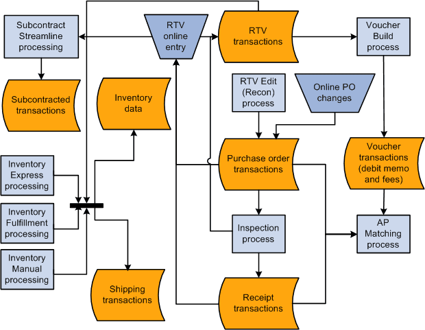

Understanding the RTV Business Process
There are a variety of business reasons for initiating a supplier return. You may receive defective materials, too many items, items shipped in error, or items that you no longer require. When you return goods or services purchased from a supplier, you enter an RTV transaction in PeopleSoft Purchasing. Typically, this RTV transaction specifies the purchase order from which the materials were acquired; however, returns can be processed in PeopleSoft Purchasing without referencing the original purchase order if this detail is no longer available.
To initiate the RTV process, identify the items being returned to the supplier by entering descriptive information such as the supplier ID and supplier RMA (return material authorization) number in the RTV component. These pages provide various selection criteria that enable you to locate the correct purchase order or receipt line and other information to process the return. An RTV transaction can impact other areas such as inventory levels, payables credits, assets, and supplier performance statistics. You can use a streamlined RTV process for inventory and subcontracting transactions.
These are the basic steps in RTV transaction processing:
If available, determine the source purchase order and receipt to associate with the RTV.
Create the RTV using the Return to Vendor page and related pages.
Ship the return to the vendor.
Close the RTV transaction using the RTV Reconciliation Application Engine process (PO_RTVRECON). This prepares the RTV for PeopleSoft Payables processing.
Run the Voucher Build Application Engine process (AP_VCHRBLD) to stage the adjustment voucher.
Create the adjustment voucher in PeopleSoft Payables.
This diagram illustrates a more detailed view of the process:

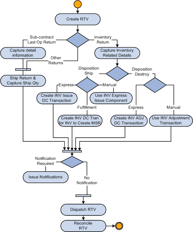

This list provides a high-level overview of how you would set up and use the RTV Streamline feature to complete a purchase order receipt inspection that requires a return to vendor. You:
Set the user preference RTV Inventory Ship Option field value to Express.
Create and dispatch a purchase order for an inventory-related line that requires an inspection.
Receive the purchase order and putaway the stock to inventory.
Open the receipt using the PeopleSoft Purchasing Inspect Receipts component, and enter the receipt quantity as the inspection quantity.
Click the RTV Setup link and complete the fields on the RTV Setup page.
Information on this page includes the RTV quantity, reason code, and rejection action.
Click the RTV Create button and the system creates the RTV.
Access the RTV using the RTV Add/Update component.
The system displays the RTV you created using the Inspect Receipts component. The Inventory Process field value is Express and the INV Status field value is Processing.
You can now dispatch the RTV and process PeopleSoft Purchasing and Inventory transactions in parallel.
The diagram illustrates the streamlined process flow for RTV goods where, based on inventory details, you can ship, destroy, or fulfill returns to vendors:
