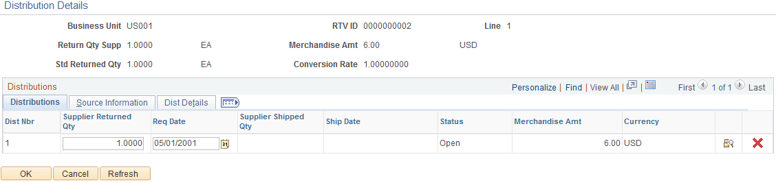

Distribution Details Page |
RTV_LN_DISTRIB |
Enter distribution information for the item that you want to return. If there is only one distribution for the selected purchase order or receipt line, the distribution is automatically selected. If you are returning a serialized item, the quantity is set to 1 and the quantity field is unavailable for entry. |

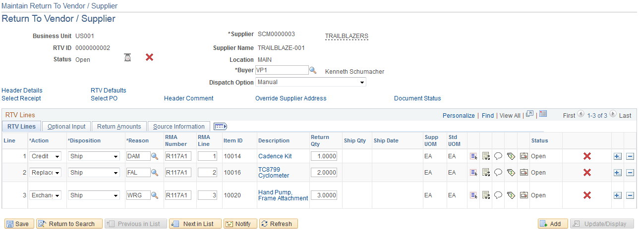

Use the Return To Vendor page (RTV) to enter RTV information.
Navigation:
This example illustrates the fields and controls on the Return to Vendor page: RTV Lines tab. You can find definitions for the fields and controls later on this page.

RTV Lines
Select the RTV Lines tab to view and update basic information for a Return To Vendor item.

Use the Return To Vendor Defaults page (RTV_DEFAUTLS) to view details regarding how the RTV adjustments are to be handled.
View the method by which the supplier is to be notified of the RTV transaction.
Navigation:
Click the RTV Defaults link on the Return to Vendor page.

Use the Override Supplier Address page (RTV_ADDR_DTL) to override the supplier's ship to address for this return.
You may want to do this if the supplier has a return address that is different than the ordering address. You can enter an address for an entirely different supplier. You may want to do this if you have ordered an item from one supplier and can exchange it with a different supplier.
Navigation:
Click the Override Supplier Address link on the Return to Vendor page.
The supplier address information on this page appears by default from the Supplier Information - Address page.

Use the Distribution Details page (RTV_LN_DISTRIB) to enter distribution information for the item that you want to return.
Navigation:
Click the RTV Details button on the Return to Vendor page.
This example illustrates the fields and controls on the Maintain Return to Vendor - Distribution Details page. You can find definitions for the fields and controls later on this page.

Distributions
Select the Distributions tab.
Field or Control |
Description |
Dist Nbr (distribution number) |
Displays the system-assigned value for this distribution line. |
Supplier Returned Qty (supplier returned quantity) |
Enter the quantity in the supplier UOM returned on the distribution line. The value in this field appears by default on the Return to Vendor page and determines the value that appears in the Amount field. Note: If the RTV is being created from a purchase order or receipt, the supplier unit of measure is the purchase order unit of measure (on the receipt it is called the supplier UOM). For RTVs without a source, the supplier UOM is the item/supplier UOM. |
Std Returned Qty (standard returned quantity) |
Enter the quantity in the standard UOM returned on the distribution line. Once you enter the returned quantity in the standard UOM, the system will calculate and enter the supplier returned quantity value for you. The system performs the UOM conversion for you. Using this field enables you to return a quantity to the supplier in a different unit of measure than was on the purchase order. For example, you place a purchase order for two cases of item 10004. In this case the supplier UOM or purchase order UOM is Cases and the standard UOM is Each. Let's say you receive that purchase order for the complete two cases and have started to use that item. Now you receive a recall from the supplier, but you only have a partial quantity left of the quantity originally ordered. You can then create an RTV and use this field (entering the quantity in the standard UOM) to return a partial quantity (10 each) of the case back to the supplier that was originally purchased. Note: This field is only available if the standard UOM is different than the supplier UOM. |
Req Date (request date) |
Select the date on which you are requesting the RTV transaction. This identifies the date on which you are requesting to have the merchandise shipped or destroyed. |
Supplier Shipped Qty (supplier shipped quantity) |
Enter the quantity in the supplier UOM shipped back to the supplier. The value in this field appears by default in the Ship Qty field on the Return to Vendor page. If the selected receipt is not a PeopleSoft Inventory receipt, the Supplier Shipped Qty and Ship Date fields are available for entry. Update these fields when the items are physically shipped back to the supplier. When the quantity in Supplier Shipped Qty equals the quantity in Return Qty Vndr and you save the page, the status of the distribution line on the supplier return changes to Shipped. If the selected receipt is a PeopleSoft Inventory receipt, the Supplier Shipped Qty and Ship Date fields are not available for entry. This information is updated when the inventory is shipped out of the PeopleSoft Inventory business unit through the Express Issue page or scrapped on the Inventory Adjustment page. |
Std Shipped Qty (standard shipped quantity) |
Enter the quantity in the standard UOM shipped back to the supplier. Once you enter the shipped quantity in the standard UOM, the system will calculate and enter the supplier shipped quantity value for you. The system performs the UOM conversion for you. Note: This field is only available if the standard UOM is different than the supplier UOM. |
Ship Date |
Date on which the RTV items were shipped to the supplier. This appears by default as the current date and is informational only. |
Status |
Displays the distribution status of the RTV transaction. Values are: Open: This status appears by default when the supplier return is initiated. Shipped: When the supplier shipped quantity value equals the return quantity supplier value and you save the page, the distribution line status changes to Shipped. Closed: The distribution line has been closed by the RTV Reconciliation process. Cancelled: The distribution line has been canceled. You can change the RTV status to Cancelled until a distribution on the RTV transaction has been shipped. |
Amount |
Displays the value of the items returned on the distribution line, along with the currency in which it is expressed. |
Click the Select Source Details button to access the Source Details Information page where you can review RTV information such as the PO and receipt order numbers. |
Click the Cancel Distribution button to cancel the selected distribution row from the RTV transaction. Canceling an RTV distribution cannot be reversed. |
