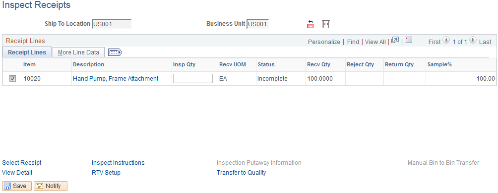

Use the Inspection page (RECV_INSPECT) to put receipt line items through the inspection process.
The Inspection Required check box must be selected for the item on the receipt line.
Navigation:
Enter search criteria on the Select Receipt page and click the Search button.
Click the Sel check box next to a receipt line and click the OK button.
This example illustrates the fields and controls on the Inspect Receipts page. You can find definitions for the fields and controls later on this page.
Field or Control |
Description |
Click the RTV Create button to create an RTV transaction, and update the Return Qty field with RTV data that you entered on the RTV Setup page. The RTV transaction is now accessible on the Return to Vendor - RTV page, where you can view and modify detailed information for the RTV transaction. |
Click the Automatic Bin to Bin Transfer button to move items from their inspection locations to their putaway locations. The transaction to move items from inspection to putaway locations is written to the electronic data collection log files, where it is picked up by a background process, enabling the move to be completed automatically. This function is available only if you are using an electronic data collection batch update process. The Auto Bin to Bin check box on the Inspection & Putaway Information page is selected for items that are available for use with this function. |
Receipt Lines
Select the Receipt Lines tab.
Field or Control |
Description |
Insp Qty (inspected quantity) |
Enter the quantity of items inspected. |
Status |
The status of the inspection process appears. Values are Complete and Incomplete. When the quantity inspected for the receipt line is equal to or greater than the Sample% of the receipt quantity (Recv Qty) the status is set to Complete. Otherwise, the status is set to Incomplete. |

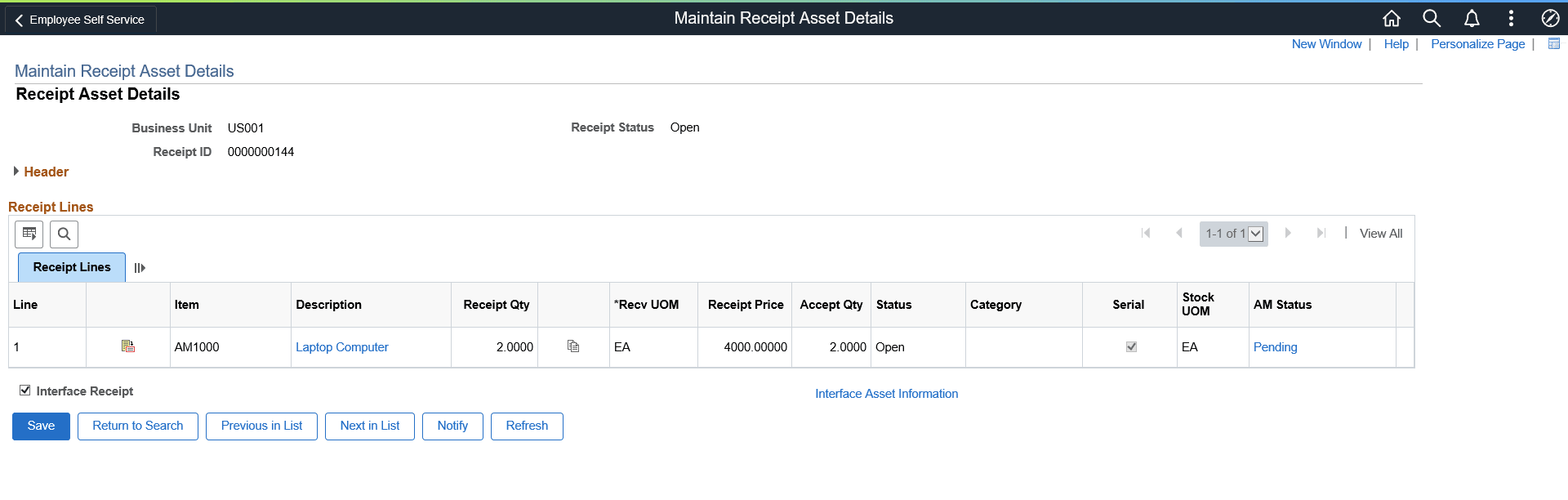

Use the Maintain Receipt Asset Details page (RECV_WPO) to view or update the asset-related information in a receipt. The page displays all the receipts, which contain asset information.
Navigation:
Or
Click the AM Status link from the Inspection page.
This example illustrates the fields and controls on the Maintain Receipt Asset Details page. You can find definitions for the fields and controls later on this page.
Field or Control |
Description |
AM Status link |
Displays the status of the item data in relation to PeopleSoft Asset Management. Values are:
If the receipt line is not asset-related, this field does not display. |
Interface Receipt |
Select this check box to automate the passing of asset information through the receiving process. If you access the Maintain Receipt Asset Details page from the inspection page, this check box does not display. |
Interface Asset Information |
Click this link to access the Pre-AM1 page, where you can preview and correct data that is being sent to PeopleSoft Asset Management. If you access the Maintain Receipt Asset Details page from the inspection page, this link does not display. |
