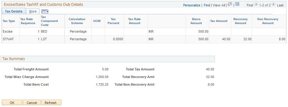

Use the Excise Duty/Sales Tax/VAT Details for Schedule page (PO_LN_SHIP_TAX_EXS) to access excise and sales tax/VAT rate codes, corresponding tax component codes, and calculated results.
Access the total excise duty amount, sales tax/VAT amount, excise duty recovery amount, and sales tax/VAT recovery amount at the schedule level.
Navigation:
Click the Excise/Sales Tax button on the Maintain Purchase Order - Schedules page.
Click the Excise/Sales Tax button on the Express Purchase Order - Purchase Order page.
This example illustrates the fields and controls on the Excise Duty/Sales Tax/VAT Details for Schedule page (1 of 2). You can find definitions for the fields and controls later on this page.
This example illustrates the fields and controls on the Excise Duty/Sales Tax/VAT Details for Schedule page (2 of 2). You can find definitions for the fields and controls later on this page.
Following purchase order excise duty and sales tax/VAT calculations, you can access tax information on the Excise Duty/Sales Tax/VAT Details for Schedule page. The system displays monetary amounts on this page in the transaction currency.
If you change the tax transaction type, the system clears the excise and sales tax/VAT rate codes and reruns the Tax Determination process to determine the tax rate code values appropriate for the new tax transaction type. The system repopulates the tax components and all related tax details to the page.
You have the option to change the values that appear in the Assessable Value and excise and sales tax/VAT rate code fields. The tax rate code value populates the transaction using the tax determination hierarchy. You can alter these values to determine the impact on the tax amount in an alternate scenario.
Note: The Assessable Value and Tax Rate Code fields are unavailable for entry when the purchase order status is Dispatched, Complete, or Canceled.
If you change any of these values, the following actions occur:
The Tax Calculation process is triggered and the recovery and nonrecovery tax amounts are recalculated and appear.
When you click the OK button, the system prorates the total excise tax amount, excise nonrecovery amount, excise recovery amount, sales tax/VAT amount, sales tax/VAT recovery amount, and sales tax/VAT nonrecovery amount in the transaction currency to the distribution and the general ledger base currency to the EXS_PO_LN_DIST table.

Excise/Sales Tax/VAT and Custom Duty Details
Field or Control |
Description |
Tax Type |
Displays the tax type associated with the tax component code on the transaction. Values are:
Tax Rate Sequence |
Indicates the order in which tax component codes in the tax rate code should be calculated. |
Tax Component Code |
Displays tax component codes in the selected tax rate code. |
Calculation Scheme |
Displays the default calculation scheme associated with the selected tax component code. Values are: Amount: Ad hoc amount-based tax calculation. Percentage: Percentage-based tax calculation. Percentage appears by default. Quantity: Quantity-based tax calculation. |
Tax Rate UOM (tax rate unit of measure) |
If the Calculation Scheme is set to Quantity,displays the unit of measure against which the tax rate amount is applied. Note: If the transaction unit of measure is different from the tax rate code unit of measure, the system performs the conversion using the PeopleSoft-delivered unit of measure conversion feature. |
Tax Rate Pct (tax rate percentage) |
If the Calculation Scheme field value is set to Percentage, displays the percentage to be applied against the taxable amount value in the Basis Amount field. |
Tax Rate Amount |
If the Calculation Scheme field value is set to Quantity, displays the amount to be applied against the transaction quantity, according to the transaction quantity in the Tax Rate UOM value. Note: If the transaction unit of measure is different from the tax rate code unit of measure, the system performs the conversion using the PeopleSoft-delivered unit of measure conversion feature. If the Calculation Scheme is set to Amount, this is the tax amount. |
Basis Amount |
Displays the base amount on which tax is calculated. |
Tax Amount |
Displays the tax amount for the tax rate sequence. |
Recovery Amount |
Displays the amount of tax that can be recovered based on the Tax Amount and Rcvry Percent values. |
Non Recovery Amount |
Displays the amount of tax that is nonrecoverable based on the Tax Amount and Tax Percentage values. |
Tax Percent |
Displays the tax percentage. The system uses this value to split taxes into recoverable and nonrecoverable components. If the Tax Type field value is set to Excise, this is the CENVAT percentage that can be recovered. For example, a field value of 100 indicates that the full amount of tax is eligible for CENVAT credit. If the Tax Type field value is set to ST/VAT, this is the set-off percentage for the tax rate code. For example, a field value of 60 indicates that 60 percent of the tax amount is recoverable and eligible for setoff. The balance is added to the inventory cost or expensed depending on the treatment defined for the item. |
Tax Dependency Code |
Displays the tax dependency code assigned to the tax rate code. Tax dependency codes indicate the basis for calculating tax, as well as the precedence of taxes of the same tax type that must be included. |
Include Base |
If this check box is selected, indicates the inclusion of the base value in the tax calculation. If this check box is clear, the base value is excluded from the tax calculation. For example, this check box may be clear for a surcharge tax component, which is calculated based on a preceding tax component rather than on a base value. However, this check box would generally be selected for basic excise duties and local sales taxes. |
Include Freight |
If this check box is selected, indicates the inclusion of freight as a part of the base value in tax calculation. |
Include Miscellaneous Charges |
If this check box is selected, indicates the inclusion of miscellaneous charge expenses as a part of the base value for tax calculation. |
Tax Summary
Field or Control |
Description |
Total Freight Amount |
Displays the total freight charge amount for the schedule. |
Total Misc Charge Amount (total miscellaneous charge amount) |
Displays the total miscellaneous charge amount for the schedule. |
Total Item Cost |
Displays the total cost of items on the schedule. This value includes the merchandise amount, total freight amount, total miscellaneous charge amount, and total nonrecoverable tax amount. |
Total Tax Amount |
Displays the total tax amount on the schedule. |
Total Recovery Amt (total recovery amount) |
Displays the total recoverable tax amount on the schedule. |
Total Non-Recovery Amt (total non-recovery amount) |
Displays the total nonrecoverable tax amount on the schedule. |
