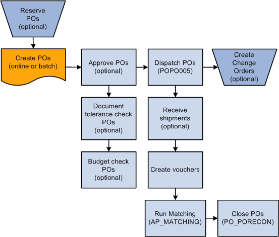

Here is the basic flow of purchase orders in PeopleSoft Purchasing:
(Optional) Reserve a purchase order for future use on the Purchase Order Reservations page.
Create the purchase order through one of these methods:
Directly online.
You can create purchase orders online using the Maintain Purchase Order - Purchase Order page or the Express Purchase Order - Purchase Order page.
Purchase order sourcing processes.
Using the PO Calculations process (PO_POCALC) and the Create Purchase Order process (PO_POCREATE), purchase orders can be created from multiple sources: through requisition selection, as a contract release, as an RFQ award, or from sources external to PeopleSoft Purchasing, such as from PeopleSoft Supply Planning, PeopleSoft Strategic Sourcing (strategic sourcing event), or PeopleSoft Order Management (sales order).
When you manually create a purchase order, you can set up the system to automatically select the most appropriate contract to which to source the purchase order requisitions. During the process, the system searches for contracts to use on purchase orders, reducing the need for organizations to know the contract at the time of requisitioning. Requesters can ensure that the correct contract is selected and can override the contract.
Also, you can create a contract using a purchase order as the source transaction. This provides you the capability to make a contract available to automatically supply a purchasing requisition and purchase order transaction.
Approve purchase order amounts and ChartFields on the purchase order approval pages (may be optional depending on the business practices).
Dispatch the purchase orders from the Purchase Order Dispatch/Print process (POPO005) or the Buyer's Workbench.
(Optional) Create change orders using the Maintain Purchase Order - Purchase Order page or batch change order processes.
Receive shipments (optional, except for purchase order lines that are set up to require receiving).
Create purchase order vouchers.
(Optional) Run the Matching process (AP_MATCH).
Reconcile and close the purchase orders using the Close Purchase Orders process (PO_PORECON).
This diagram illustrates the purchase order business process flow:
