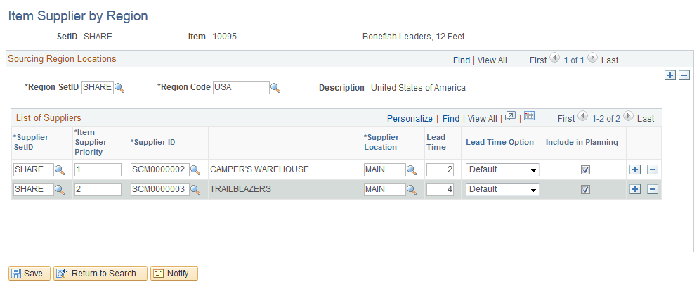

Use the Item Supplier by Region page (ITM_REGION_VNDR) to define supplier priority and supplier location by region.
Navigation:
This example illustrates the fields and controls on the Item Supplier by Region. You can find definitions for the fields and controls later on this page.
Field or Control |
Description |
Region Code |
Select a region code to associate with this regional supplier. |
Item Supplier Priority |
Enter the priority order for which a supplier will be selected for regional sourcing. |
Supplier ID |
Select the supplier that you want to associate with this supplier region. |
Supplier Location |
Select the location for the supplier. |
Lead Time |
Enter the lead time that you want purchase order sourcing to use in determining the purchase order lead time. Item region is level two in the defaulting hierarchy after the item ship to supplier level. If you don't use this value, purchase order sourcing checks at level three in the defaulting hierarchy (Item/Supplier attributes). |
Lead Time Option |
Select the option that you want to use along with the lead time value. Select Default to use the next level lead time. Select Use to use the lead time defined at this level. |
Include in Planning |
Select to enable purchase options to be created in PeopleSoft Supply Planning for the PeopleSoft Inventory business unit related to this item supplier. The purchase option then enables the creation of new purchase orders through PeopleSoft Supply Planning for this PeopleSoft Inventory business unit. |
To use the regional hierarchy as part of the background sourcing process, you must select the Override Suggested Supplier check box on the Maintain Requisitions - Requisition page under the Sourcing Controls tab. If this check box is clear, the system uses the supplier provided on the transaction. The regional sourcing hierarchy is used only when you select the basic sourcing method.
