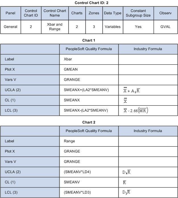

PeopleSoft provides you with seven industry-standard control charts. These charts are time-series charts for monitoring and controlling processes or equipment. Each control chart has a unique chart ID that represents a different display format.
Using the Control Chart component, you can define custom charts to reflect special control requirements or labeling conventions. The charts are based on industry-standard control charts and are applicable to a specific data type.
Note: Chart IDs 1 through 7 are supplied as industry-standard system defaults.

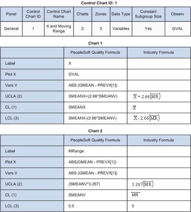

1 |
X and Moving Range. |
Variables |
2 |
Xbar and Range. |
Variables |

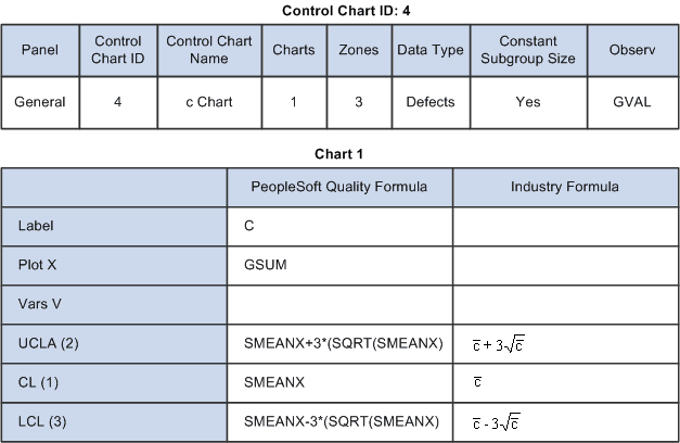

4 |
c Chart. |
Defects |

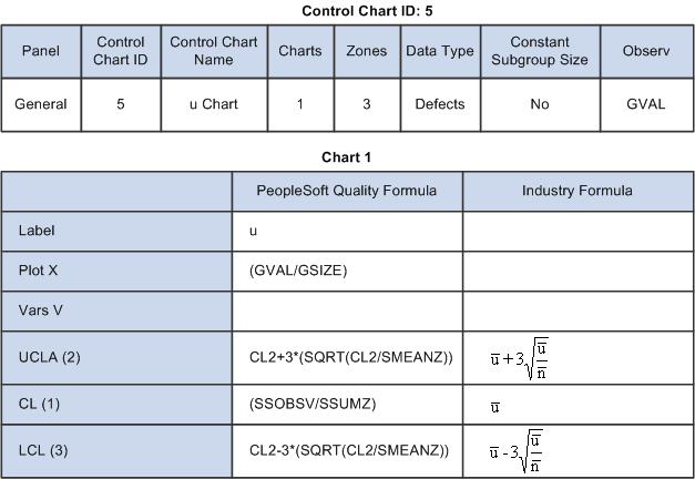

5 |
u Chart. |
Defects |

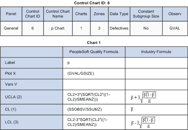

6 |
p Chart. |
Defectives |

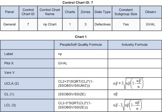

7 |
np Chart. |
Defectives |

Control Chart ID: 1
This graphic shows Control Chart ID 1
Control Chart ID: 2
This graphic displays Control Chart ID 2

Control Chart ID: 4
This graphic displays Control Chart ID 4
Control Chart ID: 5
This graphic displays Control Chart ID 5
Control Chart ID: 6
This graphic displays Control Chart ID 6
Control Chart ID: 7
This graphic displays Control Chart ID 7
