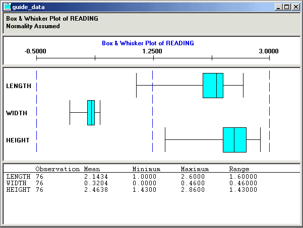

This example illustrates the fields and controls on the Box Plots panel. You can find definitions for the fields and controls later on this page.
The box plots display is comprised of multiple graph panes (sections), with each section displaying information about the subset that you are examining. Box plots are also referred to as Box and Whisker plots, because of the vertical whisker lines at each end of the horizontal scale.

Title Section
This section includes a heading that indicates the plot type, the data column used as the basis for generating the box plots, and normality criteria for the calculations used to generate the box plots. In the previous illustration, the plot type is Box and Whisker, the data column is Reading, and the normality criteria is Pearson Best Fit.
The graph preference that you select on the Selector panel determines the normality criteria.
Scale Section
This section displays the name of the data column that you are analyzing and a scale, which exhibits the box plot's limits. In the previous illustration, the data column is Reading and the graph type is Box and Whisker.
Note: By default, the system calculates the scale based on the minimum/maximum values of the data to be graphed.
Chart Section
Section contents vary depending on the graph style.
The Box and Whisker chart section contains Box and Whisker displays. The ends of the whisker lines represent the minimum and maximum values, the left and right edges of the boxes represent the first quartile and third quartile values, and the centerlines represent the median value.
The individual boxes correspond to either the subsets that you selected or the data groupings established with the group by column role assignment on the Selector panel.

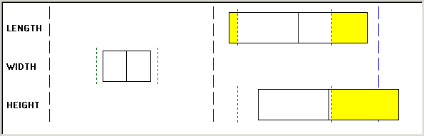

A capability graph appears in this section:
This image displays the capability graph.
The left and right edges of the capability graph box represent the plus and minus 3 sigma values, and the centerline represents the mean value. In addition, green dashed lines represent the lower-and upper-specification limits, while yellow parts represent the areas out of specification based upon the distribution fitting (Normality, Pearson Best Fit) criteria in effect.
Individual boxes correspond to either the subsets that you selected or the data groupings established with the group by column role assignment on the Selector panel.

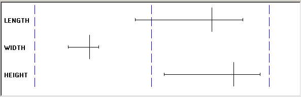

A min/max graph appears in the following section:
This image displays the min/max graph.
The left and right endpoints represent minimum and maximum values, and the centerline represents the mean.
Detail Section
This section of box plots includes the collective summary statistics for all box plots on the display. If you select an individual box plot, then the summary statistics for that individual box plot appear.

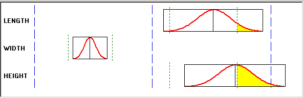

An example of a box plot with distribution curves overlaid appears in the following section:
This image displays the overlaying distribution curves.
Note: The system calculates the distribution curve according to the normality/curve fitting criteria in effect by the graph preference ID that you selected.
