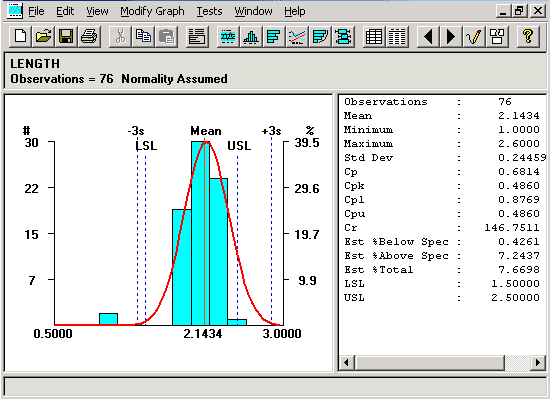

Use the Histogram panel to display the distribution analysis.
Navigation:
Click the Histogram button.
This example illustrates the fields and controls on the Histogram pane. You can find definitions for the fields and controls later on this page.
The histogram display comprises multiple panes (sections) that display information about a subset. To resize a section:
Place the cursor on the thick bar between the sections.
Drag the edge of the section to the new size.
Click a cell and it becomes crosshatched to highlight it. When you click the Redraw button, the histogram is redrawn with the crosshatched cells removed. This is useful to examine a smaller portion of the data. By deleting cells, you can temporarily exclude the data values associated with that cell and recalculate the histogram and statistics.
To select a cell, drag the cursor across the vertical bar. The cell is highlighted in yellow. You can see the details of the selected cell in the detail section of the histogram.
Note: Cell values excluded from the graph are local to the active window; the dataset is not altered.

Chart Section
The section of the histogram displays the main body of the graph, with the following conditions:
(Optional) Specifications and +/- 3 sigma regions appear as dashed lines.
A thin, red, vertical line indicates the mean point.
The histogram is scaled by frequency on the left and by percent on the right.
(Optional) The distribution curve (indicated by a thick, red, curved line) overlays the chart.
List Section
This section displays summary statistics. You can change the statistics by changing graph preference settings. The statistics are calculated based upon the active data values for this subset.
Detail Section
This section is blank, unless you select a vertical bar (cell), in which case it displays detailed cell information. To select a cell, drag the cursor over the vertical bar, and it is highlighted in yellow.

Use the Histogram Options dialog box to select options to modify the settings and display characteristics for histograms.
Navigation:
Open a histogram.
You can modify the histogram by resizing the sections to adjust the amount of display information in each section of the graph. You can choose whether to display the overlay curve, the overlay specifications, or to overlay a box plot. You can change the number of cells displayed and the upper and lower specification limits.
Note: Any changes you make to the histogram are in effect only for the active chart. If you open a second histogram window, the changes are not in effect.
