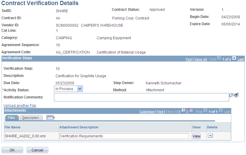

Use the Contract Verification Details page (CS_CNT_VFY_SEC) to verify details about verification steps for a contract agreement
Navigation:
Click the Contract Step Verification link on the Update Agreement Statuses page or the Review Agreement Statuses page.
You can also access this page using the Monitor Contract Compliance component.
This example illustrates the fields and controls on the Contract Verification Details page.
Use this page to update the status of the verifications steps on a contract agreement. Verification steps are a checklist of tasks to be completed before the system considers the agreement as compliant. You assign each step to an owner and the owner can update the step information directly or pass the information to the contract administrator who can perform the updates on behalf of the owner. As part of the update process, you can also upload attachments.
As with other pages in this component, information that appears on the page depends on whether you are viewing a line, header, or category line agreement. If attachments exist with the agreement, the Attachments grid appears when you open the Contract Verification Details page. If attachments do not exist, use the Upload a File link to add them and access the grid. Contract information appears at the top of the page and if the steps are associated with a line or category line agreement, the system displays additional line information.
Note: Supplier-side (external) users cannot change the agreement status. Agreement information is display-only for external users, but they can update verification steps. If you have enabled supply-side access to the system, there is a separate page provided for supplier users to access and update only those verification steps (deliverables) to which they have update authority.
The system validates when a verification step is tied to an external owner, and issues a warning when you change the agreement status to Compliant or Not Compliant and the verification status for the step is set to Not Started or In Process. If you change the verification step status and the verification step if owned by an external owner, the system also issues a warning.
See Reviewing and Collaborating on External Documents.

Use the Contract Verification Details page (CS_CNT_VFY_SEC) to verify agreement verification steps.
Navigation:
Click the Contract Step Verification link on the Update Agreement Statuses page or the Review Agreement Statuses.
Use the Attachments section to add documents associated with the verification step. The grid appears after you upload at least one attachment. If an attachment already exists, the grid appears when you open the Contract Verification Details page for a line or header agreement.
See Installation Options - Multiple Attachments Page to define the maximum attachment upload limit for various products.
You can use attachments as a means of capturing additional information about the agreement or task. Also, an attachment might be required as a verification method. For example, you may require a copy of the supplier's license or certifications, which can be attached using this page. You can attach documents even when the verification method is not Attachment.
You can upload and view a variety of documents, including Microsoft Word and Adobe Reader documents, as well as Microsoft Excel, PowerPoint, and Access files. Attachments are read only files. You can edit these files and load them again to make changes. They are not managed through the document authoring system
