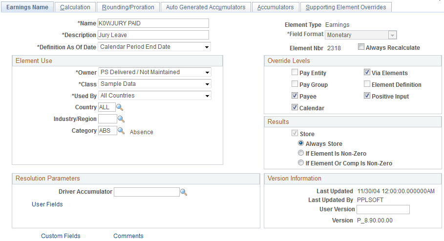

Use the Earnings Name page (GP_PIN) to name the element and define its basic parameters.
Navigation:
This example illustrates the fields and controls on the Earnings Name page.
Note: You name every element and define its basic parameters on an Element Name page. All element components within Absence Management share the same first Element Name page (GP_PIN). However, the Earnings Name page contains the following additional fields that apply only to earnings.
Field or Control |
Description |
Driver Accumulator |
This field applies only to Global Payroll. |
User Fields |
This link applies only to Global Payroll. |
Note: For information on the remaining fields on the Earnings Name page, see Defining Element Names.

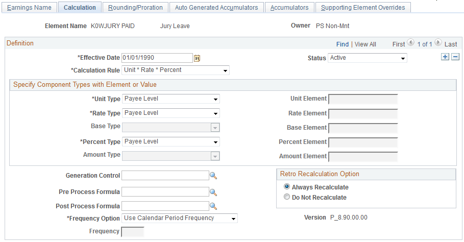

Use the Calculation page (GP_ERN_DED_CALC) to define calculation rules for an earning element.
Navigation:
This example illustrates the fields and controls on the Earnings - Calculation page.
Field or Control |
Description |
Calculation Rule |
Define the calculation rule for the element. Valid values are Amount, Base x Percent, Unit x Rate, and Unit x Rate x Percent. Your selection affects the availability of other fields. When you process absence events, the system can generate units for the earning elements, which you can transmit to your payroll system. If you integrate Absence Management with Payroll for North America or Payroll Interface, select a calculation rule that includes units. Unit x Rate x Percent is recommended because it enables you to send both rate and percent information to your payroll system. Once you define a calculation rule for an element, you cannot change the rule after output results are generated for the element. If you need to change the element definition, create a new element. |
Unit Type, Rate Type, Base Type, Percent Type, and Amount Type |
The fields that you can update here depend on the selected calculation rule. Select Payee Level for each applicable component. Note: In Global Payroll, these fields tell the system how to determine the component values or amount. In Absence Management, you use the Absence Take - Day Formula page (when you link the earning element to a take element) to tell the system how to determine the component values or amount. |
Unit Element, Rate Element, Base Element, Percent Element, Amount Element, Amount Value and Amount Currency |
These fields are not available when you select Payee as the component type. |
Generation Control |
Pre Process Formula and Post Process Formula |
These fields apply only to Global Payroll. |
Frequency Option and Frequency |
Retro Recalculation Option |
Specify whether to recalculate an element during retroactive processing. Values are: Always Recalculate Do Not Recalculate If you select Always Recalculate here, the element is recalculated during processing the element in a retroactive situation. Note: You can override this field on the Retro Process Overrides page. |

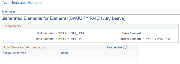

Use the Earnings - Generated Elements for Element <name> page (GP_AUTOGEN_SEC) to displays the system-generated components and accumulators that have been created for an earning element.
Navigation:
Click the View Generated Elements link.
This example illustrates the fields and controls on the Earnings - Generated Elements for Element <name> page.
Field or Control |
Description |
Components |
Displays the automatically generated element for each component of the earning element. |
Auto Generated Accumulators |
Displays automatically generated accumulators. |
