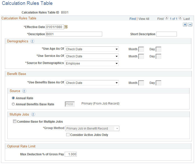

Use the Calculation Rules Table page (CALC_RULES_TABLE) to define calculation rules by specifying salary, age, and service as of dates, as well as coverage, calculation, and rounding options for the rule.
Navigation:
This example illustrates the fields and controls on the Calculation Rules Table page. You can find definitions for the fields and controls later on this page.
Field or Control |
Description |
Effective Date |
Must be the same as or prior to the effective dates of the one or more benefit program and benefit plan combinations that you associate the calculation rules with. |
Demographics
Field or Control |
Description |
Use Age As Of |
Used to calculate rates for life plans that you associate with age-graded rates. |
Use Service As Of |
Used to calculate rates for plans that you base on months of service. |
Source for Demographics |
Designate whose personal information to use. Values are:.
If the system cannot locate a birth date for a dependent or spouse, it generates a warning that a birth date was not located and uses the employee's age instead, while still retaining the dependent's sex and smoker status. |
Benefit Base
Field or Control |
Description |
Use Benefits Base As Of |
Enter the date to use when retrieving the employee's salary if the system needs to use an employee's salary to determine a rate (for example, a compensation-banded rate table or a percent-of-salary rate table). |
Source
Field or Control |
Description |
Annual Rate |
Select to make calculations using the regular compensation base entered on the Job Data - Compensation page. |
Annual Benefits Base Rate |
Select to make calculations using an annual benefit base rate (ABBR.) The ABBR selected can be either the primary ABBR found on the Job Data - Benefit Program Participation page or any alternate ABBR from the ABBR Update page. Note: Set a maximum benefits base rate by assigning each employee an ABBR that is not higher than the desired maximum. Note: For federal users, ABBR corresponds to the Total Pay field on the Expected Pay page of the PAR Compensation Data component. |
Multiple Jobs
Field or Control |
Description |
Combine Base for Multiple Jobs |
Select if you want to aggregate salary from multiple jobs as a basis for a rate determination. Selecting this rule activates the Group Method options. |
Group Method |
If you selected Combine Base for Multi Jobs, select the group method to use for selecting jobs to contribute to the total benefit base. Choose from:
Consider Active Jobs Only |
If you selected Combine Salary for Multi Jobs, select this option to have the system look only at jobs with a status of Active in the Job Data components. |
Optional Rate Limit
Field or Control |
Description |
Max Deduction % of Gross Pay (maximum deduction percentage of gross pay) |
If you have employees in Hawaii, state laws mandate that employers charge no more than 1.5% of gross wages for employee-only coverage. Use this field to establish a calculation rule with the maximum deduction percent of gross pay set to a value of 1.5 or lower. This rule will be attached to the cost row of the benefit plan coverage code associated with employee-only coverage. This deduction calculation is performed when:
The maximum deduction percent of gross pay calculation looks like this: Deduction = (Max Percent
of Gross Pay) × (Federal Taxable Gross Pay) ÷ 100.
The smaller deduction appears on the paycheck. |
